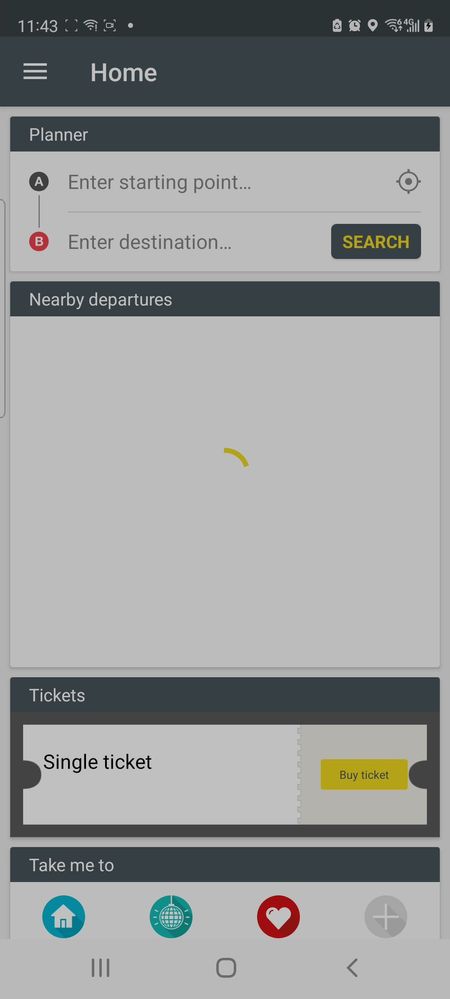

The problem is, frequent long loading,
  • Video call, mobile call via WIFI disconnected every 2 minutes. my friends complain my network is too bad to see and hear me.
  • online game is not possible
  • Twitter doesn't show images and videos, loading takes around 20 seconds, happens every 5-10 mins,
  • Google Translate slow response(20 seconds), especially for real-time translate
  • Netfilx on TV is loading sometimes, TV use LAN/cable, video works better as it is not real-time service, but if I use mobile data or neighbor's wifi -> no latency
The above problems happen on all my devices/phones. disappear when I change to mobile data or neighbor's WIFI.

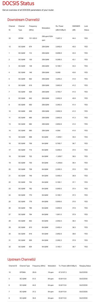

  • Also upload a screenshot of the signal values . You can find this in the user interface of your cable router via  192.168.0.1 or via 192.168.178.1 on the Fritzbox.
cable signalcable signaldevice signaldevice signal

BVGBVGgamegameTwitterTwitterwhatsappwhatsapp
