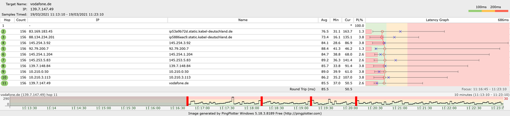

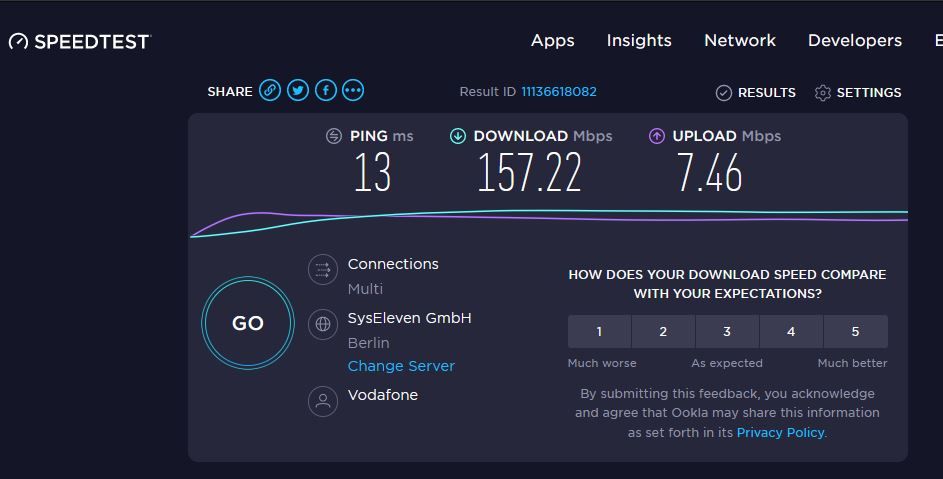

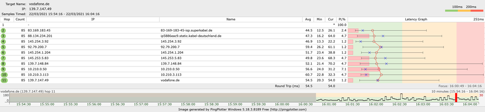

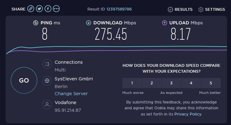

i have had speed problems for a long time, and recently packet loss problems (see OP). a Techniker came to my apartment and changed router, and the speed is a little better (but still bad: 10mbps -> 200mbps) but the packet loss problem is much worse.
here are some pingplotter charts to show (from 1 week on different days to different hosts):
the problem is all across the day to any server at all from my apartment. there is no point where there is 0% packet loss. you can see also that this includes to vodafone de website directly.
can anyone assist with this? the internet is unusable except to read documents online, as constant stuttering and quality failure means streaming is impossible.

bonus: speedtest with "improved" speed. this is a "normal" result when i run the test at any time of day.

What interval was set on the ping plotter?

the pingplotter interval is the default: 2.5s. i am opening ping plotter, putting an IP address in, and letting it run for 10 minutes or more.
also, online games tell me i have packet loss with the same numbers as you can see in the images.
i also have some pingplotter result files saved to my computer if they are necessary.

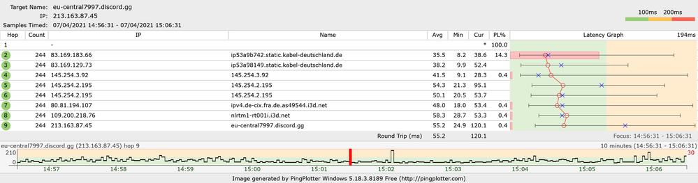

hello. another short update.
here's 3 more pingplotter graphs from today. it looks like this most days at any time. its mostly the first 2 hops to KD nodes that cause problems.
202104071506_eu-central7997.discord.gg.png202104071525_ec2-18-184-159-210.eu-central-1.compute.amazonaws.com.png202104071541_vodafone.de.png
thanks
Highlighted
Claudia
Hello neilltim,
which interval did you choose for the pingplotter measures? If the last hop shows no or an insignificant error the packetloss on the route can be disregarded.
Kind regards,
Claudia

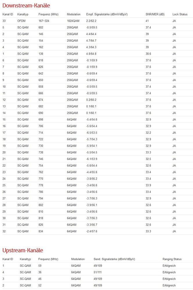

Nachricht enthält einen Hyperlink Nachricht enthält ein Bild
Hello,
your level values in the download are too low, and too high in the upload. The reason for this could be:
House connection amplifier (Settings)
Coaxial cable (low Quality, too long, damaged)
Junction box in the wall (level damping too high)
