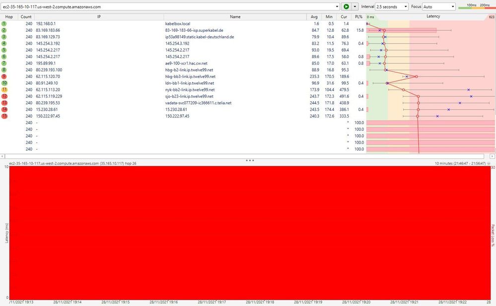

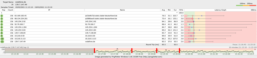

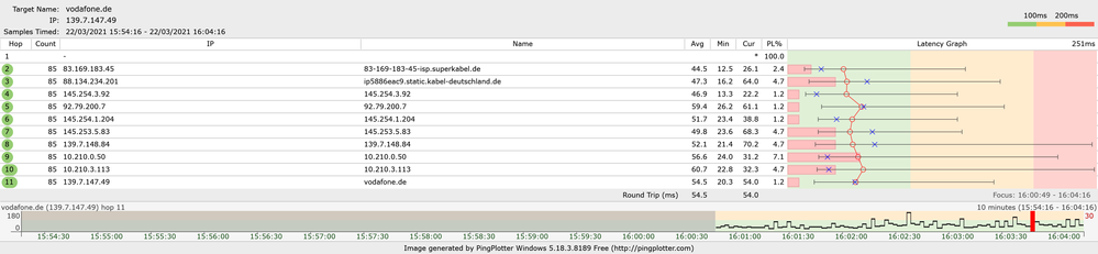

i have had speed problems for a long time, and recently packet loss problems (see OP). a Techniker came to my apartment and changed router, and the speed is a little better (but still bad: 10mbps -> 200mbps) but the packet loss problem is much worse.
here are some pingplotter charts to show (from 1 week on different days to different hosts):
the problem is all across the day to any server at all from my apartment. there is no point where there is 0% packet loss. you can see also that this includes to vodafone de website directly.
can anyone assist with this? the internet is unusable except to read documents online, as constant stuttering and quality failure means streaming is impossible.

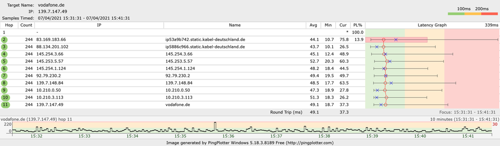

am 07.04.2021 15:43

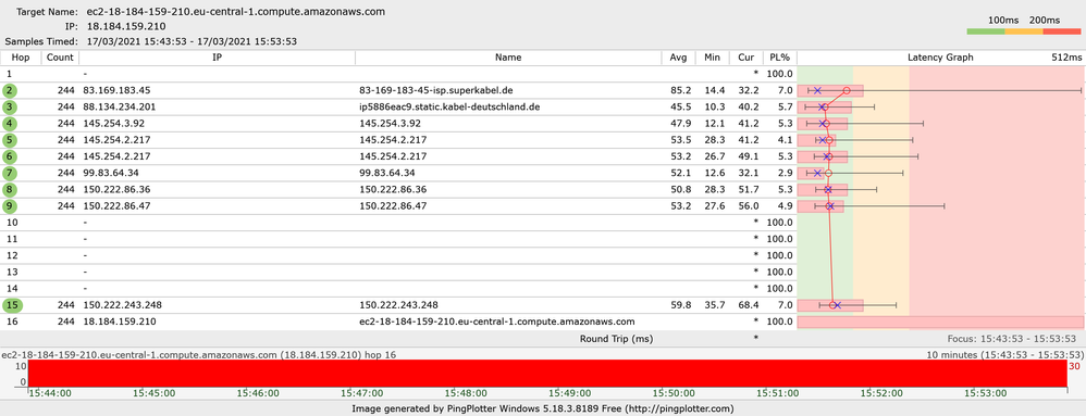

hello. another short update.
here's 3 more pingplotter graphs from today. it looks like this most days at any time. its mostly the first 2 hops to KD nodes that cause problems.
thanks
am 09.04.2021 13:46
Hello neilltim,
which interval did you choose for the pingplotter measures? If the last hop shows no or an insignificant error the packetloss on the route can be disregarded.
Kind regards,
Claudia

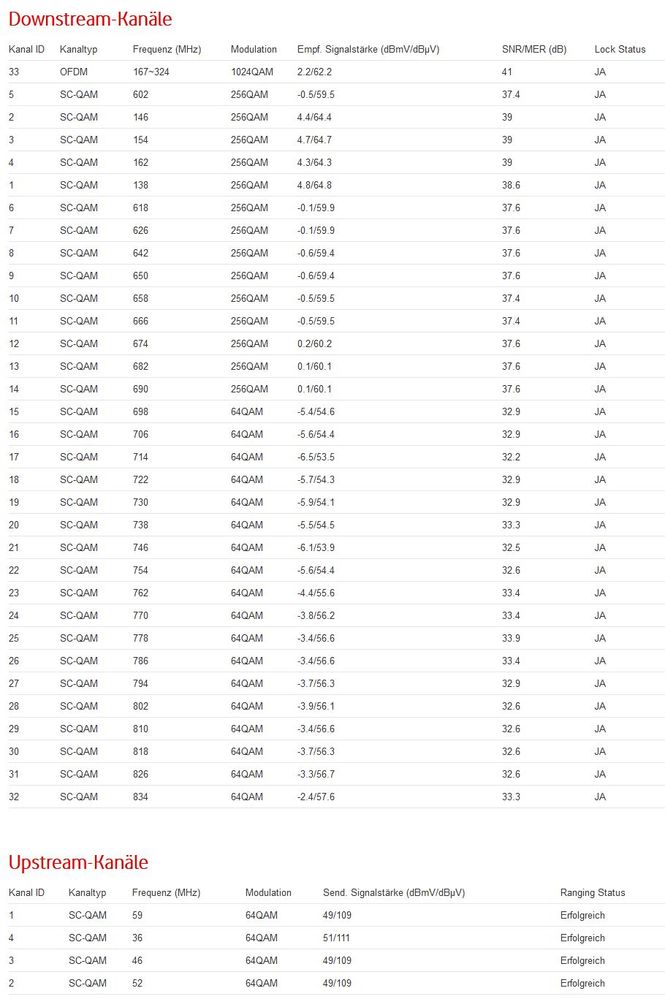

attached is some random relevant data.
am 13.12.2021 22:59
Hello,

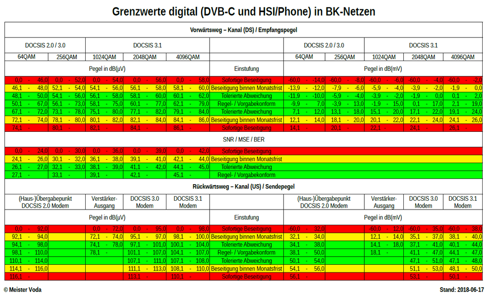

your level values in the download are too low, and too high in the upload. The reason for this could be:
House connection amplifier (Settings)
Coaxial cable (low Quality, too long, damaged)
Junction box in the wall (level damping too high)
https://www.astro-kom.de/de/produkte/85/anschlussdosen-de#posResults
