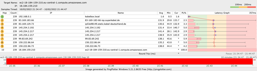

i have had speed problems for a long time, and recently packet loss problems (see OP). a Techniker came to my apartment and changed router, and the speed is a little better (but still bad: 10mbps -> 200mbps) but the packet loss problem is much worse.
here are some pingplotter charts to show (from 1 week on different days to different hosts):
the problem is all across the day to any server at all from my apartment. there is no point where there is 0% packet loss. you can see also that this includes to vodafone de website directly.
