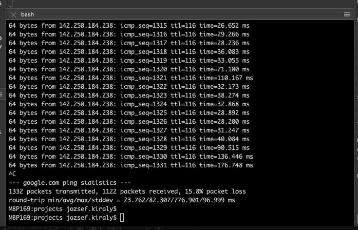

Hi again.
Unfortunately today I started experiencing huge packet losses. I just can't continue to work from home with this quality of service. This connectivity problems literally ruining my life.
Claudia
Hello jkiraly98,
please make a Pingplottere measure so we can see where on the route the packetloss happens. Please use a direct ethernet connection and an Intervall of 2.5 seconds. Are all websites affected?
