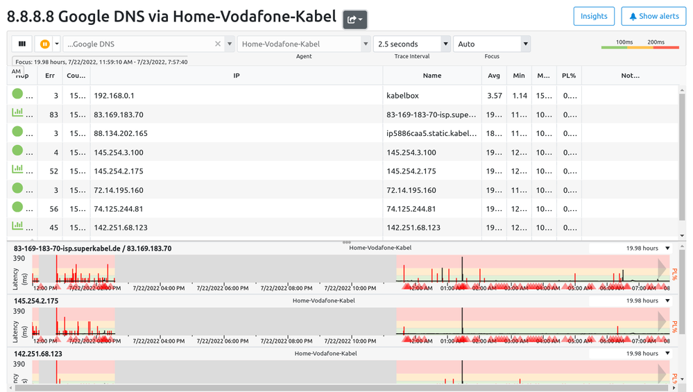

it is very unfortunate that there is problem again. Can you please note the exact day and times when this happens? Also, can you do a ping plotter measurement? PingPlotter is a software that graphically displays packet loss and ping problems at the various network nodes. Send me a picture of the result.

ajesh
Hi Tina,
Here is the first set of screenshots.
I will continue monitoring and uploading the screenshots for the next two days too.
Thanks
Ajesh
ajesh
Ping plotter - screenshot
ajesh
@Tina Please find the screenshots attached

Unfortunately I don't see all values complete. I need all hops and all measurement results.

ajesh
Hi Tina,
I don't understand what values you're interested in and what is missing in my screenshots. So I guess, it would be better to share the PingPlotter cloud with you.
Unfortunately, my pingPlotter could trial ended today. From today onwards, I will be charged USD60 per month. I don't want to spend extra money on this.
If you have a PingPlotter cloud account and share a key with me, I can send the readings directly to your pingPlotter cloud account.
Let me know if that works for you.
