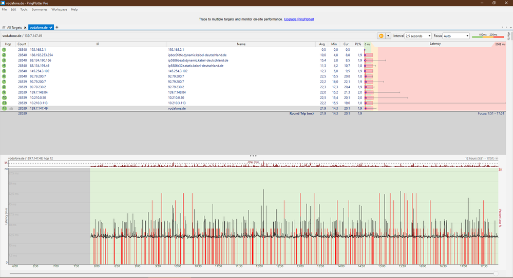

Once I had the thought that packet loss could be the reason for the issues (a week and a half ago) I started running pingplotter tests.
Reading around these forums I stumbled upon a thread in which it was mentioned that to fix high packet loss, one should contact tech support and request that the connection be set to IPv4. I did this, and it helped a bit (packet loss used to be around 5,5% and now it's "only" around 1,6%), but it didn't fix it completely.
Yesterday I called tech support again to ask what could be done about this. At this point I must admit my German is OK, but not good enough to discuss tech over the phone. The lady on the line basically told me to wait an hour and power cycle my Vodafone modem. The internet connection went down for several minutes, so I assume she remotely triggered something like a software update, but I am not sure. I power cycled the modem as instructed, but the issue remains unchanged.
I am losing my mind here. How on earth can I fix this??? There has to be a way, otherwise I 100% must find an alternative internet service. Even DSL would be better, what use is it to have high speeds if the connection is super unstable?
Here are a few pingplotter results:
before switching to IPv4:12h.png
after:
here's a longer one I ran today:
(I have no idea what caused that big red patch at the end, the internet just went down for about 70 seconds, randomly)
I still have the test running as I type this. Packet loss at the final hop is at 2% right now.
To be very clear: all those times when packet loss happens, we clearly notice it, I don't think this a case of "servers ignoring ICMP"

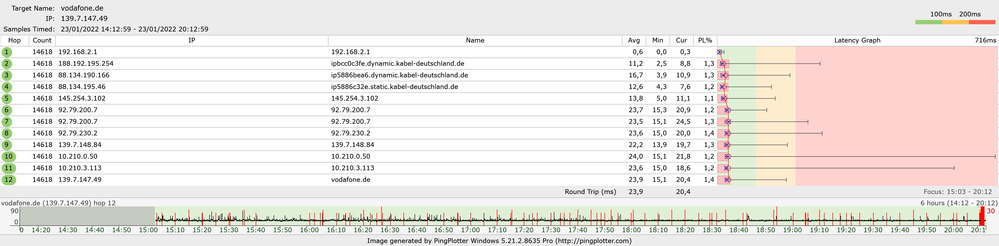

I turned bridge mode off Sunday evening. Yesterday I ran a pingplotter for several hours, there is less packet loss but it's still there. I was planning on posting it here yesterday but I had no time, so I'm posting it now.
Bridge mode OFF:
I can't run a long pingplotter with bridge mode on, since that would involve having the internet be unreliable all day and there are people doing home-office work that involves frequent important video-meetings. However, the last two pingplotter tests on my initial post are adequate examples, since I haven't made any other changes to my network since then other than turning bridge mode off.
So, here they are again, bridge mode ON:vodafone.de.png
All of these were taken using the default 2,5 second setting.

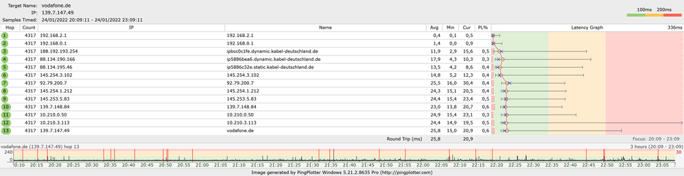

Today no one did home-office so I turned bridge mode on and ran a ping plotter all day, here it is:
Bridge mode ON
Can the technician fix that as well? I want to be able to use bridge mode.
