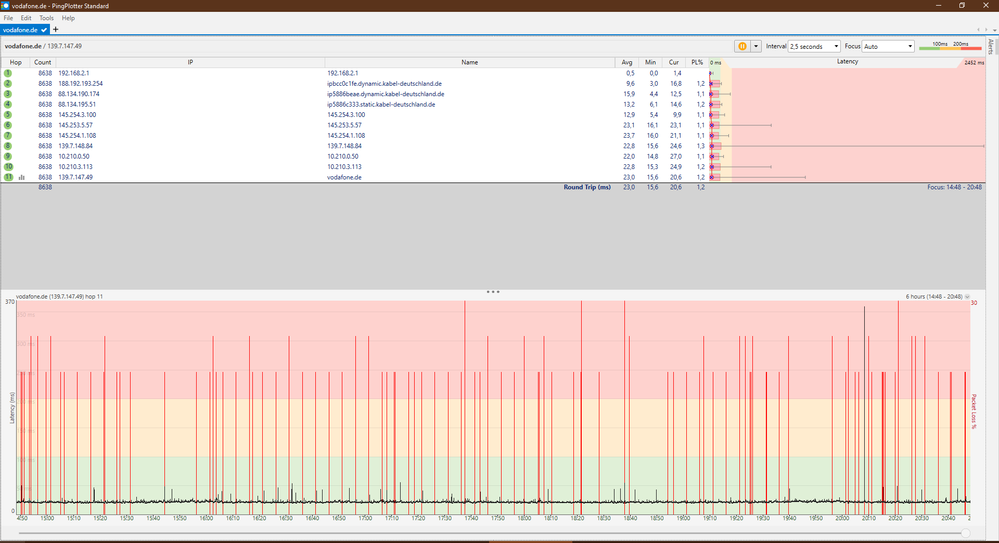

Once I had the thought that packet loss could be the reason for the issues (a week and a half ago) I started running pingplotter tests.
Reading around these forums I stumbled upon a thread in which it was mentioned that to fix high packet loss, one should contact tech support and request that the connection be set to IPv4. I did this, and it helped a bit (packet loss used to be around 5,5% and now it's "only" around 1,6%), but it didn't fix it completely.

Here are a few pingplotter results:
before switching to IPv4:12h.png
after:
here's a longer one I ran today:
(I have no idea what caused that big red patch at the end, the internet just went down for about 70 seconds, randomly)
I still have the test running as I type this. Packet loss at the final hop is at 2% right now.
To be very clear: all those times when packet loss happens, we clearly notice it, I don't think this a case of "servers ignoring ICMP"

Allright, so it's been almost a month. Here's an update on the current situation:
Clearly some work is being done about firmware in the background. Halfway through March the firmware version on my device changed from "3.0.41-IMS-KDG" to "factory-nvram-generic-brcm93390wvg-20210902023734" for a little while, then it was changed back.
Last week I ran a pingplotter test.
Bridge mode OFF:
Bridge mode ON:
The packet loss is still much higher with bridge mode on. I guess they are still working on the firmware, which is understandable.
However, the packet loss with bridge mode off increased again.
At this point I consider that I gave the technical support service plenty of time to try and figure this out. After months of communication and four separate technician visits, the signal quality issues continue to cause packet loss regardless of bridge mode.
I have initiated a contract for DSL internet service and will soon terminate my cable internet service. Speed is useless if the connection is not rock solid.
Thank you for your time, you may close the thread.

P.S.: I took a look at the connection out of curiosity (I have Pingplotter always running anyway) and no, it's not solved. In fact the packet loss is slightly higher as you can see:
Mehr anzeigen
Bridge mode OFF
Wallace
Hi GuiMR,
there is currently still a return path glitch and our technicians are already in the process of removing it. You will receive a text message from us when our colleagues have been successful.
