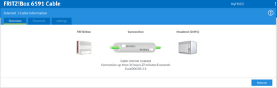

Modem is connected but only shows 64kbs connection, probably because I cancelled the 6591 option and was about to ship it back. I do not have another loaner device.
Please check the line ASAP so I can switch back to my modem.

I only have the 6591 modem from Vodafone and it is currently connected so you can check the line data.
I do have to return this modem in 7 days because I cancelled the 6591 option. If you could have someone send me another loaner modem for troubleshooting it would be great.
Here are the screenshots of the channel info and the connection showing 64kb/s.
Thanks!

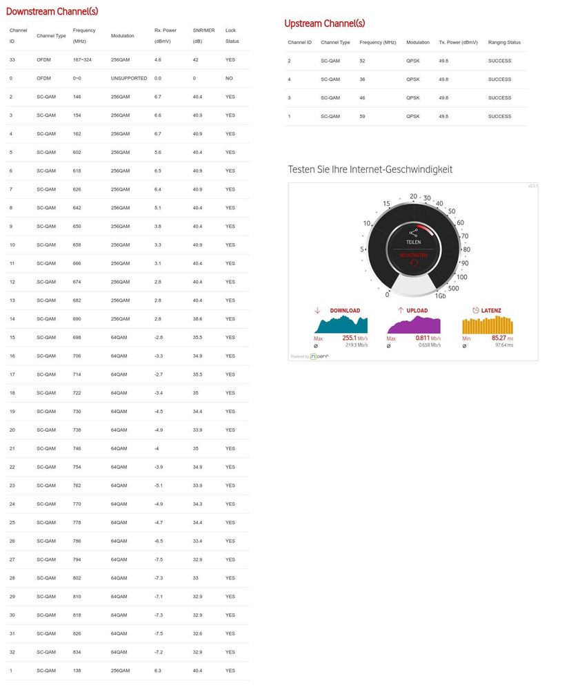

Upstream channels are now only QPSK, not even 4 QAM, speed test is down to 18/0.5 mb/s.
I've attached screenshots of the signal levels and speed test, along with the daily and weekly ping and packet drop graphs from my router showing things progresively going worse starting beginning of week 10. Today was marginally better than the worst day ever which was yesterday. Keep in mind that before that, for almost 2 years I have had an average 15ms latency and full upstream and downstream (1050/55 mb/s) at pretty much all times.

Martin59
Hi wealas,
there is still an interfering signal active, which leads to the impairments.
The colleagues are still working on the interference suppression.
Best regards, Martin
