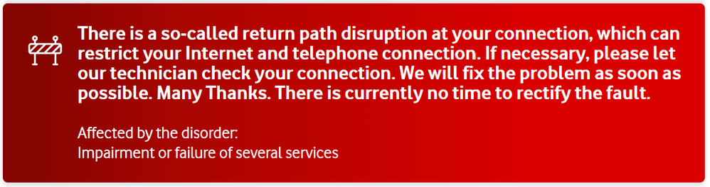

I have been checking interruption announcements and also overall messages informing of disruptions and I waited patiently for a solution, but even with the message yesterday that services would come back to normal after 18:00, nothing happened and it got worse. Now, when checking the assistent, the following is presented:
There is a so-called return path disruption at your connection, which can restrict your Internet and telephone connection. If necessary, please let our technician check your connection. We will fix the problem as soon as possible. Many Thanks. There is currently no time to rectify the fault.
Affected by the disorder:Impairment or failure of several services
With that being the current state, I face the need to actively contact service support for a proper fix, I cannot continue with a connection in this state where I can no longer work properly.

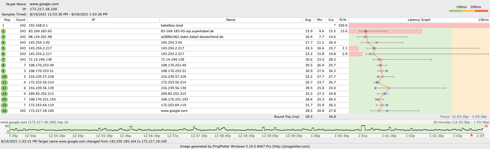

  • What is the error (Speed ​​too low; packet loss) Send screenshots of speed tests (with date and time) and tracer / ping plotter measurements in the event of packet loss or ping problems
    • Mainly described above. Additional information:
      • Most of the time, even with a proper IP assigned to the modem, the DNS stops responding and nothing makes it work again (restarting the modem, factory reset, cables were checked, the diagnostics tool was used to check multiple times, different DNS servers tried). Also, during speed tests, the upload speed was greatly decreased.

      • Traceroute Result
        traceroute to 142.250.186.174. 30hops max. 38 byte packets
        1: 83-169-183-65-isp.superkabel.de (83.169.183.65) 21ms
        2: ip5886c962.static.kabel-deutschland.de (88.134.201.98) 19ms
        3: 145.254.3.66 (145.254.3.66) 31ms
        4: 145.254.2.215 (145.254.2.215) 15ms
        5: 145.254.2.217 (145.254.2.217) 16ms
        6: 72.14.194.138 (72.14.194.138) 42ms
        7: *
        8: 108.170.253.49 (108.170.253.49) 23ms
        9: 108.170.253.68 (108.170.253.68) 23ms
        10: 216.239.57.7 (216.239.57.7) 27ms
        11: 172.253.50.110 (172.253.50.110) 33ms
        12: 209.85.241.145 (209.85.241.145) 46ms
        13: 209.85.252.28 (209.85.252.28) 26ms
        14: 108.170.251.129 (108.170.251.129) 22ms
        15: 142.250.214.203 (142.250.214.203) 22ms
        16: fra24s08-in-f14.1e100.net (142.250.186.174) 22ms

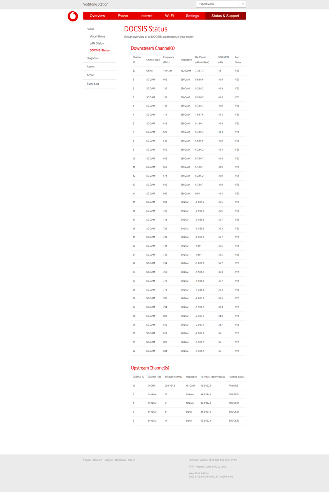

  • Upload a screenshot of the signal values . You can find this in the user interface of your cable router via  192.168.0.1 or via 192.168.178.1 on the Fritzbox.

9 Antworten 9
pRo-Marco
Hi Forkz,
if there is a return path disruption active, there is nothing we can do to acclerate the fix Smiley (traurig)
Kind regards
Marco

pRo-Marco
Hi Forkz,
thank you for your data. The colleagues are currently actively working on the interference suppression. Some components have already been checked and replaced. Unfortunately, the modulation of the upstreams is still not correct and the line often breaks down. I cannot yet give a prognosis as to when this will be resolved. Do you have a Vodafone SIM on which we can book data volume to bridge the gap?
Kind regards
Marco
Hi @pRo-Marco,
Thank you for the information.
Unfortunately I don't have a Vodafone mobile plan, is there another option?
Regards
Martin59
Hello Forkz,
unfortunately we have no other option there. The technicians are still working on the interference suppression so that the interference signal can be eliminated.
We will be happy to issue you a credit note once the fault has been rectified.
Best regards, Martin
