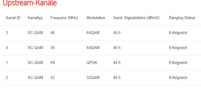

I saw this thread and posted our details there and saw someone talk about the modulation of upstream channels, so I checked this on our newly installed Vodafone Station box, and all 4 of our upstream channels are using QPSK modulation, which i believe will explain why the line is locking at 10-12mbps maximum upload and understand this shows a line fault?

Today the line is much better (for the first time in 48 hours) we can stream to twitch, but also DOCSIS stats for the upstream channels are showing 2 at 64QAM for the first time in 2 days too.
It seems like we only have major issues when the upstream channels drop to 8QAM and QPSK as shown in previous screenshots, so surely that indicates there is a fault somewhere?

The problems are now back, and the DOCSIS stats show the multiplexing has degraded.
DOCSIS upstream stats - Saturday 23rd Feb @ 11:11amDOCSIS upstream stats - Saturday 23rd Feb @ 11:11am
