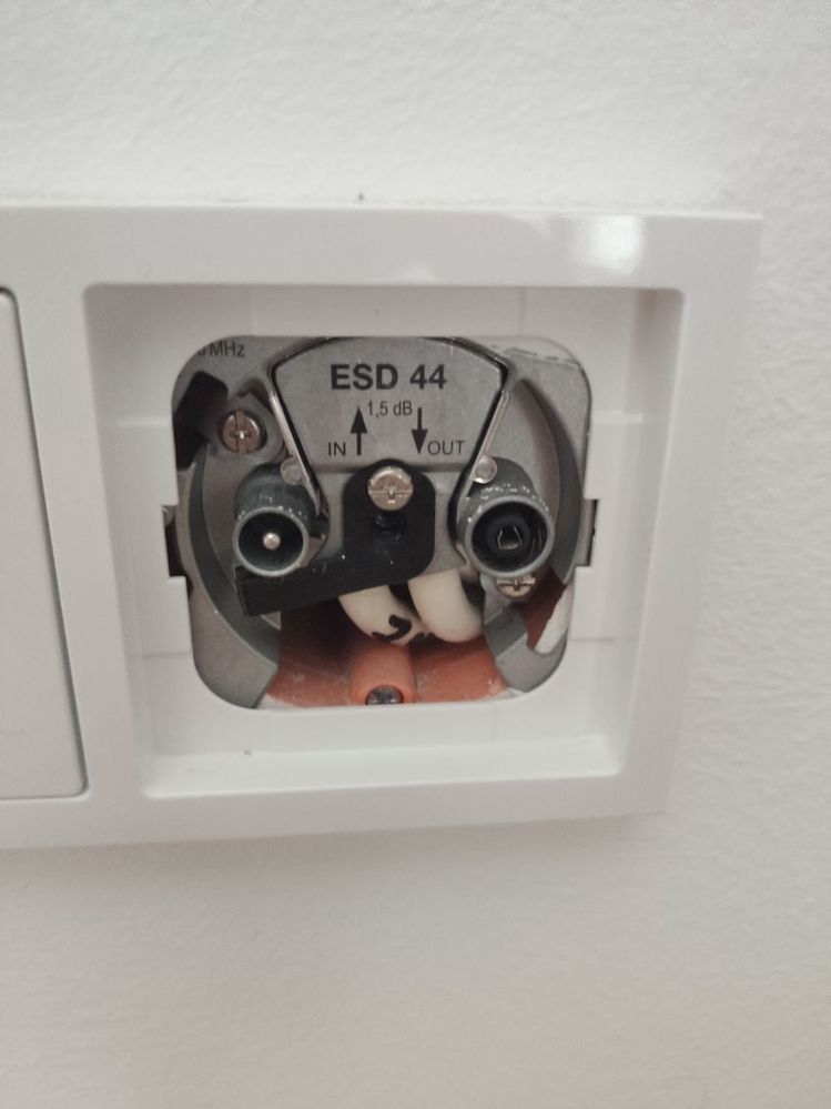

Thank you for clarifying this aspect. It seems I do not have visible chargable damages of the equipment or the wires or connectors.
However, prior to calling for a technician, I would like to provide you some additional information regarding the situation. I decided to look inside the wall socket I used to connect the router to, maybe it was damaged. Besides the fact that it was covered with paint (after the previous tenants painted the walls before leaving), it looked OK, please see photo "socket1" attached. However, I thought that maybe the paint might have caused some issues and I decided to connect the router in another room (photo "socket2"). The behavior is still the same: the Phone LED is still blinking red.
At the moment the router is being connected in the other room. Could you please check if the signals are any better now?

Hi,
the values are better now, but far from perfect and there are still frequent reboots. It will not get better without a technician intervention. Can I hire the technician?
