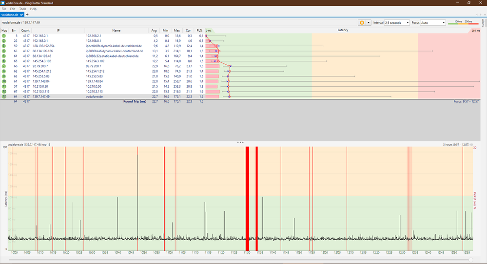

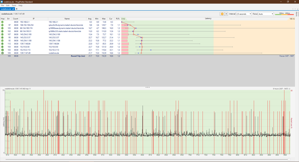

Here are a few pingplotter results:
before switching to IPv4:12h.png
after:
here's a longer one I ran today:
(I have no idea what caused that big red patch at the end, the internet just went down for about 70 seconds, randomly)
I still have the test running as I type this. Packet loss at the final hop is at 2% right now.

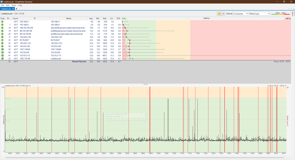

Right after the technician left I started a pingplotter, here are the results after 3 hours (bridge mode off😞
The technician told me to call again if the situation was not resolved. Since I was not the one that called/contacted him, I have no way to do it myself. I need someone to please reopen the ticket or open a new ticket, ideally with the same technician (since he already knows the basement setup so well). Please do it as soon as possible so I can schedule a visit as soon as possible, the situation is worse than it was yesterday!
