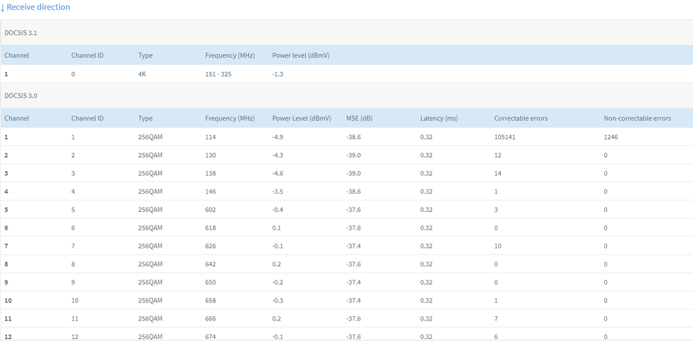

  • Upload a screenshot of the signal values . You can find this in the user interface of your cable router via  192.168.0.1 or via 192.168.178.1 on the Fritzbox.     Singal report.PNG

the upstream signal doesn't look good. Please try a different coaxial cable. If that doesn't help we will send a technician. Can you give him access to the house installation? Are there symptoms in your household that might be linked to Covid-19? Can the technician call the number that ends on 765 to make an appointment?
Kind regards,
Claudia
Thank you for reply. They have changed this cable so many times. but its not working. I think you need to replace cable from basement to household. There are no symptoms linked to Covid 19.  A Technician can call the number that ends on 765.
