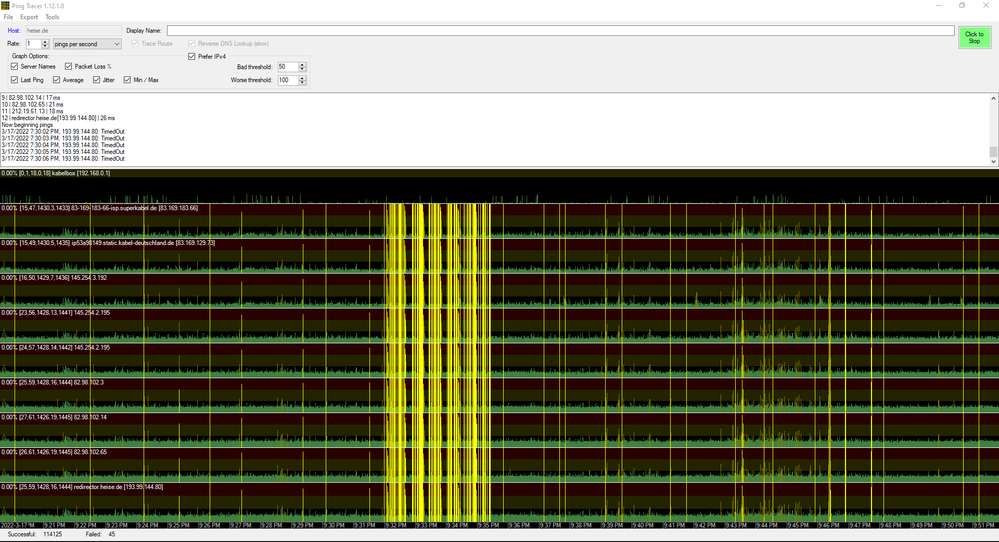

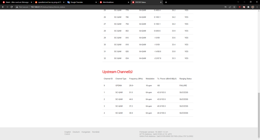

Speedtests below, I can't do the ping one right now, will do tomorrow! Thank you for helping me!
Here is the further requested info:

Further ping evidence from tonight:

Hi Wallace,
It appears to be consistent throughout the day. Started just a couple weeks ago. The main problem is if I try gaming, it makes it impossible. For other things it's ok. There has been some new construction next door for some time, not sure if they recently added internet and tapped into the line or anything. What can I do?
Manu
Hi mike2077,
in your area is a much to high load in the upstreams and downstreams. This can cause your problems. Our technicians work on fixing it, but it will take time. So we have to be patient.
I created a ticket for you for both issues, so that you will be informed when it is solved.
Best regards, Manu
