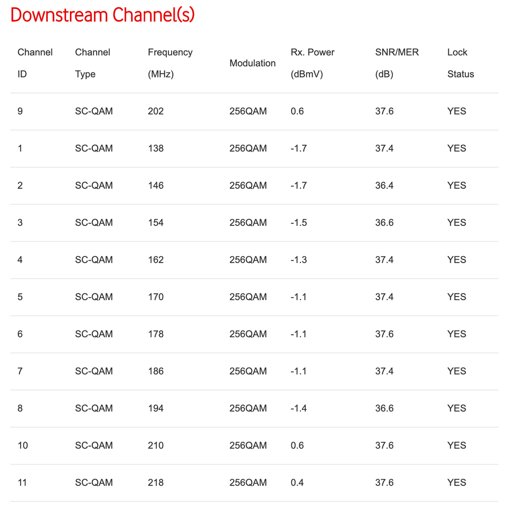

@John_Egerton
Can you post another screenshot of the current upstream channels for a comparison with the values from your first post?
At that time one upstream channel had a modulation of only 8QAM (instead of 64QAM)... and all channels were running with a Tx Power of 51 dBmV which is fairly high... under normal conditions 41,1-47,0 dBmV are "regular" values.
Regards,
SIGSEGV2

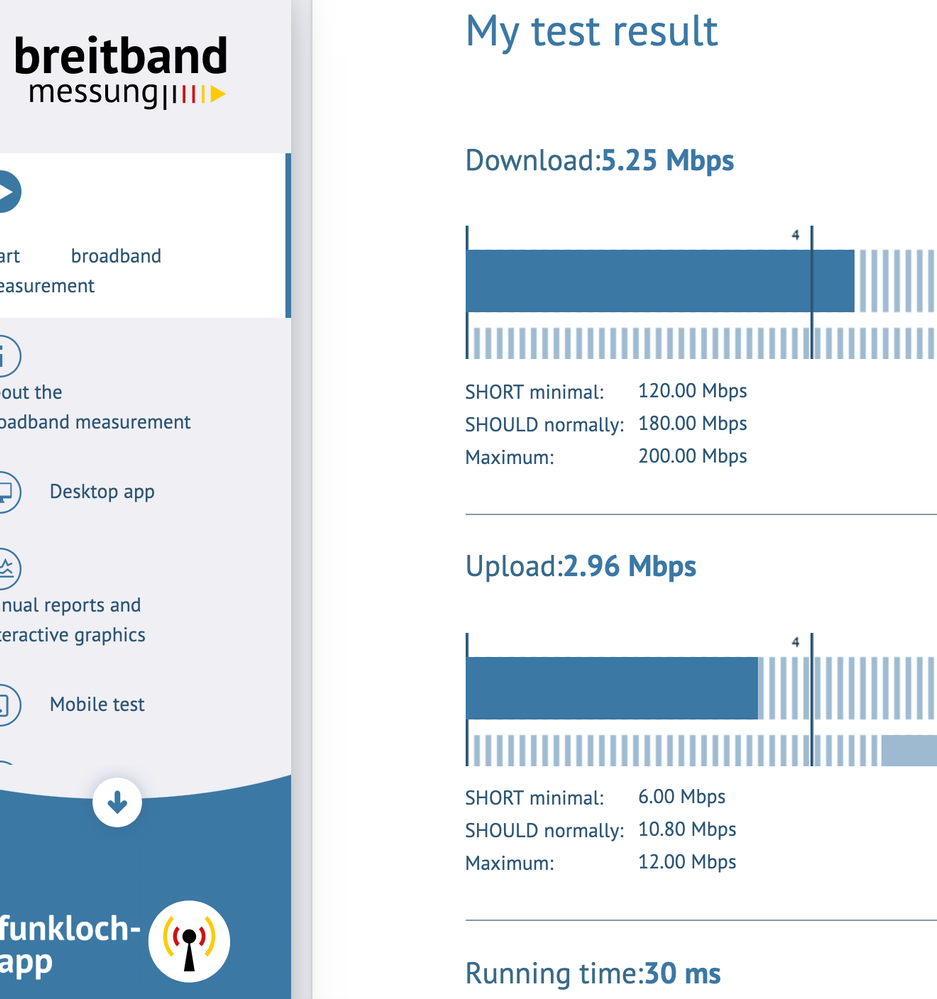

I have just ran 3 Vodafone speed checks and another on an independent site.
There is obviously a problem. High usage in my area shouldn't make things this bad,

Here you go...
I can confirm that the cable that comes through the floor is connected directly to my Vodafone router.
