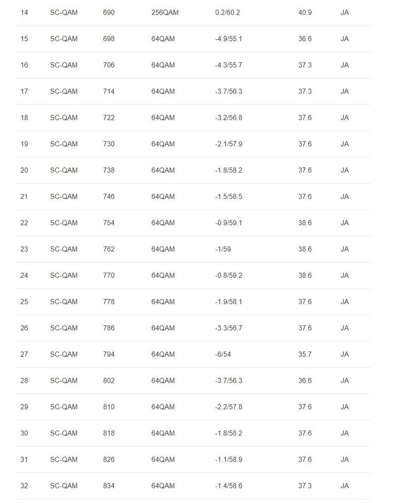

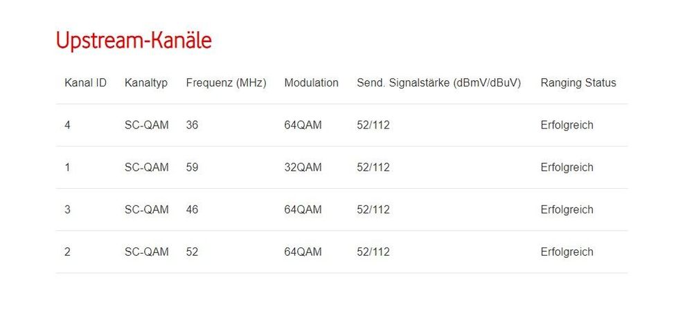

I have Kabel 400, and the router TG3442DE, and I experience 2 things that are bothering me quite a bit.
1. Upload Speed does usually have a speed of 10Mbps over the whole day, today I hired the increase to 50Mbps to see if it improves (even though I have to pay that but lets see), but even with the 50Mbps, now I am getting about 18-20 Mbps, not 50. I'm pretty sure I will get 50 at 2am, but that's not when I need upload speed.
2. The router TG3442DE is restarting randomly about 3 times a week. That is very random, and we don't understand the reason of this, and when it is in the middle of a "home office presentation" is not the nicest. I don't know why this happens and whether will continue happening forever.
I attach pictures of the DOCSIS at this moment:
Annotation 2020-05-04 215509.jpgAnnotation 2020-05-04 215553.jpgAnnotation 2020-05-04 215608.jpg
Can someone help me with this?
Thank you all for your help in advance!!!!

Hello,
I just sent you the information. Yesterday I called, with my not so good german, to the technical service, and they told me that they will give me a voucher of 10 euro if I call in 1 month, it was a bit strange, and that they are working on it, even though the worker didn't really sound convinced about anything. The reality is that internet upload speed is very slow during the day, and overnight seems to be 50Mbps, but on the day, maximum is 25Mbps, and yesterday at 6pm was about 5Mbps only.

Hello fjusdado,
the colleague made a task for you which it was assigned to a downstream utilisation, not upstream. But the upstream utilisation is very high as well, which causes the lower upload. I made a second task for that, so you will be informed via mail when the ticket is closed.

Hello fjusdado,
the ticket ***395/20 was not closed, but got assigned to the network utilisation as explained on May 7th. The network expansion should be finished in the next few weeks.
