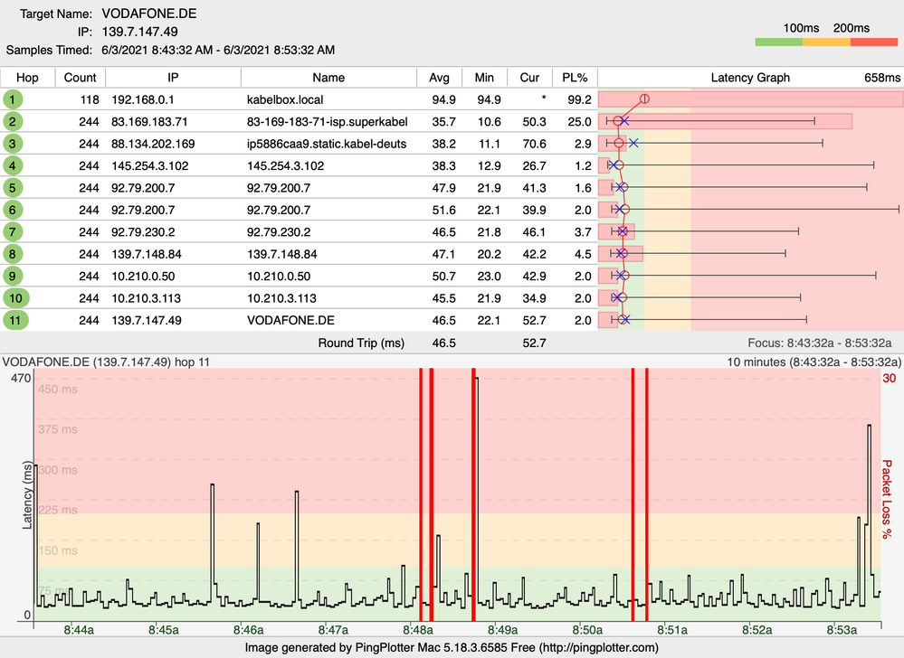

I'm on a "Red Internet & Phone 400 Cable" subscription and I'm experiencing frequent and heavy timeouts during the day and even at late hours that is interrupting my work from home as well as my gaming experience. Voice/Video calls drop, games freeze, webpages don't load.
This is not a wlan issue, I even tested this using an ethernet cable and still, the timeouts happen. Resetting the cable modem helps sometimes, but sometimes it doesn't. Not sure if it's related.
Can any of the mods please kindly look into this for me? Hope the disconnection logs are there in my profile.

Thank you for checking @Claudia,
The pingplotter report was recorded while connected via ethernet but on a 1s interval. And the video meeting I was in, was also interrupted as the side effect of the timeouts.

Hello zieppa,
the line looks good at the moment. The signal levels are all very good. It is also not due to the load. Can you please still do the ping plotter measurement at 2.5 second intervals via LAN? Download and upload are ok?

These pingplotter reports are made on a 2.5s interval and like always from an ethernet connection.
https://share.pingplotter.com/SVDKJccDExk
https://share.pingplotter.com/ewWdnEwTUiL
https://share.pingplotter.com/exNjAz8LRs6
While they are visually nicer than 1s timeout reports, they still easily disrupt video meetings. All 4 upstream channels are there btw.

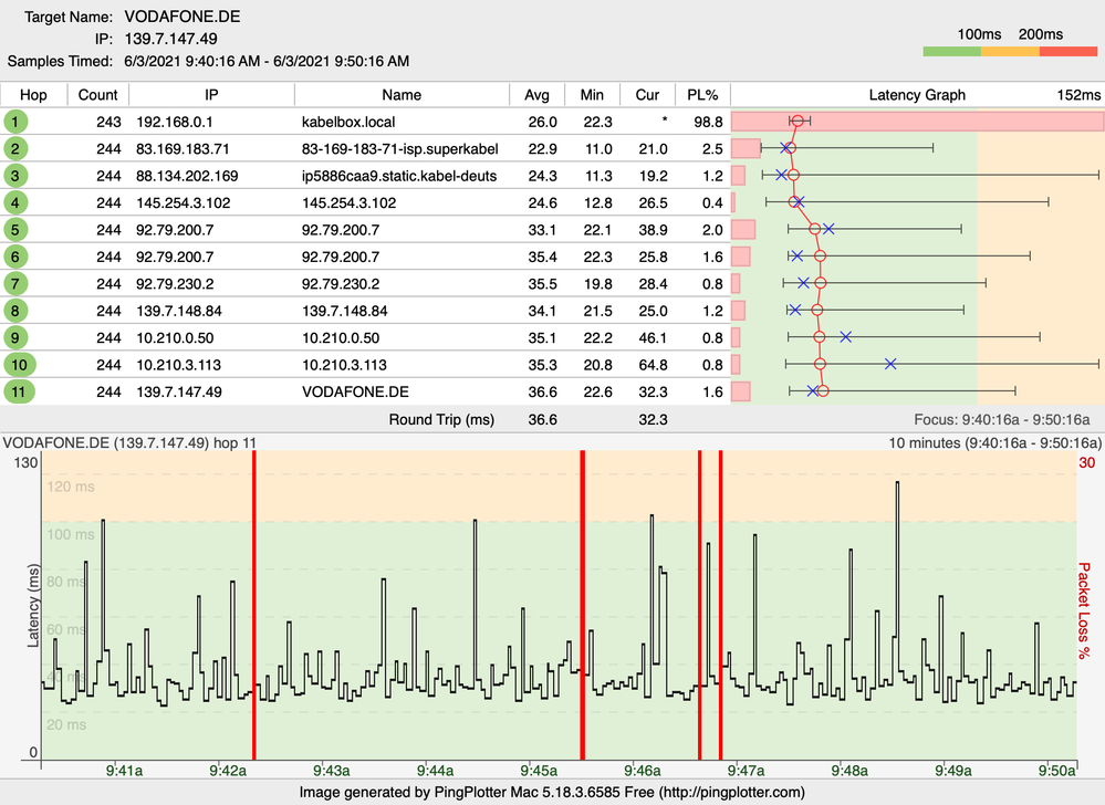

These are ethernet pingplotter reports I made on 2.5s this morning. If you wonder, I confirm that I still see that the sporadic timeouts, but according to my past experience, it's a good day.

My ideal bar for internet quality is that my work video calls don't get interrupted no matter the subjective definition of "massive" or occasional service incidents. My concern here is the chronic sporadic instability of the service. Here's now on 2,5s interval:

All my video calls were sporadically interrupted or pixelated this morning. This is a chronic and sporadic issue since May 2020, two technicians had visited, cable modem exchanged, nothing has changed though.
Here's now again (through ethernet), no problem, hence the sporadic nature I tried to communicate to the visiting technicians:

On your connection, the upstream levels fluctuate by 10 dB and this must be looked at by a technician on site. The cause seems to lie in our area of responsibility. In this case, the service is free of charge for you. Only if the technician does not meet anyone at the agreed time and cannot gain access, we will charge 99.50 €.
Do you agree to a technician call-out and can you provide access to the house system? What is the best number to call to make an appointment?
