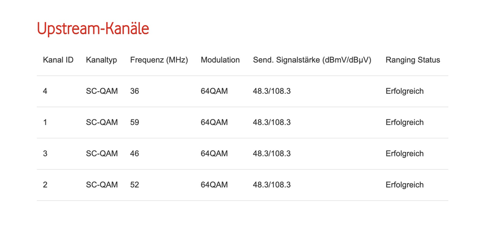

Einen schönen guten Morgen @Claudia,
Just so that we're on the same page, there was an unexpected internet hiccup a few minutes ago and it came back online shortly.
Now, I see all four upstream channels back online:

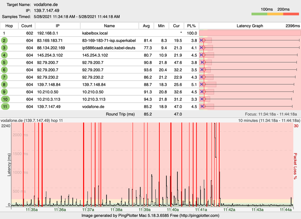

Wish it would remain as stable.
https://share.pingplotter.com/4aDBfTsY6Nc

This marks a transient rush of timeouts I just experienced and ruined a work call while all 4 upstream channels were up & running:
https://share.pingplotter.com/44YkMn8npRB

Hello zieppa,
the signal looks good right now. I checked the line and there is no apparent problem. Did you make the Pingplotter measure via ethernet with a 2.5 second intervall?
