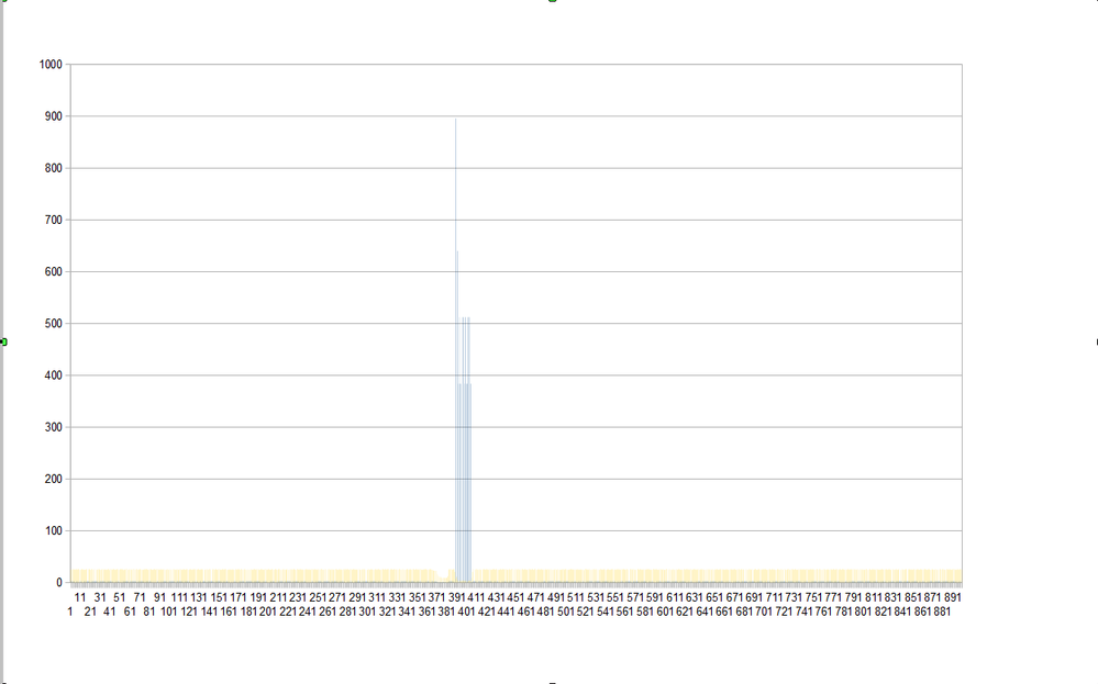

iPerf Diagramm:
Entschuldigung wenn es ein falsches Diagramm ist.
iPerf result:
Mehr anzeigen
iperf 3.1.3
CYGWIN_NT-10.0 BlackGreenBeast 2.5.1(0.297/5/3) 2016-04-21 22:14 x86_64
Time: Fri, 22 Jul 2022 11:16:21 GMT
Connecting to host iperf.par2.as49434.net, port 9231
Cookie: BlackGreenBeast.1658488581.063289.21
TCP MSS: 0 (default)
[ 4] local 192.168.178.20 port 51122 connected to 193.177.162.41 port 9231
Starting Test: protocol: TCP, 1 streams, 131072 byte blocks, omitting 0 seconds, 900 second test

[ 4] 129.01-130.01 sec 3.12 MBytes 26.2 Mbits/sec
[ 4] 130.01-131.01 sec 3.00 MBytes 25.1 Mbits/sec
[ 4] 131.01-132.01 sec 3.00 MBytes 25.2 Mbits/sec
[ 4] 132.01-133.00 sec 3.00 MBytes 25.3 Mbits/sec
[ 4] 133.00-134.02 sec 3.12 MBytes 25.9 Mbits/sec
[ 4] 134.02-135.00 sec 3.00 MBytes 25.5 Mbits/sec
[ 4] 135.00-136.00 sec 3.00 MBytes 25.2 Mbits/sec
[ 4] 136.00-137.01 sec 3.00 MBytes 24.9 Mbits/sec
[ 4] 137.01-138.00 sec 3.00 MBytes 25.3 Mbits/sec
[ 4] 138.00-139.00 sec 3.12 MBytes 26.2 Mbits/sec
[ 4] 139.00-140.01 sec 3.00 MBytes 25.1 Mbits/sec
[ 4] 140.01-141.01 sec 3.00 MBytes 25.2 Mbits/sec
[ 4] 141.01-142.00 sec 3.12 MBytes 26.3 Mbits/sec
[ 4] 142.00-143.01 sec 3.00 MBytes 24.9 Mbits/sec
[ 4] 143.01-144.01 sec 3.00 MBytes 25.2 Mbits/sec
[ 4] 144.01-145.00 sec 3.12 MBytes 26.4 Mbits/sec
[ 4] 145.00-146.00 sec 3.00 MBytes 25.2 Mbits/sec
[ 4] 146.00-147.00 sec 3.00 MBytes 25.2 Mbits/sec
[ 4] 147.00-148.01 sec 3.12 MBytes 26.1 Mbits/sec
[ 4] 148.01-149.00 sec 3.00 MBytes 25.2 Mbits/sec
[ 4] 149.00-150.01 sec 3.00 MBytes 25.0 Mbits/sec
[ 4] 150.01-151.01 sec 3.12 MBytes 26.2 Mbits/sec
[ 4] 151.01-152.01 sec 3.00 MBytes 25.1 Mbits/sec
[ 4] 152.01-153.01 sec 3.00 MBytes 25.1 Mbits/sec
[ 4] 153.01-154.01 sec 3.00 MBytes 25.2 Mbits/sec
[ 4] 154.01-155.01 sec 3.12 MBytes 26.3 Mbits/sec
[ 4] 155.01-156.01 sec 3.00 MBytes 25.2 Mbits/sec
[ 4] 156.01-157.00 sec 3.00 MBytes 25.3 Mbits/sec
[ 4] 157.00-158.01 sec 3.12 MBytes 26.1 Mbits/sec
[ 4] 158.01-159.01 sec 3.00 MBytes 25.0 Mbits/sec
[ 4] 159.01-160.01 sec 3.00 MBytes 25.2 Mbits/sec
[ 4] 160.01-161.01 sec 3.00 MBytes 25.1 Mbits/sec
[ 4] 161.01-162.00 sec 3.00 MBytes 25.5 Mbits/sec
[ 4] 162.00-163.01 sec 3.00 MBytes 25.0 Mbits/sec
[ 4] 163.01-164.01 sec 3.00 MBytes 25.1 Mbits/sec
[ 4] 164.01-165.00 sec 3.00 MBytes 25.3 Mbits/sec
[ 4] 165.00-166.01 sec 3.00 MBytes 25.1 Mbits/sec
[ 4] 166.01-167.00 sec 3.00 MBytes 25.2 Mbits/sec
[ 4] 167.00-168.01 sec 3.12 MBytes 25.9 Mbits/sec
[ 4] 168.01-169.01 sec 3.00 MBytes 25.2 Mbits/sec
[ 4] 169.01-170.01 sec 3.00 MBytes 25.3 Mbits/sec
[ 4] 170.01-171.00 sec 3.12 MBytes 26.4 Mbits/sec
[ 4] 171.00-172.01 sec 3.00 MBytes 25.0 Mbits/sec
[ 4] 172.01-173.01 sec 3.00 MBytes 25.2 Mbits/sec
[ 4] 173.01-174.00 sec 3.12 MBytes 26.4 Mbits/sec
[ 4] 174.00-175.01 sec 3.00 MBytes 25.0 Mbits/sec
[ 4] 175.01-176.00 sec 3.00 MBytes 25.3 Mbits/sec
[ 4] 176.00-177.01 sec 3.12 MBytes 26.0 Mbits/sec
[ 4] 177.01-178.01 sec 3.00 MBytes 25.2 Mbits/sec
[ 4] 178.01-179.01 sec 3.00 MBytes 25.1 Mbits/sec
[ 4] 179.01-180.01 sec 3.00 MBytes 25.2 Mbits/sec
[ 4] 180.01-181.00 sec 3.00 MBytes 25.3 Mbits/sec
[ 4] 181.00-182.01 sec 3.00 MBytes 25.0 Mbits/sec
[ 4] 182.01-183.01 sec 3.12 MBytes 26.4 Mbits/sec
[ 4] 183.01-184.01 sec 3.00 MBytes 25.1 Mbits/sec
[ 4] 184.01-185.01 sec 3.00 MBytes 25.2 Mbits/sec
[ 4] 185.01-186.00 sec 3.00 MBytes 25.3 Mbits/sec
[ 4] 186.00-187.01 sec 3.12 MBytes 26.1 Mbits/sec
[ 4] 187.01-188.00 sec 3.00 MBytes 25.2 Mbits/sec
[ 4] 188.00-189.00 sec 3.00 MBytes 25.3 Mbits/sec
[ 4] 189.00-190.01 sec 3.12 MBytes 25.9 Mbits/sec
[ 4] 190.01-191.00 sec 3.00 MBytes 25.5 Mbits/sec
[ 4] 191.00-192.01 sec 3.00 MBytes 24.8 Mbits/sec
[ 4] 192.01-193.00 sec 3.00 MBytes 25.5 Mbits/sec
[ 4] 193.00-194.01 sec 3.12 MBytes 26.1 Mbits/sec
[ 4] 194.01-195.01 sec 3.00 MBytes 25.1 Mbits/sec
[ 4] 195.01-196.01 sec 3.00 MBytes 25.2 Mbits/sec
[ 4] 196.01-197.01 sec 3.00 MBytes 25.1 Mbits/sec
[ 4] 197.01-198.00 sec 3.12 MBytes 26.4 Mbits/sec
[ 4] 198.00-199.00 sec 3.00 MBytes 25.2 Mbits/sec
[ 4] 199.00-200.01 sec 3.00 MBytes 24.9 Mbits/sec
[ 4] 200.01-201.01 sec 3.12 MBytes 26.3 Mbits/sec
[ 4] 201.01-202.01 sec 3.00 MBytes 25.1 Mbits/sec
[ 4] 202.01-203.01 sec 3.00 MBytes 25.2 Mbits/sec
[ 4] 203.01-204.01 sec 3.00 MBytes 25.2 Mbits/sec
[ 4] 204.01-205.01 sec 3.12 MBytes 26.3 Mbits/sec
[ 4] 205.01-206.01 sec 3.00 MBytes 25.1 Mbits/sec
[ 4] 206.01-207.01 sec 3.00 MBytes 25.2 Mbits/sec
[ 4] 207.01-208.00 sec 3.12 MBytes 26.4 Mbits/sec
[ 4] 208.00-209.01 sec 3.00 MBytes 24.9 Mbits/sec
[ 4] 209.01-210.01 sec 3.00 MBytes 25.2 Mbits/sec
[ 4] 210.01-211.01 sec 3.00 MBytes 25.3 Mbits/sec
[ 4] 211.01-212.01 sec 3.12 MBytes 26.2 Mbits/sec
[ 4] 212.01-213.01 sec 3.00 MBytes 25.1 Mbits/sec
[ 4] 213.01-214.01 sec 3.00 MBytes 25.2 Mbits/sec
[ 4] 214.01-215.00 sec 3.00 MBytes 25.3 Mbits/sec
[ 4] 215.00-216.01 sec 3.12 MBytes 26.0 Mbits/sec
[ 4] 216.01-217.01 sec 3.00 MBytes 25.1 Mbits/sec
[ 4] 217.01-218.01 sec 3.00 MBytes 25.3 Mbits/sec
[ 4] 218.01-219.01 sec 3.00 MBytes 25.2 Mbits/sec
[ 4] 219.01-220.00 sec 3.12 MBytes 26.2 Mbits/sec
[ 4] 220.00-221.01 sec 3.00 MBytes 25.0 Mbits/sec
[ 4] 221.01-222.01 sec 3.00 MBytes 25.3 Mbits/sec
[ 4] 222.01-223.00 sec 3.00 MBytes 25.3 Mbits/sec
[ 4] 223.00-224.01 sec 3.12 MBytes 25.9 Mbits/sec
[ 4] 224.01-225.01 sec 3.00 MBytes 25.2 Mbits/sec
[ 4] 225.01-226.01 sec 3.00 MBytes 25.3 Mbits/sec
[ 4] 226.01-227.00 sec 3.12 MBytes 26.3 Mbits/sec
[ 4] 227.00-228.00 sec 3.00 MBytes 25.2 Mbits/sec
[ 4] 228.00-229.00 sec 3.00 MBytes 25.2 Mbits/sec
[ 4] 229.00-230.00 sec 3.12 MBytes 26.2 Mbits/sec
[ 4] 230.00-231.01 sec 3.00 MBytes 25.1 Mbits/sec
[ 4] 231.01-232.02 sec 3.00 MBytes 24.9 Mbits/sec
[ 4] 232.02-233.01 sec 3.12 MBytes 26.4 Mbits/sec
[ 4] 233.01-234.01 sec 3.00 MBytes 25.1 Mbits/sec
[ 4] 234.01-235.01 sec 3.00 MBytes 25.3 Mbits/sec
[ 4] 235.01-236.01 sec 3.00 MBytes 25.2 Mbits/sec
[ 4] 236.01-237.01 sec 3.00 MBytes 25.2 Mbits/sec
[ 4] 237.01-238.00 sec 3.00 MBytes 25.3 Mbits/sec
[ 4] 238.00-239.01 sec 3.12 MBytes 26.0 Mbits/sec
[ 4] 239.01-240.00 sec 3.00 MBytes 25.3 Mbits/sec
[ 4] 240.00-241.01 sec 3.00 MBytes 25.0 Mbits/sec
[ 4] 241.01-242.00 sec 3.00 MBytes 25.3 Mbits/sec
[ 4] 242.00-243.00 sec 3.00 MBytes 25.2 Mbits/sec
[ 4] 243.00-244.00 sec 3.00 MBytes 25.2 Mbits/sec
[ 4] 244.00-245.00 sec 3.12 MBytes 26.1 Mbits/sec
[ 4] 245.00-246.01 sec 3.00 MBytes 25.1 Mbits/sec
[ 4] 246.01-247.00 sec 3.00 MBytes 25.3 Mbits/sec
[ 4] 247.00-248.01 sec 3.12 MBytes 26.0 Mbits/sec
[ 4] 248.01-249.01 sec 3.00 MBytes 25.2 Mbits/sec
[ 4] 249.01-250.00 sec 3.00 MBytes 25.2 Mbits/sec
[ 4] 250.00-251.00 sec 3.00 MBytes 25.3 Mbits/sec
[ 4] 251.00-252.01 sec 3.12 MBytes 25.9 Mbits/sec
[ 4] 252.01-253.01 sec 3.00 MBytes 25.2 Mbits/sec
[ 4] 253.01-254.01 sec 3.12 MBytes 26.3 Mbits/sec
[ 4] 254.01-255.00 sec 3.00 MBytes 25.3 Mbits/sec
[ 4] 255.00-256.00 sec 3.00 MBytes 25.1 Mbits/sec
[ 4] 256.00-257.01 sec 3.00 MBytes 24.9 Mbits/sec
[ 4] 257.01-258.01 sec 3.00 MBytes 25.4 Mbits/sec
[ 4] 258.01-259.01 sec 3.12 MBytes 26.1 Mbits/sec
[ 4] 259.01-260.01 sec 3.00 MBytes 25.2 Mbits/sec
[ 4] 260.01-261.00 sec 3.00 MBytes 25.3 Mbits/sec
[ 4] 261.00-262.00 sec 3.12 MBytes 26.3 Mbits/sec
[ 4] 262.00-263.00 sec 3.00 MBytes 25.1 Mbits/sec
[ 4] 263.00-264.00 sec 3.00 MBytes 25.2 Mbits/sec
[ 4] 264.00-265.00 sec 3.12 MBytes 26.3 Mbits/sec
[ 4] 265.00-266.01 sec 3.00 MBytes 24.9 Mbits/sec
[ 4] 266.01-267.01 sec 3.00 MBytes 25.2 Mbits/sec
[ 4] 267.01-268.01 sec 3.00 MBytes 25.3 Mbits/sec
[ 4] 268.01-269.00 sec 3.12 MBytes 26.3 Mbits/sec
[ 4] 269.00-270.00 sec 3.00 MBytes 25.2 Mbits/sec
[ 4] 270.00-271.01 sec 3.00 MBytes 24.8 Mbits/sec
[ 4] 271.01-272.00 sec 3.00 MBytes 25.5 Mbits/sec
[ 4] 272.00-273.02 sec 3.12 MBytes 25.8 Mbits/sec
[ 4] 273.02-274.01 sec 3.00 MBytes 25.2 Mbits/sec
[ 4] 274.01-275.01 sec 3.00 MBytes 25.3 Mbits/sec
[ 4] 275.01-276.01 sec 3.00 MBytes 25.2 Mbits/sec
[ 4] 276.01-277.01 sec 3.12 MBytes 26.1 Mbits/sec
[ 4] 277.01-278.00 sec 2.88 MBytes 24.2 Mbits/sec
[ 4] 278.00-279.00 sec 3.12 MBytes 26.3 Mbits/sec
[ 4] 279.00-280.01 sec 3.00 MBytes 24.9 Mbits/sec
[ 4] 280.01-281.01 sec 3.12 MBytes 26.4 Mbits/sec
[ 4] 281.01-282.00 sec 3.00 MBytes 25.2 Mbits/sec
[ 4] 282.00-283.01 sec 3.00 MBytes 24.9 Mbits/sec
[ 4] 283.01-284.01 sec 3.12 MBytes 26.4 Mbits/sec
[ 4] 284.01-285.01 sec 3.00 MBytes 25.2 Mbits/sec
[ 4] 285.01-286.00 sec 3.00 MBytes 25.3 Mbits/sec
[ 4] 286.00-287.01 sec 3.12 MBytes 26.1 Mbits/sec
[ 4] 287.01-288.01 sec 3.00 MBytes 25.0 Mbits/sec
[ 4] 288.01-289.01 sec 3.00 MBytes 25.3 Mbits/sec
[ 4] 289.01-290.01 sec 3.00 MBytes 25.0 Mbits/sec
[ 4] 290.01-291.01 sec 3.00 MBytes 25.3 Mbits/sec
[ 4] 291.01-292.01 sec 3.12 MBytes 26.3 Mbits/sec
[ 4] 292.01-293.01 sec 3.00 MBytes 25.2 Mbits/sec
[ 4] 293.01-294.00 sec 3.00 MBytes 25.2 Mbits/sec
[ 4] 294.00-295.00 sec 3.00 MBytes 25.2 Mbits/sec
[ 4] 295.00-296.01 sec 3.12 MBytes 26.0 Mbits/sec
[ 4] 296.01-297.00 sec 3.00 MBytes 25.4 Mbits/sec
[ 4] 297.00-298.01 sec 3.12 MBytes 26.0 Mbits/sec
[ 4] 298.01-299.01 sec 3.00 MBytes 25.1 Mbits/sec
[ 4] 299.01-300.01 sec 3.00 MBytes 25.2 Mbits/sec
[ 4] 300.01-301.01 sec 3.00 MBytes 25.2 Mbits/sec
[ 4] 301.01-302.00 sec 3.12 MBytes 26.4 Mbits/sec
[ 4] 302.00-303.01 sec 3.00 MBytes 25.0 Mbits/sec
[ 4] 303.01-304.01 sec 3.00 MBytes 25.2 Mbits/sec
[ 4] 304.01-305.00 sec 3.12 MBytes 26.3 Mbits/sec
[ 4] 305.00-306.01 sec 3.00 MBytes 24.9 Mbits/sec
[ 4] 306.01-307.01 sec 3.00 MBytes 25.2 Mbits/sec
[ 4] 307.01-308.01 sec 3.00 MBytes 25.2 Mbits/sec
[ 4] 308.01-309.00 sec 3.12 MBytes 26.4 Mbits/sec
[ 4] 309.00-310.02 sec 3.00 MBytes 24.8 Mbits/sec
[ 4] 310.02-311.00 sec 3.00 MBytes 25.6 Mbits/sec
[ 4] 311.00-312.01 sec 3.12 MBytes 26.1 Mbits/sec
[ 4] 312.01-313.01 sec 3.00 MBytes 25.1 Mbits/sec
[ 4] 313.01-314.01 sec 3.00 MBytes 25.0 Mbits/sec
[ 4] 314.01-315.01 sec 3.00 MBytes 25.2 Mbits/sec
[ 4] 315.01-316.01 sec 3.12 MBytes 26.3 Mbits/sec
[ 4] 316.01-317.00 sec 3.00 MBytes 25.3 Mbits/sec
[ 4] 317.00-318.00 sec 3.00 MBytes 25.2 Mbits/sec
[ 4] 318.00-319.00 sec 3.12 MBytes 26.1 Mbits/sec
[ 4] 319.00-320.01 sec 3.00 MBytes 24.9 Mbits/sec
[ 4] 320.01-321.00 sec 3.00 MBytes 25.4 Mbits/sec
[ 4] 321.00-322.00 sec 3.12 MBytes 26.2 Mbits/sec
[ 4] 322.00-323.02 sec 3.00 MBytes 24.9 Mbits/sec
[ 4] 323.02-324.00 sec 3.00 MBytes 25.5 Mbits/sec
[ 4] 324.00-325.01 sec 3.12 MBytes 26.1 Mbits/sec
[ 4] 325.01-326.01 sec 3.00 MBytes 25.1 Mbits/sec
[ 4] 326.01-327.01 sec 3.00 MBytes 25.1 Mbits/sec
[ 4] 327.01-328.00 sec 3.12 MBytes 26.4 Mbits/sec
[ 4] 328.00-329.01 sec 3.00 MBytes 24.9 Mbits/sec
[ 4] 329.01-330.01 sec 3.00 MBytes 25.3 Mbits/sec
[ 4] 330.01-331.00 sec 3.00 MBytes 25.3 Mbits/sec
[ 4] 331.00-332.01 sec 3.00 MBytes 25.1 Mbits/sec
[ 4] 332.01-333.00 sec 3.12 MBytes 26.3 Mbits/sec
[ 4] 333.00-334.00 sec 3.00 MBytes 25.2 Mbits/sec
[ 4] 334.00-335.01 sec 3.00 MBytes 25.0 Mbits/sec
[ 4] 335.01-336.01 sec 3.00 MBytes 25.3 Mbits/sec
[ 4] 336.01-337.00 sec 3.12 MBytes 26.2 Mbits/sec
[ 4] 337.00-338.00 sec 3.00 MBytes 25.2 Mbits/sec
[ 4] 338.00-339.01 sec 3.00 MBytes 25.0 Mbits/sec
[ 4] 339.01-340.00 sec 3.00 MBytes 25.4 Mbits/sec
[ 4] 340.00-341.00 sec 3.12 MBytes 26.2 Mbits/sec
[ 4] 341.00-342.01 sec 3.00 MBytes 25.0 Mbits/sec
[ 4] 342.01-343.02 sec 3.00 MBytes 25.0 Mbits/sec
[ 4] 343.02-344.01 sec 3.12 MBytes 26.4 Mbits/sec
[ 4] 344.01-345.01 sec 3.00 MBytes 25.1 Mbits/sec
[ 4] 345.01-346.01 sec 3.00 MBytes 25.3 Mbits/sec
[ 4] 346.01-347.01 sec 3.12 MBytes 26.2 Mbits/sec
[ 4] 347.01-348.01 sec 3.00 MBytes 25.1 Mbits/sec
[ 4] 348.01-349.01 sec 3.00 MBytes 25.1 Mbits/sec
[ 4] 349.01-350.01 sec 3.12 MBytes 26.3 Mbits/sec
[ 4] 350.01-351.01 sec 3.00 MBytes 25.2 Mbits/sec
[ 4] 351.01-352.01 sec 3.00 MBytes 25.3 Mbits/sec
[ 4] 352.01-353.01 sec 3.00 MBytes 24.9 Mbits/sec
[ 4] 353.01-354.00 sec 3.12 MBytes 26.5 Mbits/sec
[ 4] 354.00-355.01 sec 3.00 MBytes 25.1 Mbits/sec
[ 4] 355.01-356.01 sec 3.00 MBytes 25.2 Mbits/sec
[ 4] 356.01-357.00 sec 3.00 MBytes 25.2 Mbits/sec
[ 4] 357.00-358.01 sec 3.12 MBytes 25.9 Mbits/sec
[ 4] 358.01-359.01 sec 3.00 MBytes 25.3 Mbits/sec
[ 4] 359.01-360.00 sec 3.12 MBytes 26.3 Mbits/sec
[ 4] 360.00-361.00 sec 3.00 MBytes 25.2 Mbits/sec
[ 4] 361.00-362.01 sec 3.00 MBytes 24.9 Mbits/sec
[ 4] 362.01-363.01 sec 3.00 MBytes 25.3 Mbits/sec
[ 4] 363.01-364.00 sec 3.12 MBytes 26.3 Mbits/sec
[ 4] 364.00-365.01 sec 3.00 MBytes 24.9 Mbits/sec
[ 4] 365.01-366.01 sec 3.00 MBytes 25.2 Mbits/sec
[ 4] 366.01-367.01 sec 2.88 MBytes 24.3 Mbits/sec
[ 4] 367.01-368.01 sec 2.75 MBytes 23.1 Mbits/sec
[ 4] 368.01-369.01 sec 2.75 MBytes 23.0 Mbits/sec
[ 4] 369.01-370.01 sec 2.75 MBytes 23.0 Mbits/sec
[ 4] 370.01-371.01 sec 2.00 MBytes 16.7 Mbits/sec
[ 4] 371.01-372.01 sec 1.62 MBytes 13.7 Mbits/sec
[ 4] 372.01-373.01 sec 1.38 MBytes 11.5 Mbits/sec
[ 4] 373.01-374.01 sec 1.25 MBytes 10.5 Mbits/sec
[ 4] 374.01-375.00 sec 1.25 MBytes 10.6 Mbits/sec
[ 4] 375.00-376.00 sec 1.00 MBytes 8.41 Mbits/sec
[ 4] 376.00-377.00 sec 1.12 MBytes 9.42 Mbits/sec
[ 4] 377.00-378.00 sec 1.12 MBytes 9.44 Mbits/sec
[ 4] 378.00-379.01 sec 1.00 MBytes 8.35 Mbits/sec
[ 4] 379.01-380.01 sec 1.12 MBytes 9.43 Mbits/sec
[ 4] 380.01-381.01 sec 1.12 MBytes 9.43 Mbits/sec
[ 4] 381.01-382.01 sec 1.50 MBytes 12.5 Mbits/sec
[ 4] 382.01-383.01 sec 3.00 MBytes 25.3 Mbits/sec
[ 4] 383.01-384.00 sec 3.00 MBytes 25.3 Mbits/sec
[ 4] 384.00-385.00 sec 3.12 MBytes 26.3 Mbits/sec
[ 4] 385.00-386.01 sec 3.00 MBytes 24.9 Mbits/sec
[ 4] 386.01-387.00 sec 3.00 MBytes 25.4 Mbits/sec
[ 4] 387.00-388.01 sec 3.12 MBytes 26.2 Mbits/sec
[ 4] 388.01-389.01 sec 2.50 MBytes 20.9 Mbits/sec
[ 4] 389.01-390.00 sec 896 KBytes 7.38 Mbits/sec
[ 4] 390.00-391.01 sec 1.38 MBytes 11.5 Mbits/sec
[ 4] 391.01-392.01 sec 640 KBytes 5.21 Mbits/sec
[ 4] 392.01-393.00 sec 384 KBytes 3.17 Mbits/sec
[ 4] 393.00-394.01 sec 512 KBytes 4.16 Mbits/sec
[ 4] 394.01-395.00 sec 384 KBytes 3.17 Mbits/sec
[ 4] 395.00-396.01 sec 384 KBytes 3.13 Mbits/sec
[ 4] 396.01-397.01 sec 512 KBytes 4.19 Mbits/sec
[ 4] 397.01-398.01 sec 512 KBytes 4.18 Mbits/sec
[ 4] 398.01-399.00 sec 384 KBytes 3.18 Mbits/sec
[ 4] 399.00-400.01 sec 512 KBytes 4.17 Mbits/sec
[ 4] 400.01-401.01 sec 384 KBytes 3.15 Mbits/sec
[ 4] 401.01-402.01 sec 384 KBytes 3.14 Mbits/sec
[ 4] 402.01-403.01 sec 512 KBytes 4.21 Mbits/sec
[ 4] 403.01-404.01 sec 512 KBytes 4.19 Mbits/sec
[ 4] 404.01-405.01 sec 384 KBytes 3.13 Mbits/sec
[ 4] 405.01-406.00 sec 1.12 MBytes 9.53 Mbits/sec
[ 4] 406.00-407.00 sec 2.50 MBytes 21.0 Mbits/sec
[ 4] 407.00-408.00 sec 3.12 MBytes 26.2 Mbits/sec
[ 4] 408.00-409.01 sec 3.00 MBytes 24.9 Mbits/sec
[ 4] 409.01-410.01 sec 3.00 MBytes 25.3 Mbits/sec
[ 4] 410.01-411.00 sec 3.12 MBytes 26.4 Mbits/sec
[ 4] 411.00-412.00 sec 3.00 MBytes 25.1 Mbits/sec
[ 4] 412.00-413.01 sec 3.00 MBytes 25.1 Mbits/sec
[ 4] 413.01-414.00 sec 3.12 MBytes 26.4 Mbits/sec
[ 4] 414.00-415.01 sec 3.00 MBytes 24.9 Mbits/sec
[ 4] 415.01-416.01 sec 3.00 MBytes 25.3 Mbits/sec
[ 4] 416.01-417.00 sec 3.00 MBytes 25.3 Mbits/sec
[ 4] 417.00-418.00 sec 3.12 MBytes 26.3 Mbits/sec
[ 4] 418.00-419.01 sec 3.00 MBytes 24.9 Mbits/sec
[ 4] 419.01-420.00 sec 3.00 MBytes 25.3 Mbits/sec
[ 4] 420.00-421.01 sec 3.12 MBytes 26.0 Mbits/sec
[ 4] 421.01-422.00 sec 3.00 MBytes 25.3 Mbits/sec
[ 4] 422.00-423.01 sec 3.00 MBytes 25.1 Mbits/sec
[ 4] 423.01-424.01 sec 3.12 MBytes 26.0 Mbits/sec
[ 4] 424.01-425.01 sec 3.00 MBytes 25.2 Mbits/sec
[ 4] 425.01-426.02 sec 3.00 MBytes 25.1 Mbits/sec
[ 4] 426.02-427.00 sec 3.00 MBytes 25.5 Mbits/sec
[ 4] 427.00-428.01 sec 3.12 MBytes 26.2 Mbits/sec
[ 4] 428.01-429.00 sec 3.00 MBytes 25.3 Mbits/sec
[ 4] 429.00-430.01 sec 3.00 MBytes 24.9 Mbits/sec
[ 4] 430.01-431.00 sec 3.12 MBytes 26.5 Mbits/sec
[ 4] 431.00-432.00 sec 3.00 MBytes 25.1 Mbits/sec
[ 4] 432.00-433.00 sec 3.00 MBytes 25.2 Mbits/sec
[ 4] 433.00-434.00 sec 3.00 MBytes 25.2 Mbits/sec
[ 4] 434.00-435.00 sec 3.12 MBytes 26.1 Mbits/sec
[ 4] 435.00-436.01 sec 3.00 MBytes 25.1 Mbits/sec
[ 4] 436.01-437.00 sec 3.00 MBytes 25.3 Mbits/sec
[ 4] 437.00-438.00 sec 3.12 MBytes 26.3 Mbits/sec
[ 4] 438.00-439.01 sec 3.00 MBytes 24.9 Mbits/sec
[ 4] 439.01-440.01 sec 3.12 MBytes 26.4 Mbits/sec
[ 4] 440.01-441.01 sec 3.00 MBytes 25.2 Mbits/sec
[ 4] 441.01-442.00 sec 3.00 MBytes 25.2 Mbits/sec
[ 4] 442.00-443.00 sec 3.00 MBytes 25.2 Mbits/sec
[ 4] 443.00-444.01 sec 3.12 MBytes 25.9 Mbits/sec
[ 4] 444.01-445.01 sec 3.00 MBytes 25.1 Mbits/sec
[ 4] 445.01-446.01 sec 3.00 MBytes 25.3 Mbits/sec
[ 4] 446.01-447.00 sec 3.12 MBytes 26.5 Mbits/sec
[ 4] 447.00-448.01 sec 3.00 MBytes 24.8 Mbits/sec
[ 4] 448.01-449.01 sec 3.00 MBytes 25.2 Mbits/sec
[ 4] 449.01-450.00 sec 3.12 MBytes 26.5 Mbits/sec
[ 4] 450.00-451.00 sec 3.00 MBytes 25.1 Mbits/sec
[ 4] 451.00-452.00 sec 3.00 MBytes 25.3 Mbits/sec
[ 4] 452.00-453.01 sec 3.12 MBytes 26.1 Mbits/sec
[ 4] 453.01-454.01 sec 3.00 MBytes 25.0 Mbits/sec
[ 4] 454.01-455.01 sec 3.00 MBytes 25.3 Mbits/sec
[ 4] 455.01-456.00 sec 3.00 MBytes 25.3 Mbits/sec
[ 4] 456.00-457.00 sec 3.12 MBytes 26.2 Mbits/sec
[ 4] 457.00-458.01 sec 3.00 MBytes 24.9 Mbits/sec
[ 4] 458.01-459.01 sec 3.00 MBytes 25.2 Mbits/sec
[ 4] 459.01-460.00 sec 3.12 MBytes 26.4 Mbits/sec
[ 4] 460.00-461.01 sec 3.00 MBytes 24.8 Mbits/sec
[ 4] 461.01-462.01 sec 3.00 MBytes 25.2 Mbits/sec
[ 4] 462.01-463.01 sec 3.00 MBytes 25.3 Mbits/sec
[ 4] 463.01-464.01 sec 3.12 MBytes 26.3 Mbits/sec
[ 4] 464.01-465.01 sec 3.00 MBytes 25.1 Mbits/sec
[ 4] 465.01-466.00 sec 3.00 MBytes 25.2 Mbits/sec
[ 4] 466.00-467.00 sec 3.12 MBytes 26.2 Mbits/sec
[ 4] 467.00-468.00 sec 3.00 MBytes 25.2 Mbits/sec
[ 4] 468.00-469.01 sec 3.00 MBytes 24.8 Mbits/sec
[ 4] 469.01-470.00 sec 3.12 MBytes 26.6 Mbits/sec
[ 4] 470.00-471.00 sec 3.00 MBytes 25.1 Mbits/sec
[ 4] 471.00-472.01 sec 3.00 MBytes 24.9 Mbits/sec
[ 4] 472.01-473.00 sec 3.12 MBytes 26.5 Mbits/sec
[ 4] 473.00-474.00 sec 3.00 MBytes 25.2 Mbits/sec
[ 4] 474.00-475.00 sec 3.00 MBytes 25.1 Mbits/sec
[ 4] 475.00-476.00 sec 3.12 MBytes 26.2 Mbits/sec
[ 4] 476.00-477.01 sec 3.00 MBytes 25.0 Mbits/sec
[ 4] 477.01-478.00 sec 3.00 MBytes 25.3 Mbits/sec
[ 4] 478.00-479.00 sec 3.00 MBytes 25.2 Mbits/sec
[ 4] 479.00-480.01 sec 3.12 MBytes 26.0 Mbits/sec
[ 4] 480.01-481.01 sec 3.00 MBytes 25.2 Mbits/sec
[ 4] 481.01-482.00 sec 3.00 MBytes 25.3 Mbits/sec
[ 4] 482.00-483.01 sec 3.12 MBytes 26.0 Mbits/sec
[ 4] 483.01-484.00 sec 3.00 MBytes 25.3 Mbits/sec
[ 4] 484.00-485.01 sec 3.00 MBytes 25.0 Mbits/sec
[ 4] 485.01-486.01 sec 3.12 MBytes 26.3 Mbits/sec
[ 4] 486.01-487.00 sec 3.00 MBytes 25.2 Mbits/sec
[ 4] 487.00-488.00 sec 3.00 MBytes 25.2 Mbits/sec
[ 4] 488.00-489.00 sec 3.00 MBytes 25.2 Mbits/sec
[ 4] 489.00-490.00 sec 3.12 MBytes 26.2 Mbits/sec
[ 4] 490.00-491.00 sec 3.00 MBytes 25.2 Mbits/sec
[ 4] 491.00-492.01 sec 3.00 MBytes 24.9 Mbits/sec
[ 4] 492.01-493.00 sec 3.12 MBytes 26.5 Mbits/sec
[ 4] 493.00-494.01 sec 3.00 MBytes 25.1 Mbits/sec
[ 4] 494.01-495.01 sec 3.00 MBytes 25.2 Mbits/sec
[ 4] 495.01-496.01 sec 3.00 MBytes 25.0 Mbits/sec
[ 4] 496.01-497.01 sec 3.00 MBytes 25.3 Mbits/sec
[ 4] 497.01-498.01 sec 3.12 MBytes 26.2 Mbits/sec
[ 4] 498.01-499.00 sec 3.00 MBytes 25.3 Mbits/sec
[ 4] 499.00-500.00 sec 3.00 MBytes 25.2 Mbits/sec
[ 4] 500.00-501.00 sec 3.12 MBytes 26.2 Mbits/sec
[ 4] 501.00-502.00 sec 3.00 MBytes 25.1 Mbits/sec
[ 4] 502.00-503.01 sec 3.00 MBytes 25.1 Mbits/sec
[ 4] 503.01-504.01 sec 3.00 MBytes 25.0 Mbits/sec
[ 4] 504.01-505.01 sec 3.00 MBytes 25.3 Mbits/sec
[ 4] 505.01-506.01 sec 3.12 MBytes 26.1 Mbits/sec
[ 4] 506.01-507.01 sec 3.00 MBytes 25.3 Mbits/sec
[ 4] 507.01-508.00 sec 3.00 MBytes 25.3 Mbits/sec
[ 4] 508.00-509.01 sec 3.00 MBytes 24.9 Mbits/sec
[ 4] 509.01-510.00 sec 3.00 MBytes 25.3 Mbits/sec
[ 4] 510.00-511.01 sec 3.00 MBytes 24.9 Mbits/sec
[ 4] 511.01-512.01 sec 3.00 MBytes 25.3 Mbits/sec
[ 4] 512.01-513.01 sec 3.00 MBytes 25.3 Mbits/sec
[ 4] 513.01-514.00 sec 3.00 MBytes 25.2 Mbits/sec
[ 4] 514.00-515.01 sec 3.00 MBytes 24.9 Mbits/sec
[ 4] 515.01-516.00 sec 3.00 MBytes 25.5 Mbits/sec
[ 4] 516.00-517.01 sec 3.00 MBytes 25.1 Mbits/sec
[ 4] 517.01-518.01 sec 3.00 MBytes 24.9 Mbits/sec
[ 4] 518.01-519.01 sec 2.88 MBytes 24.1 Mbits/sec
[ 4] 519.01-520.01 sec 3.12 MBytes 26.2 Mbits/sec
[ 4] 520.01-521.01 sec 3.12 MBytes 26.3 Mbits/sec
[ 4] 521.01-522.01 sec 3.00 MBytes 25.2 Mbits/sec
[ 4] 522.01-523.00 sec 3.00 MBytes 25.4 Mbits/sec
[ 4] 523.00-524.01 sec 3.00 MBytes 24.9 Mbits/sec
[ 4] 524.01-525.00 sec 3.12 MBytes 26.4 Mbits/sec
[ 4] 525.00-526.01 sec 3.00 MBytes 24.9 Mbits/sec
[ 4] 526.01-527.01 sec 3.00 MBytes 25.2 Mbits/sec
[ 4] 527.01-528.00 sec 3.00 MBytes 25.4 Mbits/sec
[ 4] 528.00-529.01 sec 3.12 MBytes 26.0 Mbits/sec
[ 4] 529.01-530.01 sec 3.00 MBytes 25.3 Mbits/sec
[ 4] 530.01-531.00 sec 3.00 MBytes 25.3 Mbits/sec
[ 4] 531.00-532.01 sec 3.12 MBytes 25.9 Mbits/sec
[ 4] 532.01-533.01 sec 3.00 MBytes 25.2 Mbits/sec
[ 4] 533.01-534.01 sec 3.00 MBytes 25.2 Mbits/sec
[ 4] 534.01-535.01 sec 3.00 MBytes 25.2 Mbits/sec
[ 4] 535.01-536.01 sec 3.12 MBytes 26.1 Mbits/sec
[ 4] 536.01-537.01 sec 3.00 MBytes 25.2 Mbits/sec
[ 4] 537.01-538.01 sec 3.00 MBytes 25.3 Mbits/sec
[ 4] 538.01-539.01 sec 3.00 MBytes 25.1 Mbits/sec
[ 4] 539.01-540.00 sec 3.12 MBytes 26.3 Mbits/sec
[ 4] 540.00-541.01 sec 3.00 MBytes 24.8 Mbits/sec
[ 4] 541.01-542.01 sec 3.00 MBytes 25.2 Mbits/sec
[ 4] 542.01-543.00 sec 3.12 MBytes 26.5 Mbits/sec
[ 4] 543.00-544.01 sec 3.00 MBytes 25.1 Mbits/sec
[ 4] 544.01-545.01 sec 3.00 MBytes 25.1 Mbits/sec
[ 4] 545.01-546.01 sec 3.00 MBytes 25.2 Mbits/sec
[ 4] 546.01-547.00 sec 3.00 MBytes 25.3 Mbits/sec
[ 4] 547.00-548.01 sec 3.12 MBytes 26.1 Mbits/sec
[ 4] 548.01-549.01 sec 3.00 MBytes 25.0 Mbits/sec
[ 4] 549.01-550.01 sec 3.00 MBytes 25.3 Mbits/sec
[ 4] 550.01-551.01 sec 3.00 MBytes 25.2 Mbits/sec
[ 4] 551.01-552.00 sec 3.00 MBytes 25.3 Mbits/sec
[ 4] 552.00-553.02 sec 3.12 MBytes 25.9 Mbits/sec
[ 4] 553.02-554.01 sec 3.00 MBytes 25.4 Mbits/sec
[ 4] 554.01-555.00 sec 3.00 MBytes 25.3 Mbits/sec
[ 4] 555.00-556.00 sec 3.00 MBytes 25.2 Mbits/sec
[ 4] 556.00-557.02 sec 3.12 MBytes 25.8 Mbits/sec
[ 4] 557.02-558.01 sec 3.00 MBytes 25.3 Mbits/sec
[ 4] 558.01-559.01 sec 3.12 MBytes 26.2 Mbits/sec
[ 4] 559.01-560.01 sec 3.00 MBytes 25.2 Mbits/sec
[ 4] 560.01-561.00 sec 3.00 MBytes 25.4 Mbits/sec
[ 4] 561.00-562.01 sec 3.00 MBytes 24.9 Mbits/sec
[ 4] 562.01-563.00 sec 3.12 MBytes 26.5 Mbits/sec
[ 4] 563.00-564.01 sec 3.00 MBytes 24.8 Mbits/sec
[ 4] 564.01-565.01 sec 3.00 MBytes 25.3 Mbits/sec
[ 4] 565.01-566.00 sec 3.12 MBytes 26.4 Mbits/sec
[ 4] 566.00-567.02 sec 3.00 MBytes 24.9 Mbits/sec
[ 4] 567.02-568.01 sec 3.00 MBytes 25.4 Mbits/sec
[ 4] 568.01-569.01 sec 3.12 MBytes 26.2 Mbits/sec
[ 4] 569.01-570.01 sec 3.00 MBytes 25.2 Mbits/sec
[ 4] 570.01-571.00 sec 3.00 MBytes 25.2 Mbits/sec
[ 4] 571.00-572.01 sec 3.00 MBytes 25.0 Mbits/sec
[ 4] 572.01-573.01 sec 3.12 MBytes 26.4 Mbits/sec
[ 4] 573.01-574.00 sec 3.00 MBytes 25.3 Mbits/sec
[ 4] 574.00-575.01 sec 3.00 MBytes 24.9 Mbits/sec
[ 4] 575.01-576.01 sec 3.12 MBytes 26.3 Mbits/sec
[ 4] 576.01-577.01 sec 3.00 MBytes 25.1 Mbits/sec
[ 4] 577.01-578.01 sec 3.00 MBytes 25.2 Mbits/sec
[ 4] 578.01-579.01 sec 3.00 MBytes 25.3 Mbits/sec
[ 4] 579.01-580.00 sec 3.00 MBytes 25.3 Mbits/sec
[ 4] 580.00-581.00 sec 3.00 MBytes 25.1 Mbits/sec
[ 4] 581.00-582.01 sec 3.12 MBytes 25.9 Mbits/sec
[ 4] 582.01-583.01 sec 3.00 MBytes 25.4 Mbits/sec
[ 4] 583.01-584.01 sec 3.12 MBytes 26.1 Mbits/sec
[ 4] 584.01-585.00 sec 3.00 MBytes 25.3 Mbits/sec
[ 4] 585.00-586.00 sec 3.00 MBytes 25.2 Mbits/sec
[ 4] 586.00-587.00 sec 3.00 MBytes 25.2 Mbits/sec
[ 4] 587.00-588.01 sec 3.00 MBytes 25.0 Mbits/sec
[ 4] 588.01-589.01 sec 3.12 MBytes 26.4 Mbits/sec
[ 4] 589.01-590.00 sec 3.00 MBytes 25.3 Mbits/sec
[ 4] 590.00-591.01 sec 3.00 MBytes 24.9 Mbits/sec
[ 4] 591.01-592.01 sec 3.12 MBytes 26.4 Mbits/sec
[ 4] 592.01-593.00 sec 3.00 MBytes 25.2 Mbits/sec
[ 4] 593.00-594.00 sec 3.00 MBytes 25.2 Mbits/sec
[ 4] 594.00-595.00 sec 3.00 MBytes 25.2 Mbits/sec
[ 4] 595.00-596.01 sec 3.12 MBytes 25.9 Mbits/sec
[ 4] 596.01-597.01 sec 3.00 MBytes 25.3 Mbits/sec
[ 4] 597.01-598.00 sec 3.00 MBytes 25.2 Mbits/sec
[ 4] 598.00-599.00 sec 3.12 MBytes 26.3 Mbits/sec
[ 4] 599.00-600.02 sec 3.00 MBytes 24.8 Mbits/sec
[ 4] 600.02-601.02 sec 3.00 MBytes 25.2 Mbits/sec
[ 4] 601.02-602.00 sec 3.00 MBytes 25.5 Mbits/sec
[ 4] 602.00-603.00 sec 3.12 MBytes 26.3 Mbits/sec
[ 4] 603.00-604.01 sec 3.00 MBytes 24.9 Mbits/sec
[ 4] 604.01-605.01 sec 3.12 MBytes 26.3 Mbits/sec
[ 4] 605.01-606.01 sec 3.00 MBytes 25.2 Mbits/sec
[ 4] 606.01-607.01 sec 3.00 MBytes 25.1 Mbits/sec
[ 4] 607.01-608.01 sec 3.00 MBytes 25.2 Mbits/sec
[ 4] 608.01-609.00 sec 3.12 MBytes 26.3 Mbits/sec
[ 4] 609.00-610.01 sec 3.00 MBytes 25.1 Mbits/sec
[ 4] 610.01-611.01 sec 3.00 MBytes 25.1 Mbits/sec
[ 4] 611.01-612.00 sec 3.12 MBytes 26.4 Mbits/sec
[ 4] 612.00-613.01 sec 3.00 MBytes 24.9 Mbits/sec
[ 4] 613.01-614.00 sec 3.00 MBytes 25.4 Mbits/sec
[ 4] 614.00-615.01 sec 3.12 MBytes 26.1 Mbits/sec
[ 4] 615.01-616.01 sec 3.00 MBytes 25.1 Mbits/sec
[ 4] 616.01-617.01 sec 3.00 MBytes 25.1 Mbits/sec
[ 4] 617.01-618.01 sec 3.00 MBytes 25.2 Mbits/sec
[ 4] 618.01-619.01 sec 3.00 MBytes 25.2 Mbits/sec
[ 4] 619.01-620.00 sec 3.12 MBytes 26.3 Mbits/sec
[ 4] 620.00-621.01 sec 3.00 MBytes 24.9 Mbits/sec
[ 4] 621.01-622.01 sec 3.00 MBytes 25.3 Mbits/sec
[ 4] 622.01-623.01 sec 3.12 MBytes 26.2 Mbits/sec
[ 4] 623.01-624.01 sec 3.00 MBytes 25.1 Mbits/sec
[ 4] 624.01-625.00 sec 3.00 MBytes 25.3 Mbits/sec
[ 4] 625.00-626.01 sec 3.00 MBytes 25.1 Mbits/sec
[ 4] 626.01-627.00 sec 3.12 MBytes 26.4 Mbits/sec
[ 4] 627.00-628.01 sec 3.00 MBytes 24.8 Mbits/sec
[ 4] 628.01-629.01 sec 3.00 MBytes 25.4 Mbits/sec
[ 4] 629.01-630.00 sec 3.12 MBytes 26.3 Mbits/sec
[ 4] 630.00-631.00 sec 3.00 MBytes 25.2 Mbits/sec
[ 4] 631.00-632.01 sec 3.12 MBytes 25.9 Mbits/sec
[ 4] 632.01-633.00 sec 2.88 MBytes 24.4 Mbits/sec
[ 4] 633.00-634.02 sec 3.12 MBytes 25.8 Mbits/sec
[ 4] 634.02-635.00 sec 3.00 MBytes 25.5 Mbits/sec
[ 4] 635.00-636.00 sec 3.00 MBytes 25.2 Mbits/sec
[ 4] 636.00-637.01 sec 3.12 MBytes 25.9 Mbits/sec
[ 4] 637.01-638.00 sec 3.00 MBytes 25.5 Mbits/sec
[ 4] 638.00-639.01 sec 3.12 MBytes 26.0 Mbits/sec
[ 4] 639.01-640.01 sec 3.00 MBytes 25.0 Mbits/sec
[ 4] 640.01-641.01 sec 3.00 MBytes 25.2 Mbits/sec
[ 4] 641.01-642.01 sec 3.00 MBytes 25.2 Mbits/sec
[ 4] 642.01-643.00 sec 3.00 MBytes 25.3 Mbits/sec
[ 4] 643.00-644.00 sec 3.12 MBytes 26.2 Mbits/sec
[ 4] 644.00-645.01 sec 3.00 MBytes 25.0 Mbits/sec
[ 4] 645.01-646.00 sec 3.12 MBytes 26.4 Mbits/sec
[ 4] 646.00-647.01 sec 3.00 MBytes 25.0 Mbits/sec
[ 4] 647.01-648.01 sec 3.00 MBytes 25.2 Mbits/sec
[ 4] 648.01-649.01 sec 3.12 MBytes 26.3 Mbits/sec
Kein Problem, der Wille zählt.
Dein Upload ist (fast) perfekt. Dieser heftige Einbruch im Speed dürfte nicht sein. Dieser iperf Test ist eine Momentaufnahme, es kann zur Prime Time durchaus anders aussehen.

Nur bei Lust und Laune.
Führe diesen iperf Test durch
iperf3 -c iperf.par2.as49434.net -p9228 -t900 -fm -P4 -R -V
Poste nur das Ergebnis, so wie du das schon mal gemacht hast.
