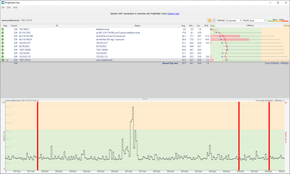

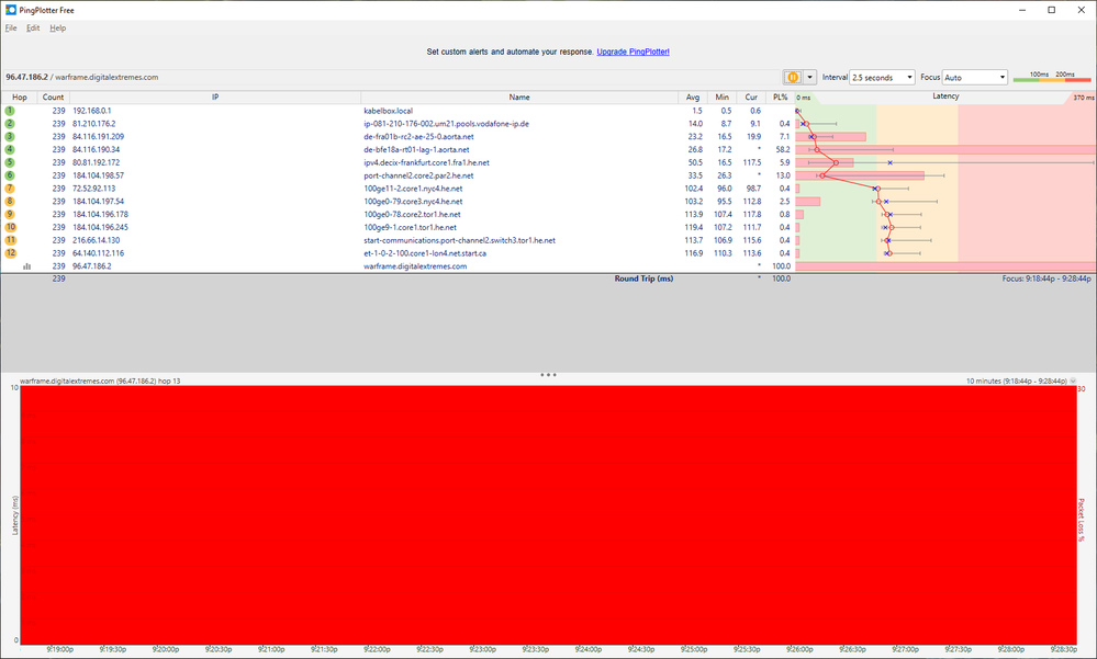

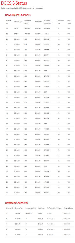

I have a problem with the cable internet. Starting from Tuesday, my internet keeps disconnecting every 10 minutes. Since I will have an important online interview in the middle of March, I do not want to have disconnections during the interview. Could anyone tell me how can I fix it?

  • Welcher Fehler tritt auf? (Geschwindigkeit zu gering; Packetloss) Schicke dazu auch Screenshots von Speedtests (mit Datum und Uhrzeit) und Tracerts/ Pingplotter-Messungen bei Packetloss oder Ping-Problemen
  • Pingplot to www.vodafone.dePingplot to www.vodafone.de
    pingplot to an online gamepingplot to an online game

    From Tuesday (22.02.2022), usually in evening.
  • Lade dazu noch einen Screenshot von den Signalwerten hoch. Diese findest Du in der Benutzeroberfläche Deines Kabelrouters über 192.168.0.1 bzw. über 192.168.178.1 bei der Fritzbox.DOCSIS StatusDOCSIS Status

Hello kckwan,
Thank you for your message. I have looked at your connection and some values are out of tolerance. That's why I have now created a technician ticket. This will now be forwarded to our technical service partner. They will first try to solve the problem remotely within the next 48 hours. If this is successful, you will receive a notification by SMS. If this was not possible remotely, a technician will contact you.
