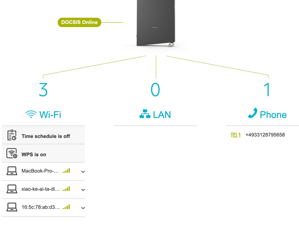

Hey Kieferer,
It's not the problem of my android phone, I'm a senior software developer. that's why I can dig so deep.
Thanks for provide the clue.
I think the problem comes from the router firmware, casue the WIFI not working properly.
I can eaily reproduce my issue via twitter or google translate. so I tried:
1. connect to LAN, issue gone
2. connect to SSID Homespot from same router, issue gone
3. connect to WIFI from a sub-router, issue gone
4. disable 2.5GHz or 5GHz in vodafone router , problem still happen
It makes me recall my last apartment, all tenants has a sub-router connect to Vodafone router(same model as mine), as the wifi from it is not reliable. I belive this is a known issue for a long time.
I require a full refund for the interet account, include the fee for turn device back.
I opened it 2 weeks ago, but takes half of the time troubleshooting and fix it. it cost me more than this vodafone account take.. My life shouldn't spend on a known issue.
