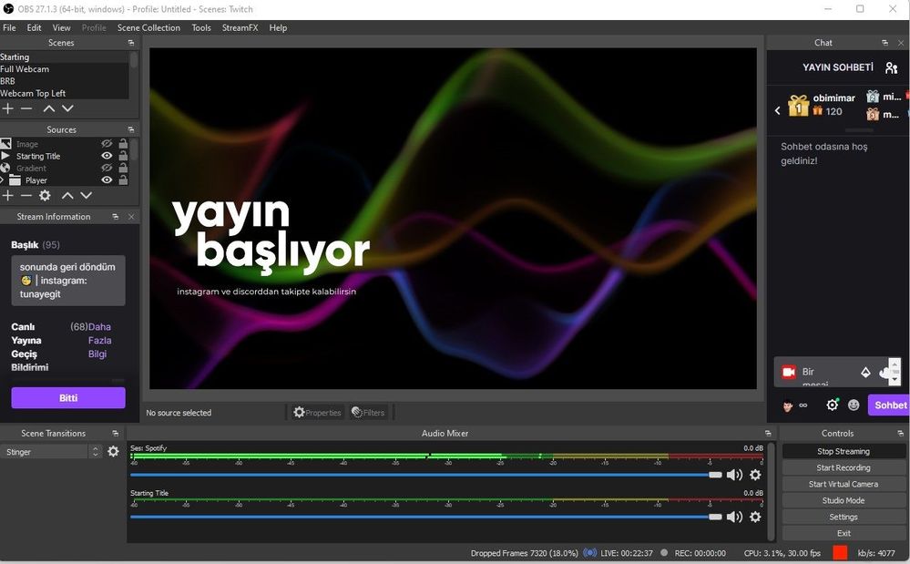

I've tried to stream to Youtube and Twitch. Both have the upload packet loss problem.
XijBggu
Twitch Inspector shows that I'm getting a lot of packet loss because the Quality (when it should be 100) is 0 on all servers near me. And the bandwidth should be 10000+kbps because I'm getting 40-50Mbps upload, but its only 3000-4000kbps.

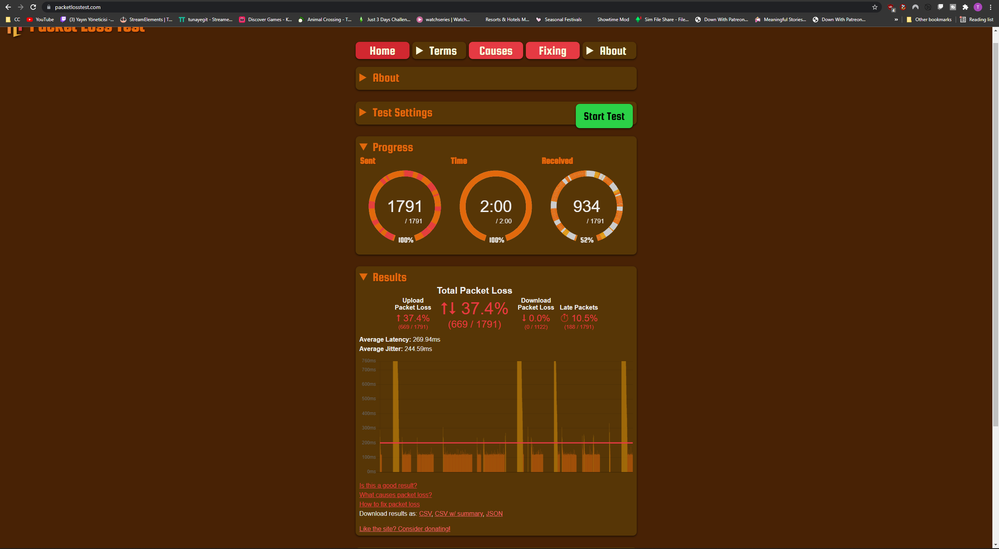

I tried the packet loss test also on my MacBook and iPad, its not as worse but its still present.

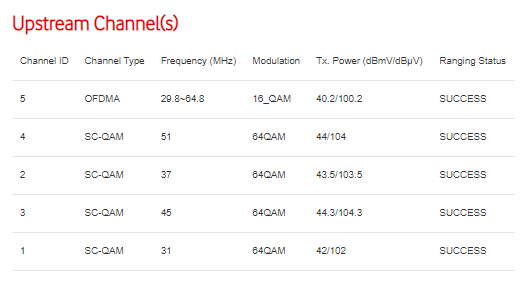

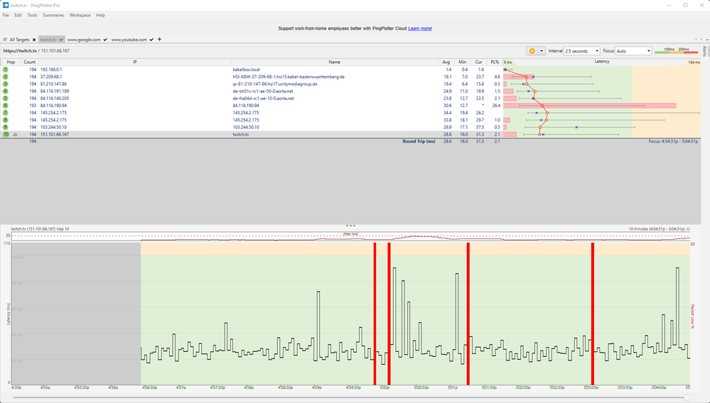

  • Welcher Fehler tritt auf? (Geschwindigkeit zu gering; Packetloss) Schicke dazu auch Screenshots von Speedtests (mit Datum und Uhrzeit) und Tracerts/ Pingplotter-Messungen bei Packetloss oder Ping-Problemen image.pngimage.pngimage.pngimage.png
