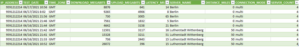

Regarding the speedtests I've carried out a few (cabled to port 1).

Here you can se the massive lag yesterday evening for different services:
- Gaming: League of Legends, World of Tanks, CS:GO (servers in EU)
- Steraming: My streaming service in Denmark (TDC/YouSee).
Tobias
Hey,
well, did you tried the bridgemode actually? The line looks fine for now.

The Line is still not fine. As you can see from Pingplotter, the MS spikes to crazy numbers during night. It's like this every night. And during the day/night sometimes the speed itself drops to below 10 mbits. That is unacceptable.
