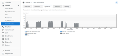

But it seems that i am receiving some signal through my coax connection when i check the "Spectrum" tab:
However, none of the signal that is being picked up is DOCSIS.

your Fritzbox does not receive a cable signal
this could be caused by a problem in your area or with your cable connection at your home
