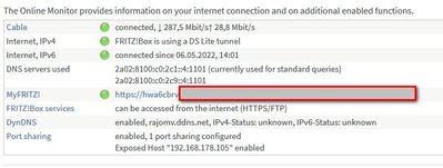

according to your screenshot IPv6 is enabled
but you have to use the NAS IPv6 address from external not the one from the Fritzbox
in general there is no port forwarding with IPv6, as already mentioned IPv6 works with port sharing

still, it's not resolved yet in my router, and I can't able to see my IPv6 address on my router
http://www.test-ipv6.com/http://www.test-ipv6.com/Fritzbox statusFritzbox statustechnical information of the networktechnical information of the network
