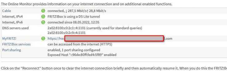

Now, i have enabled IPv6 on my NAS
but still, IPv6 is not assigned externally, not working externally
If you declare the NAS as IPv6 exposed host all ports are open for the NAS IPv6 Address
After the factory reset the router, now I can port forward using firtzbox services
but ipv6 is not enabled and no port forwarding can be done using IPv6
thanks
Raj
according to your screenshot IPv6 is enabled
but you have to use the NAS IPv6 address from external not the one from the Fritzbox
in general there is no port forwarding with IPv6, as already mentioned IPv6 works with port sharing
