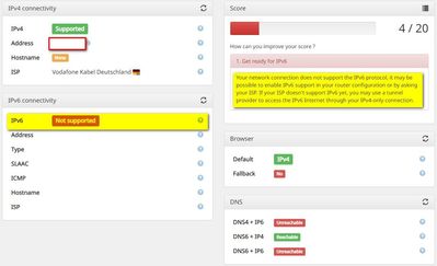

checked with https://ipv6-test.com/
it shows unsupported do we have any other options?
ipv6 test

still, it's not resolved yet in my router, and I can't able to see my IPv6 address on my router
http://www.test-ipv6.com/Fritzbox statustechnical information of the network

seems IPv6 is not enabled on the client PC
which OS are you using on the client?
