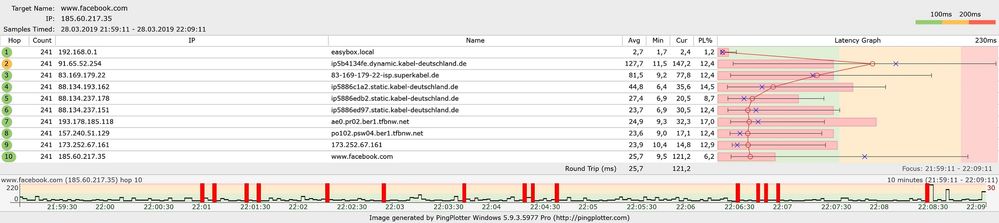

am 28.03.2019 22:13
am 01.04.2019 09:01
Hallo Vasya,
thanks for the screenshots.
Since the Packeloss is already at the 2nd Hop, I would like to exchange you the router. What do you say?
Best Regards, Manu
am 01.04.2019 09:35
Hi Manu,
If it will help, I would be very happy. What should I do to exchange it?
Best regards,
Vasya
