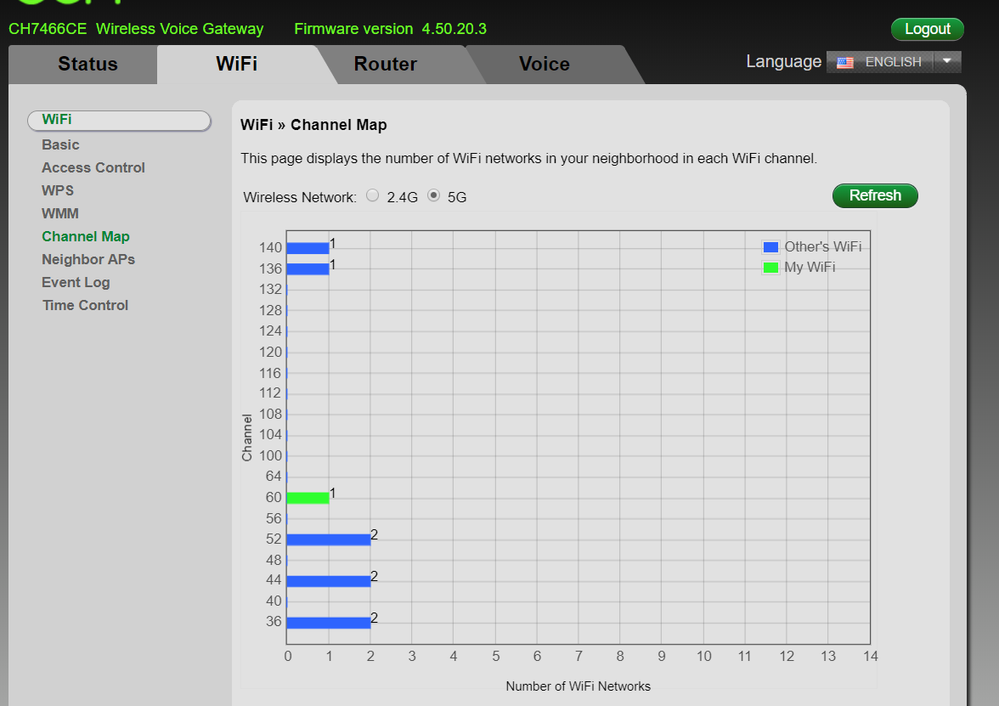

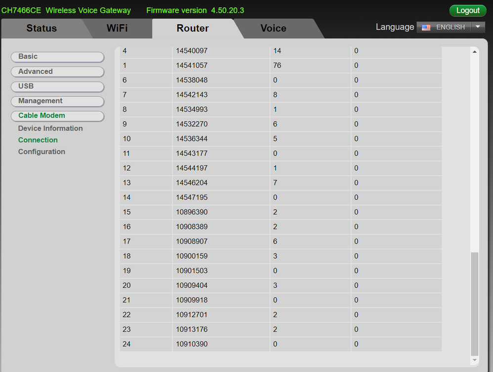

pksec
I have attached the screenshots of my router connection :
1. Channel information of both 2.4 Ghz and 5 Ghz
2. Cable Modem Signal Information
3. Cable Modem Config frequency
Changing cable modem frequency will help ? if so which number should I put in there? After my first post, my modem got restarted again - this time I was connected straight via Ethernet  = No internet also via Ethernet when the connection drops. So the modem is completely restarting not just the wifi module is restarted. 😞
