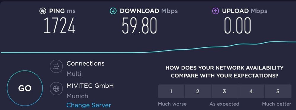

Yes, we have tried changing the connections as you suggest. The interemittent disconnects and slow speeds are still happening so: July 17, 2021 11:45AM.
Even without being "disconnected" this is an example of the speeds we are seeing:
Tobias
Hey,
so, is it a permanently problem, or just does it occur on times? The line looks okay, a few timeouts are there.
Regards
Tobias
DanLo
Well, things have been running good again since Saturday afternoon... so, for some reason, just Thursday to Saturday was terrible.
I would say no further action is needed at this point, thanks for the support.
