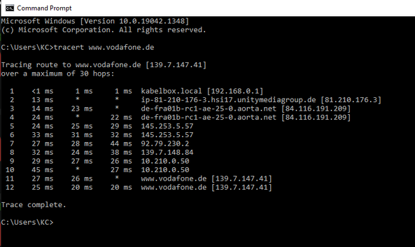

Hello, I have a problem with the cable internet. Starting from last Sunday, my internet keeps disconnecting. I tested the internet in many ways. I found that the upload speed is so low and there are so many packets lost. I cannot speak German so I did not call the hotline. Could anyone tell me how can I fix it?

  • Welcher Fehler tritt auf? (Geschwindigkeit zu gering; Packetloss) Schicke dazu auch Screenshots von Speedtests (mit Datum und Uhrzeit) und Tracerts/ Pingplotter-Messungen bei Packetloss oder Ping-Problemen
        Packetloss: 16% loss

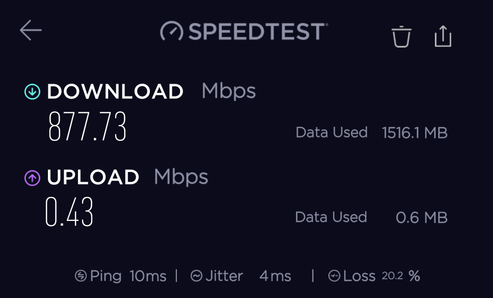

        Upload-Geschwindigkeit zu gering: 0.43 Mbps
SPEEDTEST 17:55 11.16.21

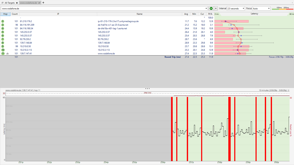

Ping zu www.vodafone.de. 16% loss
Tracert  zu www.vodafone.de

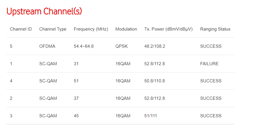

  • Lade dazu noch einen Screenshot von den Signalwerten hoch. Diese findest Du in der Benutzeroberfläche Deines Kabelrouters über 192.168.0.1 bzw. über 192.168.178.1 bei der Fritzbox.Signalwerten  20:14 16.11.2021

There is a malfunction on your connection line. We already know about this and working on it.
In this case, we only can beg for more patience.

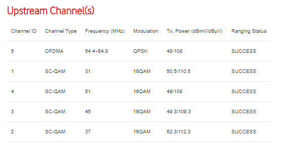

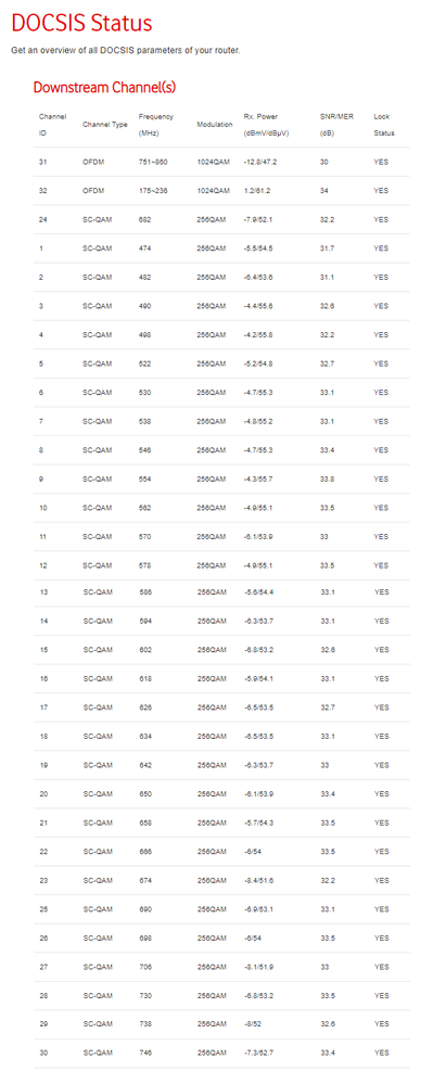

Here are some updated pictures at 15:00 19.11.2021 for the problem.new DOCSIS Status, 5 channels success

PingPlotter result
