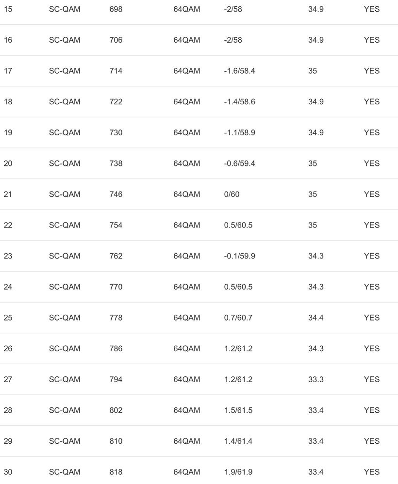

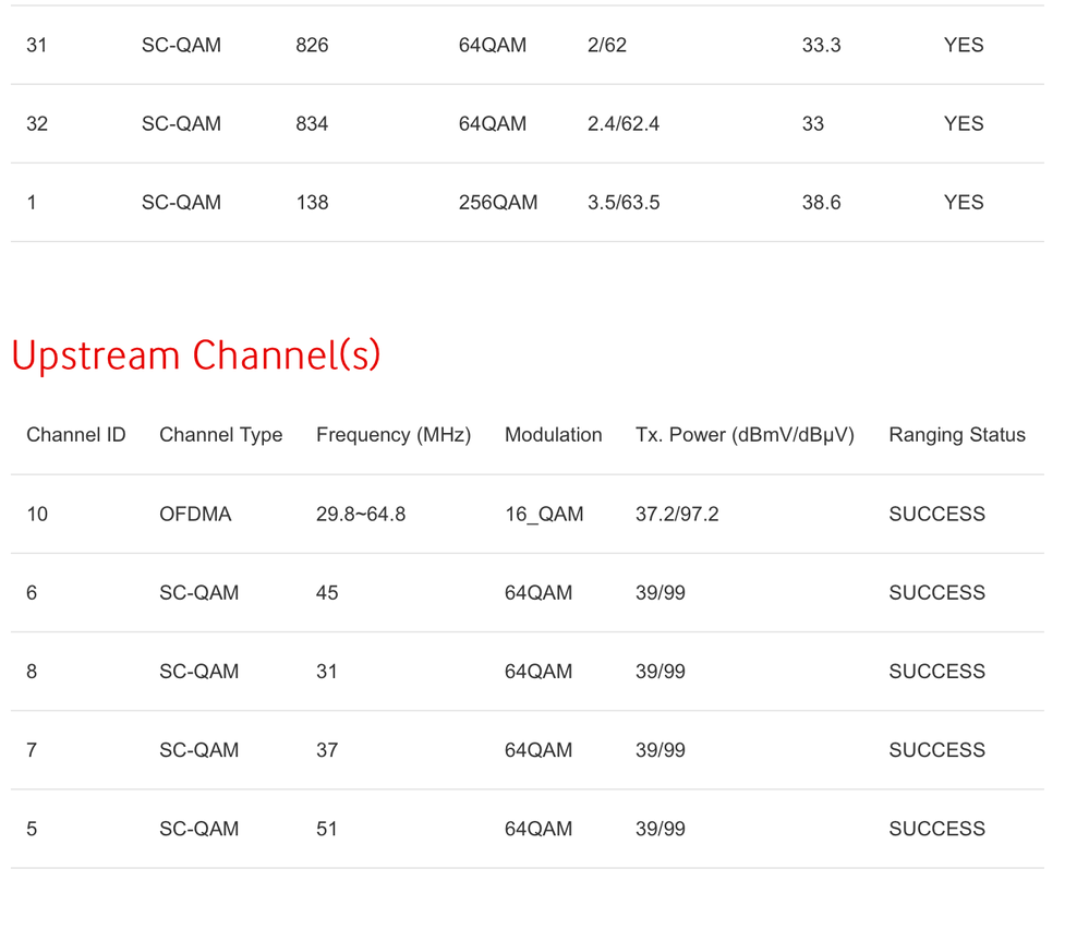

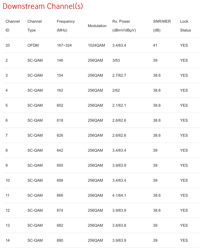

Status page:

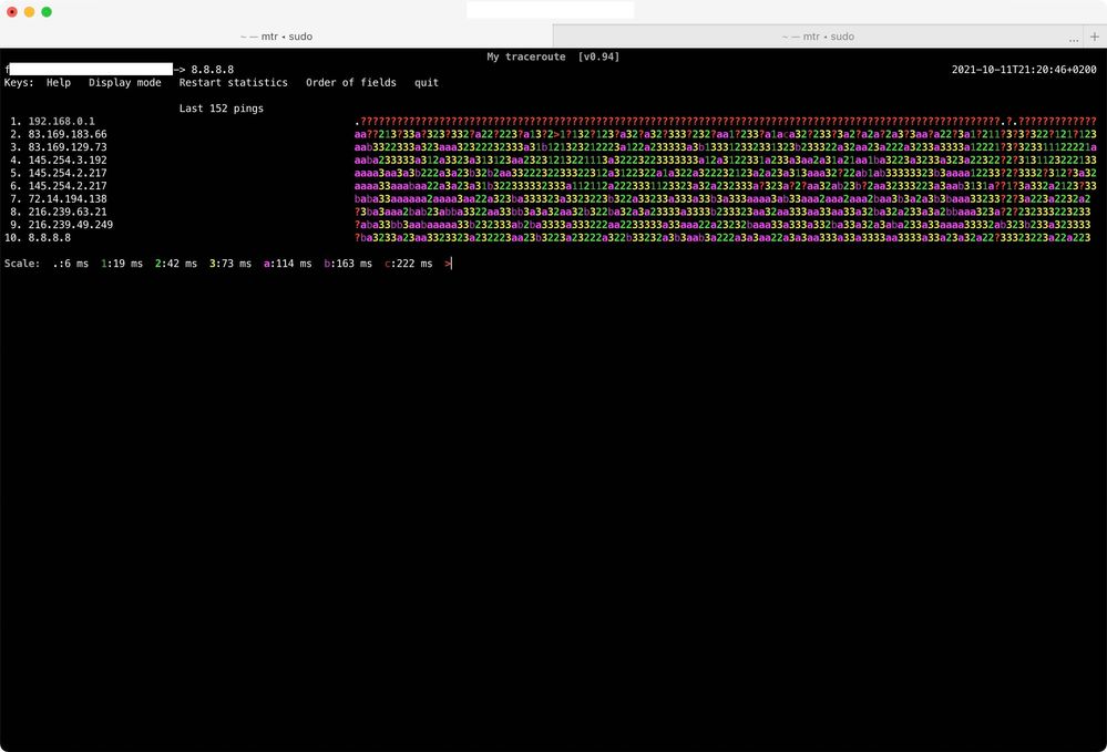

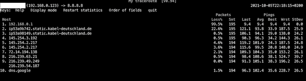

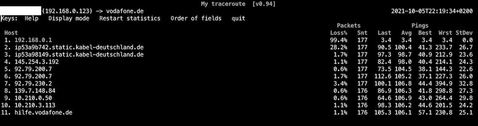

mtr results:

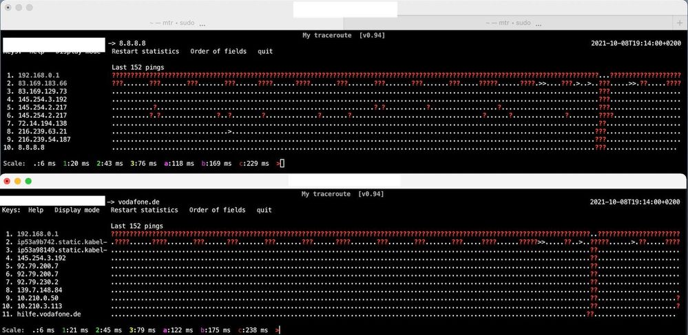

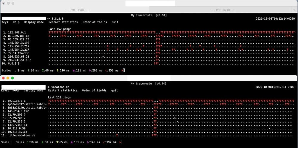

Hello,
Unfortunately it's still not perfect. I don't get constant 200ms+ pings anymore, but now I get spikes of packet losses anywhere beyond my router, which happen every couple of minutes and last for a second or two every time. This is a problem that seems to occur every couple of months, and I see my neighbours complaining about the same situation in the building's Facebook group, so it looks like it's a problem with the Vodafone equipment. I'll send you details in the PM, could something be done on a more permanent basis? With the current situation, having issues with work-related meetings for almost a week is very frustrating.

And now it's back to 100ms average pings immediately after the router and 2% packet loss. This forum page too 10 seconds to load.

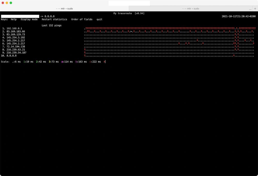

Hello technocoreai,
please send a Pingplotter you made through an ethernet connection. Use one of the services you noticed the packetloss with as the destination and set the interval to 2.5 seconds.

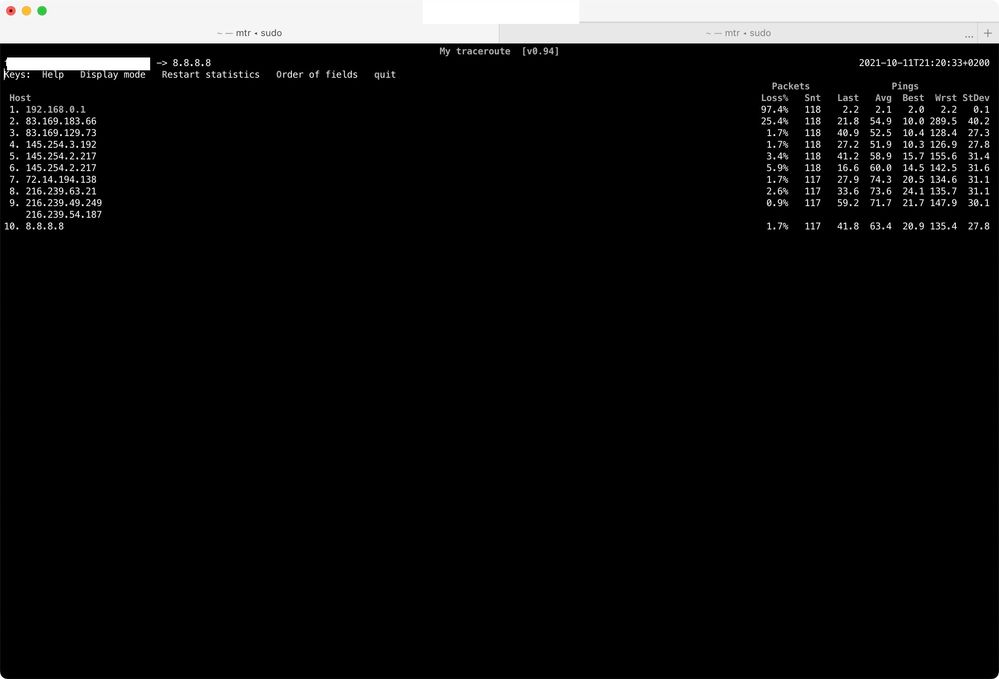

Hi,
I usually check that this is not my Wifi by running the same ping with my access point. My neighbours are also not using my connection, so it's definitely not it.
I've done the same via Ethernet directly to the Vodafone router, same results (even worse today because the pings are back). I've also set the interval to 2.5 seconds as you've requested, this unfortunately makes the full outage spikes less noticeable, but you can still see vertical lines of "?" characters sometimes. The terrible pings are back today, as you can see.
