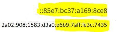

Please see the screenshot of my router.

Check if the server is configured to use the IPv6 privacy extensions - in this case, the IPv6 from your system will change erratically very often and thus will not allow any external connections.
IPv6 privacy extensions need to be disabled in order to get IPv6 servers to function properly (as well as for the Firewall in die FritzBox as that one calculates the IPv6 based from the MAC address).
interface ID from your screenshot is different from IPv6 AAAA record
as @reneromann already wrote this coud be caused by privacy extensions which needs to be disabled on your webserver
