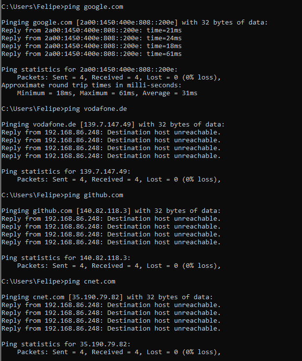

But today I decided to connect my desktop with cable, instead of using the wifi connection. And I notice a lot of problems when attempting to connect to some specific webpages.
Example, when connecting to websites which are using ipv6, they work as normal, but when a website is still in ipv4, I am always getting the ERR_ADDRESS_UNREACHABLE.
I ran a ping in my windows machine just to exemplify the problem, as you can see, even vodafone.de is unreachable for me when connected by cable.

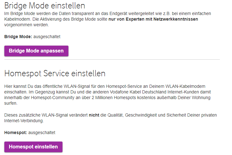

I did what you suggested, after 7 days, I logged in the panel to see if the bridge mode was turn off and it was.
I just attempted to execute the same tests that I did before, running ping + domain to see if it was working and the same problem is still happening. I turn off my modem just to ensure that it was some kind of configuration that was missing but I am still having issues to connect to ipv4 domains.

Hello FelipeUmpierre,
according to the survey, brigdemode is still off. Can you please turn it on.
