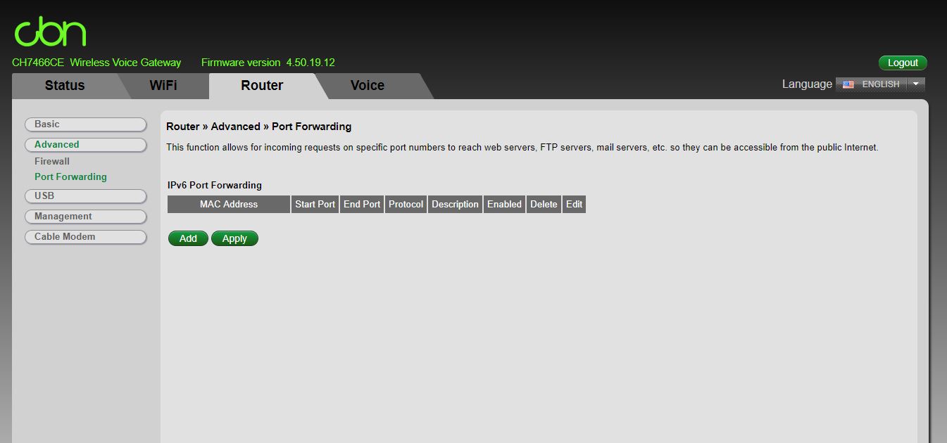

I'm using since a few years Vodafone Kabel internet with the Compal CH7466CE router.
Some days ago I installed a Raspberry Pi and would like to connect to it's SSH port from outside my home, but, unfortunately, I couldn't find the option inside my router's web interface to forward the ports. I have just IPv6 port forwarding but no IPv4..

IPv4-Port forwarding is not possible anymore. Your have probably a contract with a shared IPv4-address(cgnat).
So you should use IPv6 instead.

I try to setup it with my Raspberry PI MAC address but the port still closed...

I have configured IPv6 on my raspbery PI and I can access it over SSH but just localy.. I have intsalled FTP sevrer on my PC just for test, its working too, but from outside not. 😞
Can You pleace explain what I doing wrong? Do I have to put something in the router (Firewall is disabled)?
