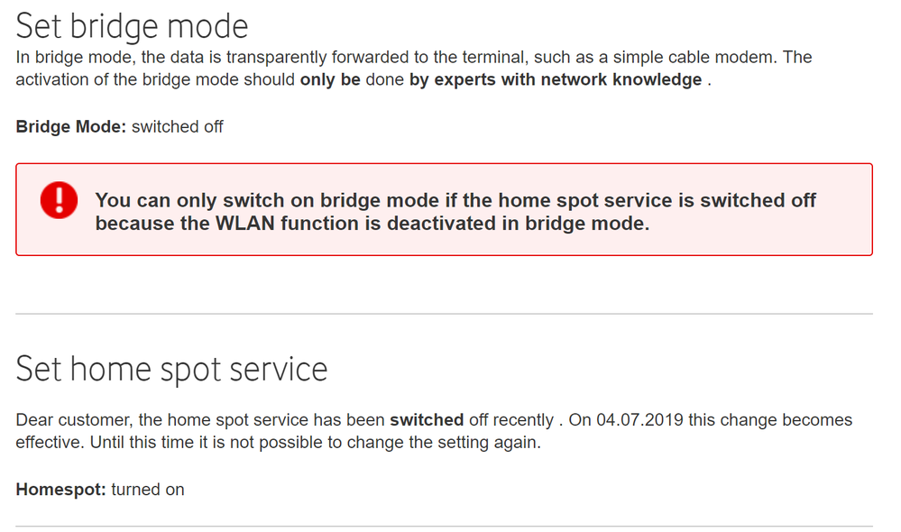

luping
where is the bridge mode option? the router setup menus can't found the option.  whether should i need to configure a wifi router behind the CH7466CE if it is caused by the reason? thank you attention.
Hello,
you can find the Bridge-Mode option on my vodafone portal, but you need to disable wifi option before you can enable Bridge-Mode.
Yes you need your own router, because after you have enabled BM the CH7466CE acts as a modem.
Tobias

luping
do i have to wait 7 day to test the bridge mode when i turn off the homespot?
pRo-Marco
Hey luping,
yeah, that's the time needed to deactivate the option Smiley (traurig)
