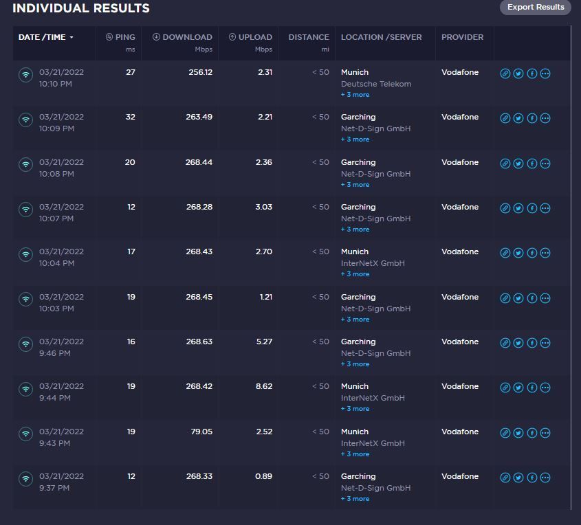

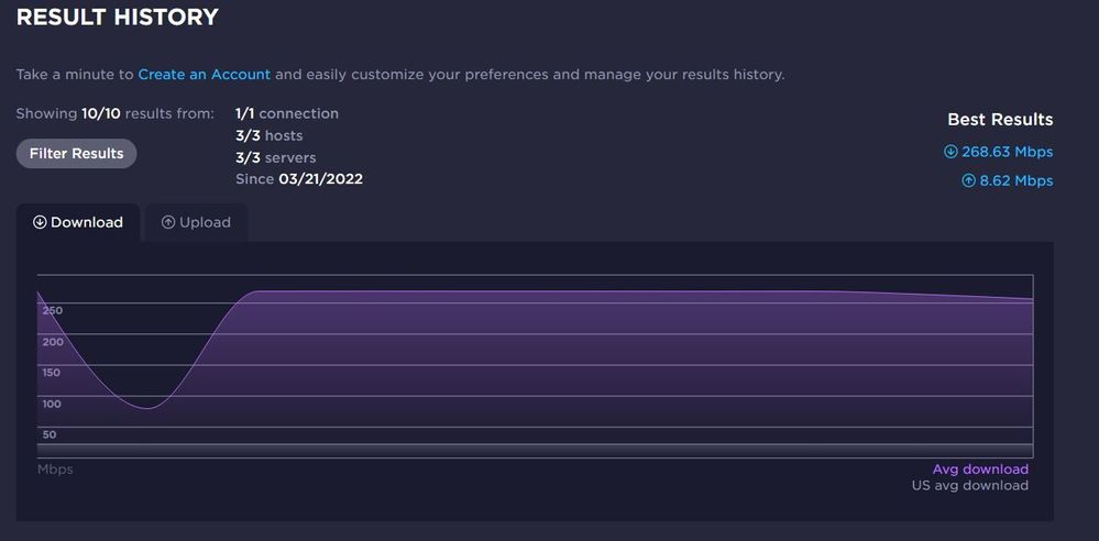

Many thanks for the detailed instructions. I have uploaded the result of the tests. Other desired information is as follows,

It looks like your upload is disturbed, recognizable by the difference between single- and multi-mode. Usually this is the case when the OFDMA channel is active and not working properly or the levels in the upstream are out of the standard.

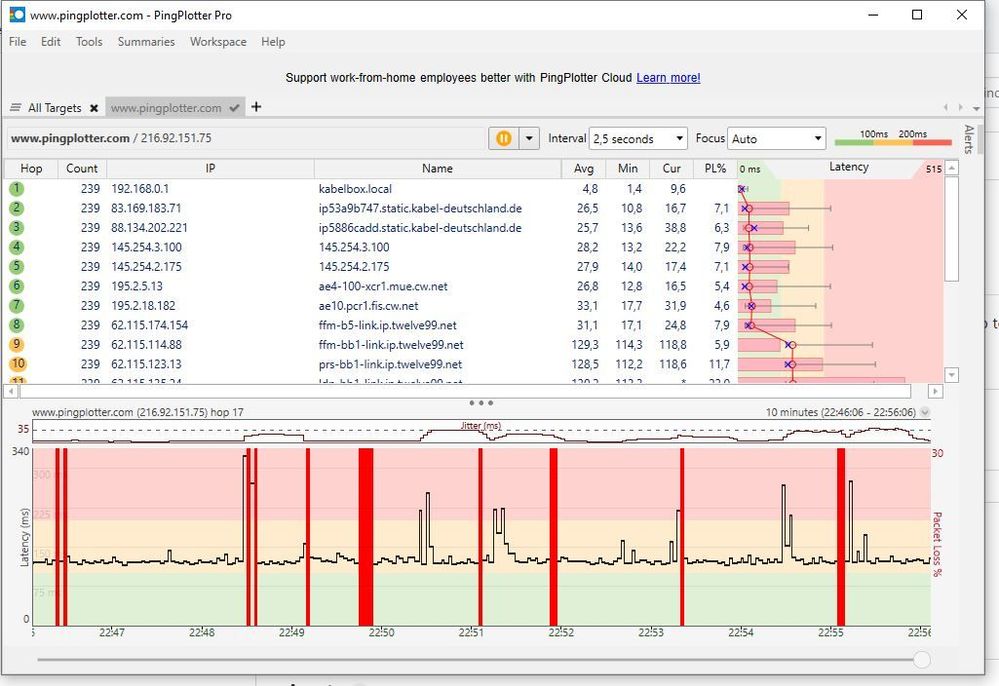

The Pingtracer has some optical quirks, but it records more than 10 minutes.
Enter heise.de as the destination and leave the settings as in my first post. With the "Screen down" button you can view the history.

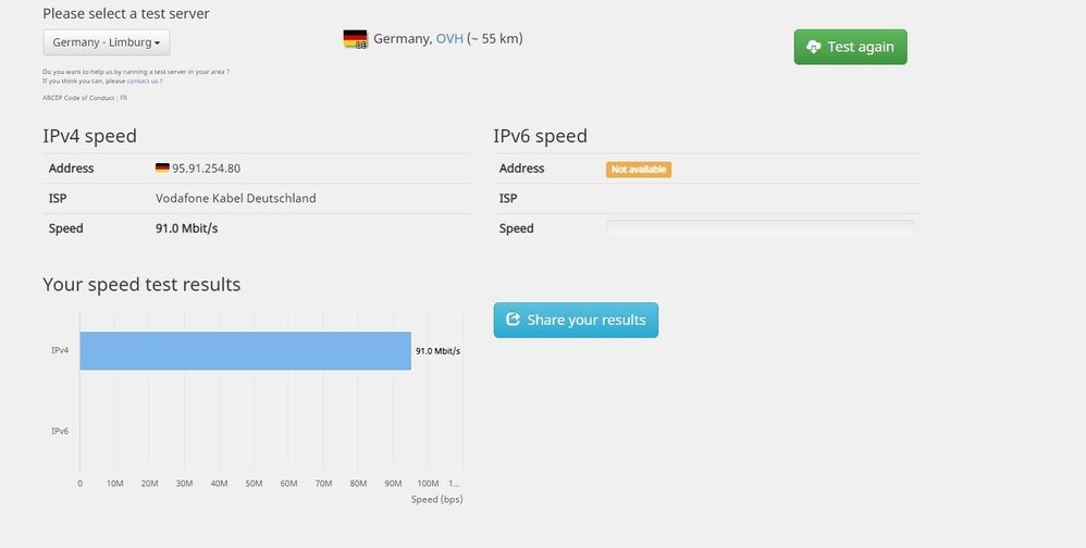

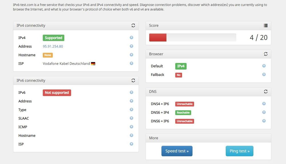

Your connection must have an IPv6 address. VF must solve this.
Please also post ipconfig from console/terminal
