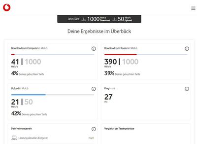

Since moving in a new place our internet connection does not even reach 10% of the supposed 1000 Mbit/s stated in the contract (CableMax 1000). The Vodafone Speed Map states that the 1000 Mbit/s is available at my new address.
During the day there are speeds of max. 50 Mbit/s and in the evening it`s even worse, no matter if I connect wireless or wired (multiple LAN Cables and also I have tried different coaxial cables from wall socket to router) there is no improvement.
This is annoying since I work in Homeoffice and I get a lot of interuptions hence I cannot do my work as I should.
As per speedtests from vodafone (https://speedtest.vodafone.de/) the connection to the router (from vodafone servers) reaches around 500 Mbit/s, but to my end device (laptop / phone / tv) no more than 50 Mbit/s

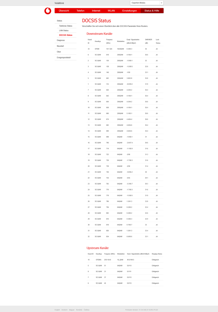

Da solltest du die Hotline anrufen. Die Pegel sind ganz und gar nicht ok so das einige Kanäle nicht eingebucht werden.

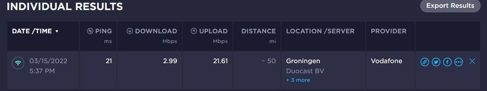

New speedtests from today
Speedtests sind sinnlos da dein Pegel ganz weit weg ist. Du brauchst einen Techniker der nachpegelt.

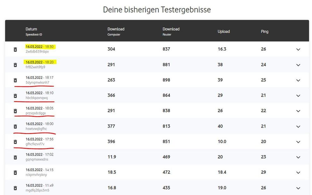

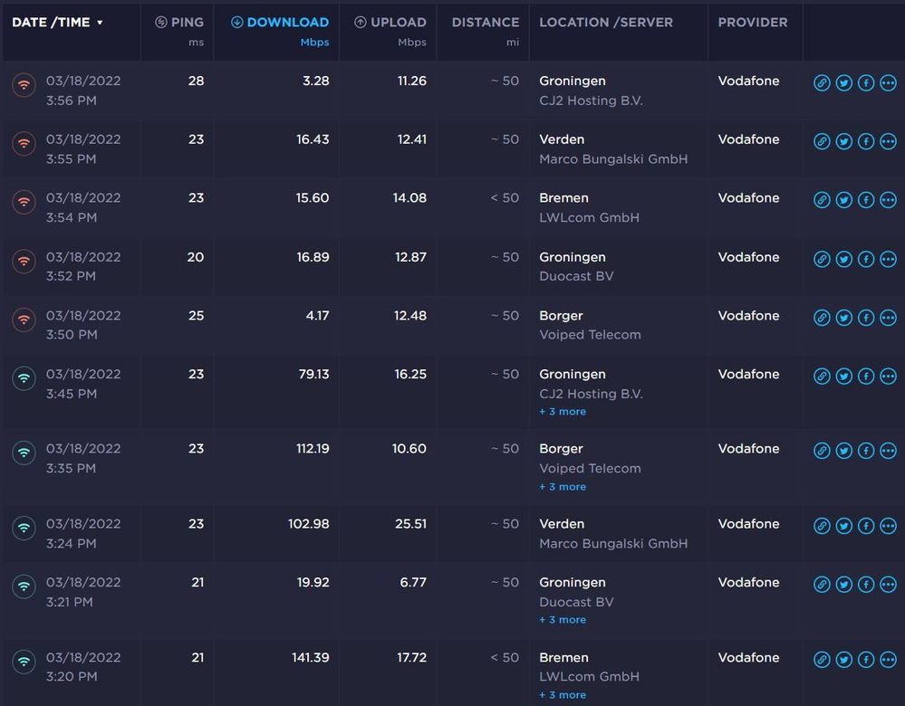

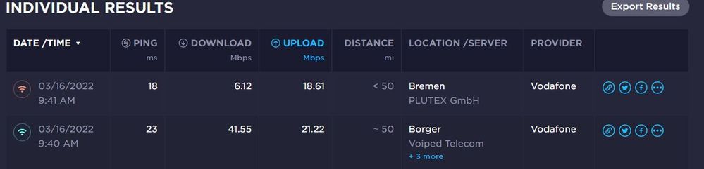

But the maximal speed is still not even close to be reached even if the download is improved a lot as before:
red underlined results are reached with LAN
yellow highlighted results are reached via WLAN 5 GHz
the 3 results from bottom are the results obtained prior to the tech guy improvements
This might be a problem of the router or can it be something else ?

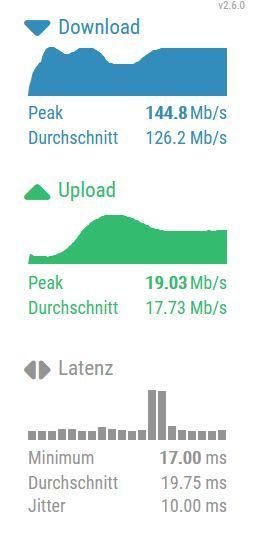

So, the problem seems to not be totally fixed, a few days after the technician visit the internet speed has increased but it is still not as stable as it should.
During the day I`m getting interruptions and getting kicked out of Teams meetings and calls which is really not acceptable.

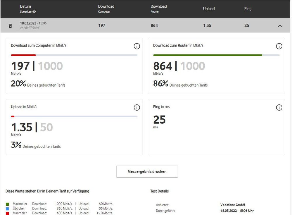

As in the below screenshot, my speeds are not even close to the ones stated in my contract and this is getting very annoying.speedtest.JPG
Sometimes I cannot even watch a movie on streaming services because of the continous buffering

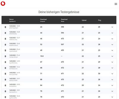

AdiR89
More speedtests from different providers to highlight the issue:
Deine Upstream Pegel sind nicht ok. Der OFDM SNR sieht auch nicht gut aus und einige SNR auch grenzwertig. Siehe hier die Vorgaben:
1024QAM (DOCSIS 3.1)
Liegt die Modulation des Downstreamkanals bei 1024QAM, so ist der Wert „MSE“ mit 6 dB höher als 256QAM und damit wie folgt zu bewerten:
• 0,0 bis -36,0 dB: sofortige Beseitigung
• -36,1 bis -38,0 dB: Beseitigung binnen Monatsfrist
• -38,1 bis -39,0 dB: tolerierte Abweichung
• < -39,0 dB: regel- / vorgabenkonform
