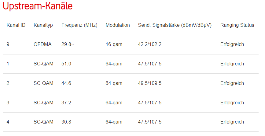

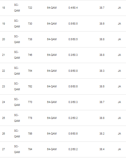

nilsja
Downstream Pegel 1Downstream Pegel 2Downstream Pegel 3Downstream Pegel 4Upstream Pegel 1
