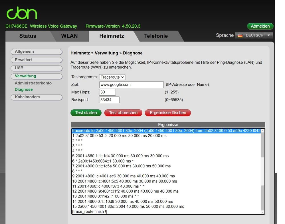

Mit dem neuen Kabelmodem habe ich mal einen Traceroute-Test in Richtung google gemacht.
Hier das Ergebnis:
traceroute to 142.250.186.131 (142.250.186.131) from 31.17.11.66, 30 hops max, 38 byte packets
1 31.17.11.253 20.000 ms 31.17.11.252 30.000 ms *
2 83.169.155.250 20.000 ms * *
3 * 145.254.3.58 60.000 ms 145.254.3.122 20.000 ms
4 145.254.2.215 20.000 ms 145.254.2.217 70.000 ms *
5 * * 72.14.194.138 30.000 ms
6 * * *
7 108.170.253.49 30.000 ms 209.85.251.130 30.000 ms 216.239.54.180 30.000 ms
8 108.170.253.34 50.000 ms 108.170.253.50 30.000 ms 108.170.253.84 30.000 ms
9 216.239.57.7 40.000 ms 60.000 ms 216.239.54.171 40.000 ms
10 142.250.238.156 30.000 ms 30.000 ms 142.250.238.154 30.000 ms
11 216.239.56.130 50.000 ms 209.85.241.145 40.000 ms *
12 209.85.252.28 40.000 ms 108.170.236.248 40.000 ms 60.000 ms
13 108.170.252.1 40.000 ms 60.000 ms 40.000 ms
14 142.250.214.197 40.000 ms 70.000 ms 142.250.214.195 40.000 ms
15 142.250.186.131 40.000 ms 60.000 ms 40.000 ms
[trace_route finish !]
