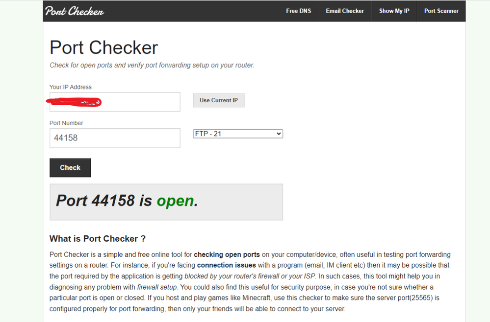

Hi Guys , I insttaled kabel internet fewsays ago with fritzbox 6600. I did all required ways to open port 44158 in TCP protocol with IPV4 but all time I see that port still close or the settings I do opening another port .
-- I reserved the local IPV4 to my device then to "pirmit access" to make port sharing as shown in totorials but what I see that port 44158 still closed and port 58024 is open.
any idea how to solve the problem?

just wanted to add my feedback about that issuw minsioned qbove, after a phone call with technical suppport they offered me a free real static IPV4 address and from the router settings I shared the port 44158 and now it's open successfully
