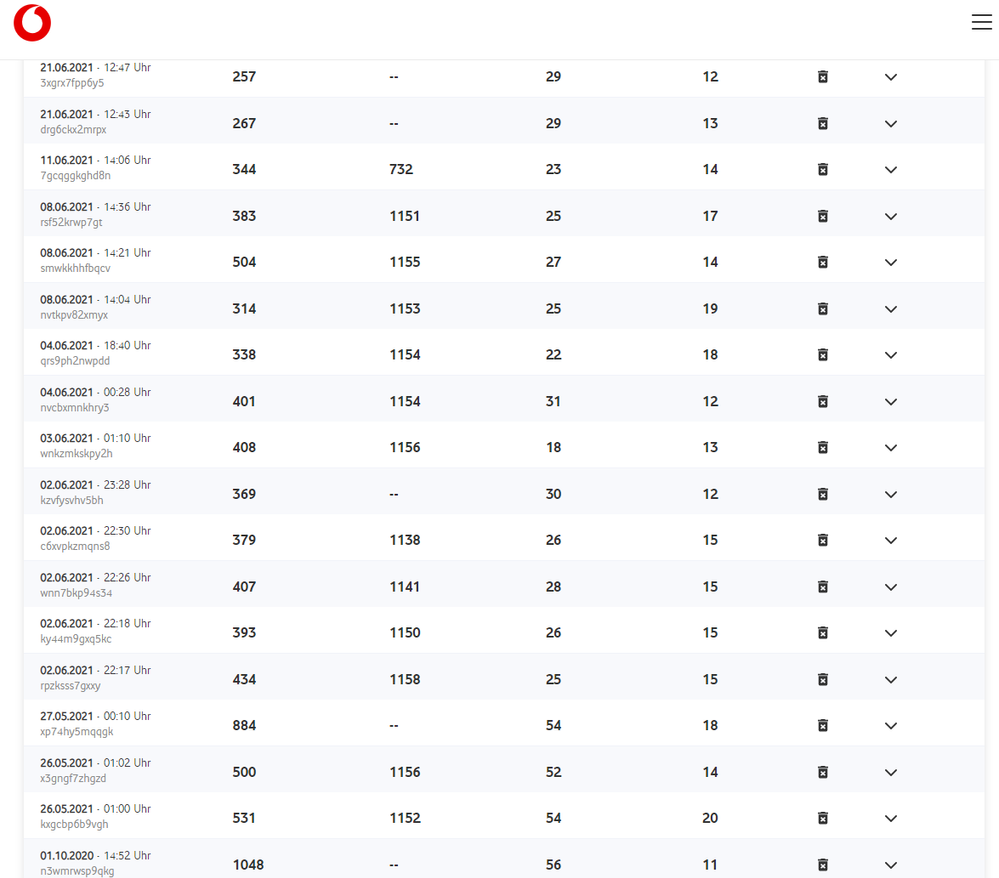

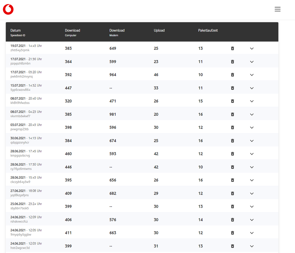

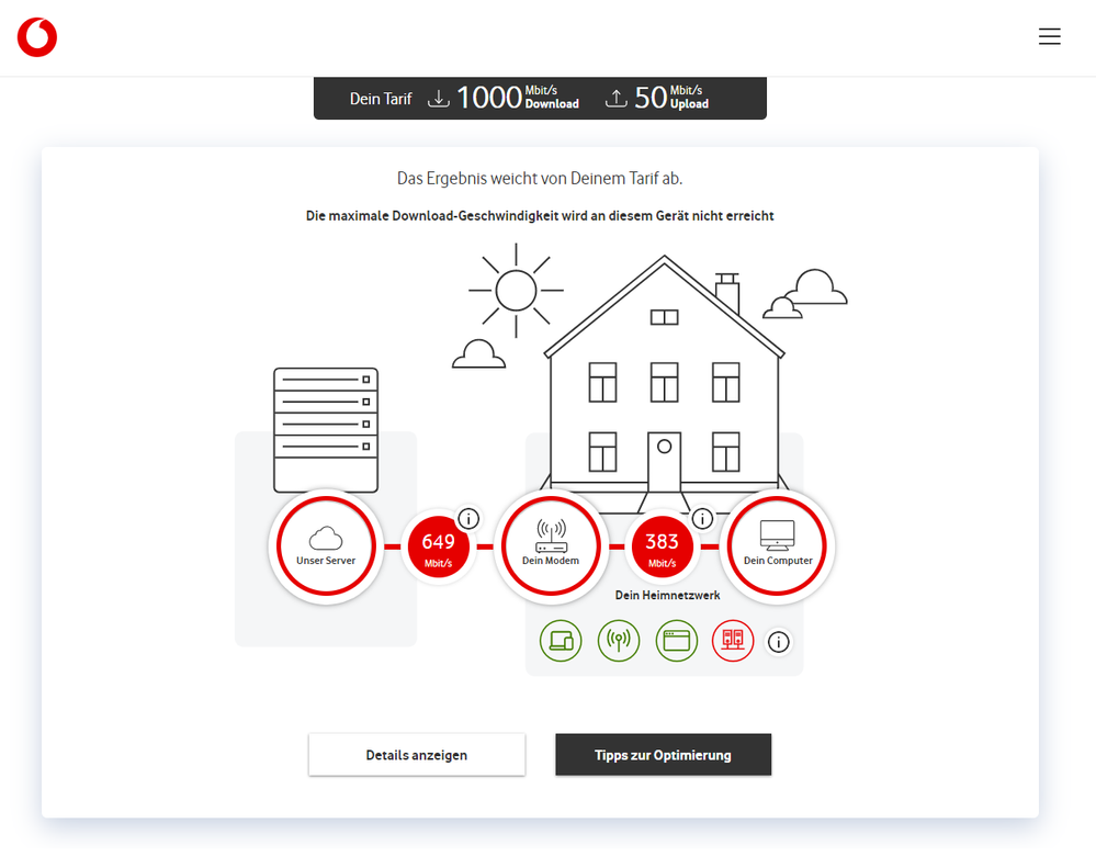

Screenshot 2021-07-19 144509.pngScreenshot 2021-07-19 144557.pngScreenshot 2021-07-19 144618.png
