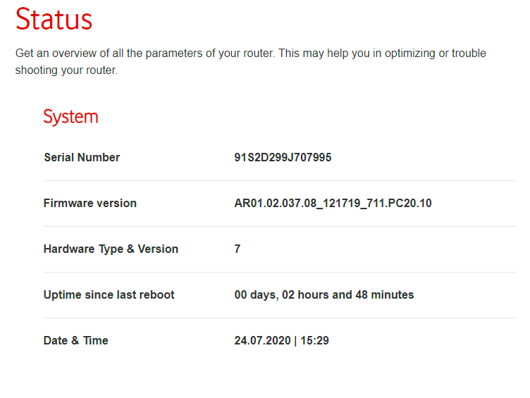

    • I didn't understand exactly which page I should screenshot, as there are no "signal values" page and I can't find anything similar on my router. So to avoid posting sensitive data, I'll only post the status of the router system:Annotation 2020-07-24 153048.png

Hello GabrielDuarteM,
the values at the modem are very bad. We must hire a technician to check this on site. Can you please ensure access to the house distribution system? Is there any current Covid-19 disease in your household?

Martin59
I've just completed the job and sent it to the tech guys. They will contact you to arrange a new appointment.
