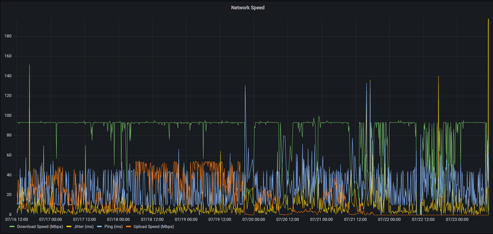

Ever since Covid broke I have been forced to work from home along with my partner, and it's getting to the point where both of our jobs are in danger as a result of the atrocious connection. Every single morning it cuts out during the morning stand up, and it's a regular occurence for the internet to be down for several hours at a time. You simply cannot work with this.
So, time is up, Vodafone has had almost 2 years to fix their issues but have not (or can not) and I would like a contract cancellation as soon as possible please.
Below you can find my internet connection data for the last week plotted out on a graph. The script used to collect the data was run on an interval of every 10 minutes. You can clearly see long periods of down time, with huge amounts of ping and jitter, along with upload speeds at a bare minimum.  Your key for the graph is in the bottom-left. If you have any questions, feel free to ask. But please let me know the next steps for the cancellation.

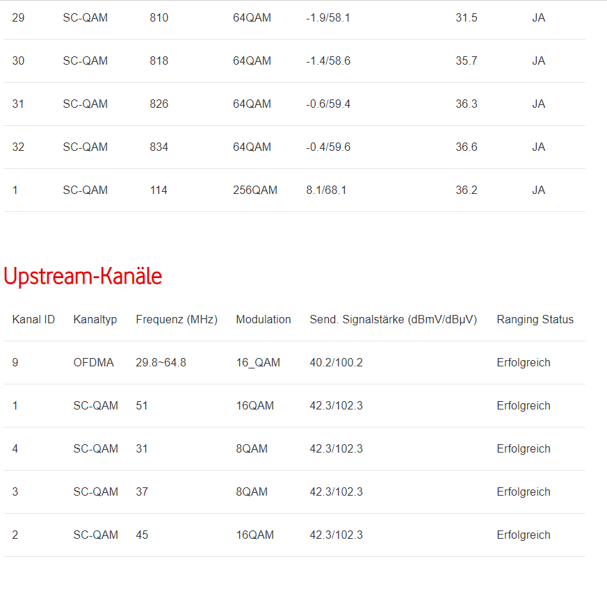

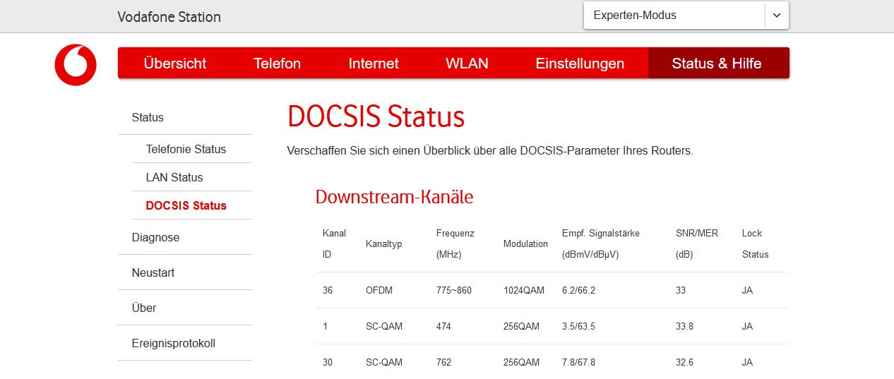

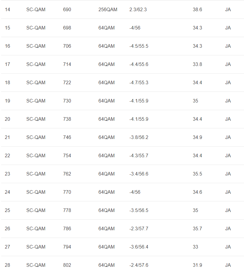

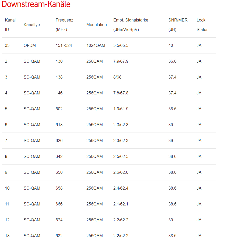

You can find the signal levels in the Vodafone station at the same point as in the photo in the appendix.
Please take a screenshot of all channels and post it here.
Ok, thanks for the photo guide.
The modulation of the upload channels indicates a return channel interferer. The technology will have to look for it, but it can unfortunately take a very long time to find it because it can be any connection in the entire segment (which can possibly have 1000 customers and more). And when it is found, the technician on site must also have access to the house system, which delays the rectification again.
