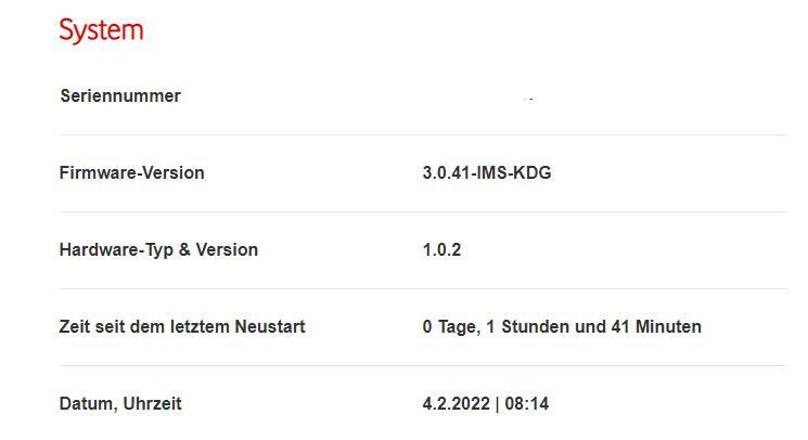

am 04.02.2022 08:17
02/04/2022 07:57:02 [10000003]: UTOPIA: Service Blocked DROP Firewall 02/04/2022 07:57:00 [10000004]: UTOPIA: Device Blocked DROP Firewall 02/04/2022 06:57:06 [10000008]: UTOPIA: FW.IPv6 FORWARD drop Firewall 02/04/2022 06:57:04 [10000007]: UTOPIA: FW.IPv6 INPUT drop Firewall 02/04/2022 06:35:19 [88000205]: k0_SSID Interface Reset ,Link is Down.WLAN 02/04/2022 06:35:19 [88000205]: k1_SSID Interface Reset ,Link is Down.WLAN 01/24/2022 21:01:54 [88000205]: k0_SSID Interface Reset ,Link is Up.WLAN
Ausfälle bleiben nicht aus.
