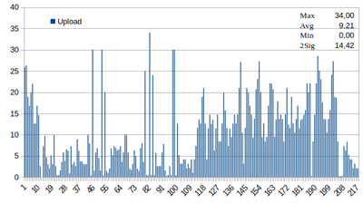

ok ich habe mal ein dieagram erstellt wie gewünscht.
fals ich was falsch gemacht habe hier noch mal die daten in klartext
Mehr anzeigen

[ 4] 0,00-1,01 sec 3,12 MBytes 25,9 Mbits/sec
[ 4] 1,01-2,01 sec 3,12 MBytes 26,3 Mbits/sec
[ 4] 2,01-3,01 sec 2,25 MBytes 18,9 Mbits/sec
[ 4] 3,01-4,01 sec 2,00 MBytes 16,8 Mbits/sec
[ 4] 4,01-5,01 sec 2,38 MBytes 19,9 Mbits/sec
[ 4] 5,01-6,01 sec 2,62 MBytes 22,0 Mbits/sec
[ 4] 6,01-7,01 sec 1,50 MBytes 12,6 Mbits/sec
[ 4] 7,01-8,01 sec 1,50 MBytes 12,6 Mbits/sec
[ 4] 8,01-9,00 sec 2,00 MBytes 16,8 Mbits/sec
[ 4] 9,00-10,01 sec 1,75 MBytes 14,6 Mbits/sec
[ 4] 10,01-11,00 sec 1,50 MBytes 12,6 Mbits/sec
[ 4] 11,00-12,00 sec 2,38 MBytes 20,0 Mbits/sec
[ 4] 12,00-13,00 sec 3,25 MBytes 27,3 Mbits/sec
[ 4] 13,00-14,01 sec 2,38 MBytes 19,7 Mbits/sec
[ 4] 14,01-15,01 sec 1,75 MBytes 14,7 Mbits/sec
[ 4] 15,01-16,01 sec 2,75 MBytes 23,1 Mbits/sec
[ 4] 16,01-17,01 sec 2,62 MBytes 22,1 Mbits/sec
[ 4] 17,01-18,01 sec 3,00 MBytes 25,1 Mbits/sec
[ 4] 18,01-19,01 sec 2,75 MBytes 23,1 Mbits/sec
[ 4] 19,01-20,01 sec 2,38 MBytes 19,9 Mbits/sec
[ 4] 20,01-21,01 sec 1,50 MBytes 12,6 Mbits/sec
[ 4] 21,01-22,01 sec 1,00 MBytes 8,40 Mbits/sec
[ 4] 22,01-23,01 sec 1,12 MBytes 9,47 Mbits/sec
[ 4] 23,01-24,00 sec 1,38 MBytes 11,6 Mbits/sec
[ 4] 24,00-25,00 sec 1,62 MBytes 13,6 Mbits/sec
[ 4] 25,00-26,00 sec 1,88 MBytes 15,8 Mbits/sec
[ 4] 26,00-27,01 sec 2,88 MBytes 23,8 Mbits/sec
[ 4] 27,01-28,00 sec 3,12 MBytes 26,5 Mbits/sec
[ 4] 28,00-29,01 sec 3,12 MBytes 26,2 Mbits/sec
[ 4] 29,01-30,01 sec 2,50 MBytes 20,9 Mbits/sec
[ 4] 30,01-31,01 sec 3,25 MBytes 27,3 Mbits/sec
[ 4] 31,01-32,01 sec 2,75 MBytes 23,0 Mbits/sec
[ 4] 32,01-33,01 sec 1,62 MBytes 13,6 Mbits/sec
[ 4] 33,01-34,01 sec 1,50 MBytes 12,6 Mbits/sec
[ 4] 34,01-35,01 sec 2,25 MBytes 18,9 Mbits/sec
[ 4] 35,01-36,01 sec 3,12 MBytes 26,2 Mbits/sec
[ 4] 36,01-37,01 sec 1,62 MBytes 13,7 Mbits/sec
[ 4] 37,01-38,00 sec 1,62 MBytes 13,7 Mbits/sec
[ 4] 38,00-39,00 sec 2,75 MBytes 23,1 Mbits/sec
[ 4] 39,00-40,01 sec 2,75 MBytes 23,0 Mbits/sec
[ 4] 40,01-41,00 sec 2,75 MBytes 23,1 Mbits/sec
[ 4] 41,00-42,00 sec 2,38 MBytes 19,9 Mbits/sec
[ 4] 42,00-43,00 sec 2,12 MBytes 17,9 Mbits/sec
[ 4] 43,00-44,00 sec 1,12 MBytes 9,41 Mbits/sec
[ 4] 44,00-45,00 sec 768 KBytes 6,30 Mbits/sec
[ 4] 45,00-46,01 sec 1,38 MBytes 11,5 Mbits/sec
[ 4] 46,01-47,00 sec 1,88 MBytes 15,8 Mbits/sec
[ 4] 47,00-48,00 sec 2,00 MBytes 16,8 Mbits/sec
[ 4] 48,00-49,01 sec 1,75 MBytes 14,5 Mbits/sec
[ 4] 49,01-50,01 sec 1,38 MBytes 11,6 Mbits/sec
[ 4] 50,01-51,01 sec 768 KBytes 6,30 Mbits/sec
[ 4] 51,01-52,01 sec 1,00 MBytes 8,40 Mbits/sec
[ 4] 52,01-53,01 sec 512 KBytes 4,20 Mbits/sec
[ 4] 53,01-54,01 sec 1,38 MBytes 11,5 Mbits/sec
[ 4] 54,01-55,00 sec 2,50 MBytes 21,0 Mbits/sec
[ 4] 55,00-56,00 sec 2,62 MBytes 22,0 Mbits/sec
[ 4] 56,00-57,00 sec 2,00 MBytes 16,8 Mbits/sec
[ 4] 57,00-58,00 sec 3,00 MBytes 25,2 Mbits/sec
[ 4] 58,00-59,00 sec 3,25 MBytes 27,3 Mbits/sec
[ 4] 59,00-60,01 sec 3,25 MBytes 26,9 Mbits/sec
[ 4] 60,01-61,01 sec 3,12 MBytes 26,3 Mbits/sec
[ 4] 61,01-62,00 sec 3,12 MBytes 26,5 Mbits/sec
[ 4] 62,00-63,00 sec 3,25 MBytes 27,3 Mbits/sec
[ 4] 63,00-64,01 sec 1,62 MBytes 13,6 Mbits/sec
[ 4] 64,01-65,00 sec 1,88 MBytes 15,8 Mbits/sec
[ 4] 65,00-66,00 sec 2,38 MBytes 19,9 Mbits/sec
[ 4] 66,00-67,00 sec 2,38 MBytes 19,9 Mbits/sec
[ 4] 67,00-68,00 sec 1,88 MBytes 15,8 Mbits/sec
[ 4] 68,00-69,00 sec 2,62 MBytes 22,0 Mbits/sec
[ 4] 69,00-70,01 sec 2,62 MBytes 21,7 Mbits/sec
[ 4] 70,01-71,01 sec 2,75 MBytes 23,1 Mbits/sec
[ 4] 71,01-72,01 sec 3,12 MBytes 26,3 Mbits/sec
[ 4] 72,01-73,01 sec 3,00 MBytes 25,0 Mbits/sec
[ 4] 73,01-74,01 sec 2,62 MBytes 22,0 Mbits/sec
[ 4] 74,01-75,01 sec 1,38 MBytes 11,5 Mbits/sec
[ 4] 75,01-76,01 sec 2,00 MBytes 16,8 Mbits/sec
[ 4] 76,01-77,00 sec 2,12 MBytes 18,0 Mbits/sec
[ 4] 77,00-78,01 sec 1,62 MBytes 13,6 Mbits/sec
[ 4] 78,01-79,01 sec 640 KBytes 5,25 Mbits/sec
[ 4] 79,01-80,01 sec 1,12 MBytes 9,44 Mbits/sec
[ 4] 80,01-81,00 sec 1,00 MBytes 8,42 Mbits/sec
[ 4] 81,00-82,00 sec 896 KBytes 7,34 Mbits/sec
[ 4] 82,00-83,00 sec 1,25 MBytes 10,5 Mbits/sec
[ 4] 83,00-84,01 sec 896 KBytes 7,24 Mbits/sec
[ 4] 84,01-85,01 sec 1,25 MBytes 10,5 Mbits/sec
[ 4] 85,01-86,01 sec 1,88 MBytes 15,7 Mbits/sec
[ 4] 86,01-87,01 sec 1,50 MBytes 12,6 Mbits/sec
[ 4] 87,01-88,01 sec 1,50 MBytes 12,6 Mbits/sec
[ 4] 88,01-89,01 sec 1,50 MBytes 12,6 Mbits/sec
[ 4] 89,01-90,00 sec 1,88 MBytes 15,8 Mbits/sec
[ 4] 90,00-91,00 sec 2,12 MBytes 17,8 Mbits/sec
[ 4] 91,00-92,00 sec 1,38 MBytes 11,6 Mbits/sec
[ 4] 92,00-93,02 sec 1,12 MBytes 9,31 Mbits/sec
[ 4] 93,02-94,01 sec 1,12 MBytes 9,47 Mbits/sec
[ 4] 94,01-95,01 sec 1,50 MBytes 12,6 Mbits/sec
[ 4] 95,01-96,01 sec 1,00 MBytes 8,41 Mbits/sec
[ 4] 96,01-97,01 sec 768 KBytes 6,30 Mbits/sec
[ 4] 97,01-98,00 sec 768 KBytes 6,30 Mbits/sec
[ 4] 98,00-99,00 sec 1,12 MBytes 9,45 Mbits/sec
[ 4] 99,00-100,00 sec 1,50 MBytes 12,6 Mbits/sec
[ 4] 100,00-101,02 sec 640 KBytes 5,18 Mbits/sec
[ 4] 101,02-102,01 sec 384 KBytes 3,15 Mbits/sec
[ 4] 102,01-103,01 sec 384 KBytes 3,15 Mbits/sec
[ 4] 103,01-104,01 sec 512 KBytes 4,20 Mbits/sec
[ 4] 104,01-105,01 sec 512 KBytes 4,20 Mbits/sec
[ 4] 105,01-106,01 sec 256 KBytes 2,10 Mbits/sec
[ 4] 106,01-107,00 sec 384 KBytes 3,15 Mbits/sec
[ 4] 107,00-108,00 sec 256 KBytes 2,10 Mbits/sec
[ 4] 108,00-109,00 sec 512 KBytes 4,21 Mbits/sec
[ 4] 109,00-110,01 sec 128 KBytes 1,03 Mbits/sec
[ 4] 110,01-111,01 sec 512 KBytes 4,20 Mbits/sec
[ 4] 111,01-112,01 sec 896 KBytes 7,35 Mbits/sec
[ 4] 112,01-113,01 sec 1,38 MBytes 11,6 Mbits/sec
[ 4] 113,01-114,01 sec 1,62 MBytes 13,6 Mbits/sec
[ 4] 114,01-115,01 sec 1,50 MBytes 12,6 Mbits/sec
[ 4] 115,01-116,01 sec 2,25 MBytes 18,9 Mbits/sec
[ 4] 116,01-117,01 sec 2,50 MBytes 21,0 Mbits/sec
[ 4] 117,01-118,00 sec 1,50 MBytes 12,6 Mbits/sec
[ 4] 118,00-119,00 sec 512 KBytes 4,20 Mbits/sec
[ 4] 119,00-120,00 sec 1,38 MBytes 11,5 Mbits/sec
[ 4] 120,00-121,00 sec 1,75 MBytes 14,7 Mbits/sec
[ 4] 121,00-122,00 sec 1,50 MBytes 12,5 Mbits/sec
[ 4] 122,00-123,01 sec 1,62 MBytes 13,5 Mbits/sec
[ 4] 123,01-124,01 sec 768 KBytes 6,30 Mbits/sec
[ 4] 124,01-125,01 sec 1,38 MBytes 11,5 Mbits/sec

[ 4] 649,00-650,00 sec 1,00 MBytes 8,39 Mbits/sec
[ 4] 650,00-651,00 sec 1,75 MBytes 14,7 Mbits/sec
[ 4] 651,00-652,01 sec 1,12 MBytes 9,31 Mbits/sec
[ 4] 652,01-653,01 sec 1,12 MBytes 9,46 Mbits/sec
[ 4] 653,01-654,01 sec 1,62 MBytes 13,6 Mbits/sec
[ 4] 654,01-655,01 sec 1,38 MBytes 11,6 Mbits/sec
[ 4] 655,01-656,01 sec 2,12 MBytes 17,9 Mbits/sec
[ 4] 656,01-657,00 sec 2,50 MBytes 21,0 Mbits/sec
[ 4] 657,00-658,00 sec 2,25 MBytes 18,9 Mbits/sec
[ 4] 658,00-659,00 sec 1,75 MBytes 14,7 Mbits/sec
[ 4] 659,00-660,02 sec 896 KBytes 7,23 Mbits/sec
[ 4] 660,02-661,01 sec 384 KBytes 3,15 Mbits/sec
[ 4] 661,01-662,01 sec 128 KBytes 1,05 Mbits/sec
[ 4] 662,01-663,01 sec 256 KBytes 2,10 Mbits/sec
[ 4] 663,01-664,01 sec 512 KBytes 4,20 Mbits/sec
[ 4] 664,01-665,00 sec 384 KBytes 3,16 Mbits/sec
[ 4] 665,00-666,00 sec 256 KBytes 2,10 Mbits/sec
[ 4] 666,00-667,00 sec 256 KBytes 2,10 Mbits/sec
[ 4] 667,00-668,00 sec 128 KBytes 1,05 Mbits/sec
[ 4] 668,00-669,00 sec 256 KBytes 2,09 Mbits/sec
[ 4] 669,00-670,00 sec 768 KBytes 6,30 Mbits/sec
[ 4] 670,00-671,00 sec 1,75 MBytes 14,7 Mbits/sec
[ 4] 671,00-672,01 sec 2,75 MBytes 22,8 Mbits/sec
[ 4] 672,01-673,01 sec 3,25 MBytes 27,4 Mbits/sec
[ 4] 673,01-674,01 sec 3,25 MBytes 27,3 Mbits/sec
[ 4] 674,01-675,01 sec 1,12 MBytes 9,47 Mbits/sec
[ 4] 675,01-676,00 sec 2,00 MBytes 16,8 Mbits/sec
[ 4] 676,00-677,00 sec 1,00 MBytes 8,41 Mbits/sec
[ 4] 677,00-678,01 sec 1,25 MBytes 10,3 Mbits/sec
[ 4] 678,01-679,01 sec 1,62 MBytes 13,6 Mbits/sec
[ 4] 679,01-680,01 sec 2,00 MBytes 16,8 Mbits/sec
[ 4] 680,01-681,01 sec 1,50 MBytes 12,6 Mbits/sec
[ 4] 681,01-682,01 sec 1,25 MBytes 10,5 Mbits/sec
[ 4] 682,01-683,01 sec 1,38 MBytes 11,5 Mbits/sec
[ 4] 683,01-684,00 sec 2,38 MBytes 20,1 Mbits/sec
[ 4] 684,00-685,01 sec 1,88 MBytes 15,6 Mbits/sec
[ 4] 685,01-686,01 sec 2,12 MBytes 17,8 Mbits/sec
[ 4] 686,01-687,01 sec 1,38 MBytes 11,5 Mbits/sec
[ 4] 687,01-688,01 sec 1,50 MBytes 12,6 Mbits/sec
[ 4] 688,01-689,00 sec 2,12 MBytes 17,9 Mbits/sec
[ 4] 689,00-690,00 sec 2,12 MBytes 17,9 Mbits/sec
[ 4] 690,00-691,00 sec 1,88 MBytes 15,7 Mbits/sec
[ 4] 691,00-692,00 sec 2,88 MBytes 24,1 Mbits/sec
[ 4] 692,00-693,00 sec 2,88 MBytes 24,1 Mbits/sec
[ 4] 693,00-694,01 sec 3,25 MBytes 27,0 Mbits/sec
[ 4] 694,01-695,01 sec 2,25 MBytes 18,9 Mbits/sec
[ 4] 695,01-696,01 sec 640 KBytes 5,24 Mbits/sec
[ 4] 696,01-697,01 sec 640 KBytes 5,26 Mbits/sec
[ 4] 697,01-698,01 sec 896 KBytes 7,31 Mbits/sec
[ 4] 698,01-699,01 sec 1,12 MBytes 9,46 Mbits/sec
[ 4] 699,01-700,01 sec 1,38 MBytes 11,5 Mbits/sec
[ 4] 700,01-701,01 sec 1,50 MBytes 12,6 Mbits/sec
[ 4] 701,01-702,00 sec 1,12 MBytes 9,46 Mbits/sec
[ 4] 702,00-703,00 sec 1,50 MBytes 12,6 Mbits/sec
[ 4] 703,00-704,00 sec 2,25 MBytes 18,9 Mbits/sec
[ 4] 704,00-705,00 sec 3,00 MBytes 25,2 Mbits/sec
[ 4] 705,00-706,00 sec 1,12 MBytes 9,41 Mbits/sec
[ 4] 706,00-707,01 sec 1,50 MBytes 12,5 Mbits/sec
[ 4] 707,01-708,01 sec 2,38 MBytes 19,9 Mbits/sec
[ 4] 708,01-709,01 sec 3,00 MBytes 25,2 Mbits/sec
[ 4] 709,01-710,01 sec 2,38 MBytes 19,9 Mbits/sec
[ 4] 710,01-711,01 sec 1,50 MBytes 12,6 Mbits/sec
[ 4] 711,01-712,01 sec 384 KBytes 3,15 Mbits/sec
[ 4] 712,01-713,00 sec 1,00 MBytes 8,42 Mbits/sec
[ 4] 713,00-714,00 sec 1,50 MBytes 12,6 Mbits/sec
[ 4] 714,00-715,02 sec 384 KBytes 3,10 Mbits/sec
[ 4] 715,02-716,02 sec 1,12 MBytes 9,44 Mbits/sec
[ 4] 716,02-717,01 sec 1,00 MBytes 8,41 Mbits/sec
[ 4] 717,01-718,01 sec 1,25 MBytes 10,5 Mbits/sec
[ 4] 718,01-719,01 sec 1,38 MBytes 11,6 Mbits/sec
[ 4] 719,01-720,00 sec 1,62 MBytes 13,7 Mbits/sec
[ 4] 720,00-721,00 sec 1,12 MBytes 9,44 Mbits/sec
[ 4] 721,00-722,00 sec 768 KBytes 6,30 Mbits/sec
[ 4] 722,00-723,02 sec 640 KBytes 5,17 Mbits/sec
[ 4] 723,02-724,01 sec 1,00 MBytes 8,39 Mbits/sec
[ 4] 724,01-725,01 sec 1,00 MBytes 8,40 Mbits/sec
[ 4] 725,01-726,01 sec 896 KBytes 7,37 Mbits/sec
[ 4] 726,01-727,01 sec 768 KBytes 6,28 Mbits/sec
[ 4] 727,01-728,01 sec 896 KBytes 7,36 Mbits/sec
[ 4] 728,01-729,01 sec 1,62 MBytes 13,6 Mbits/sec
[ 4] 729,01-730,01 sec 2,00 MBytes 16,8 Mbits/sec
[ 4] 730,01-731,01 sec 2,00 MBytes 16,8 Mbits/sec
[ 4] 731,01-732,00 sec 2,25 MBytes 18,9 Mbits/sec
[ 4] 732,00-733,00 sec 896 KBytes 7,35 Mbits/sec
[ 4] 733,00-734,00 sec 640 KBytes 5,24 Mbits/sec
[ 4] 734,00-735,00 sec 640 KBytes 5,25 Mbits/sec
[ 4] 735,00-736,00 sec 1,00 MBytes 8,40 Mbits/sec
[ 4] 736,00-737,00 sec 768 KBytes 6,29 Mbits/sec
[ 4] 737,00-738,01 sec 384 KBytes 3,11 Mbits/sec
[ 4] 738,01-739,01 sec 640 KBytes 5,25 Mbits/sec
[ 4] 739,01-740,01 sec 1,00 MBytes 8,40 Mbits/sec
[ 4] 740,01-741,01 sec 1,12 MBytes 9,45 Mbits/sec
[ 4] 741,01-742,01 sec 1,12 MBytes 9,45 Mbits/sec
[ 4] 742,01-743,00 sec 384 KBytes 3,16 Mbits/sec
[ 4] 743,00-744,00 sec 384 KBytes 3,14 Mbits/sec
[ 4] 744,00-745,00 sec 512 KBytes 4,21 Mbits/sec
[ 4] 745,00-746,00 sec 896 KBytes 7,34 Mbits/sec
[ 4] 746,00-747,01 sec 768 KBytes 6,21 Mbits/sec
[ 4] 747,01-748,01 sec 768 KBytes 6,30 Mbits/sec
[ 4] 748,01-749,01 sec 768 KBytes 6,30 Mbits/sec
[ 4] 749,01-750,01 sec 896 KBytes 7,36 Mbits/sec
[ 4] 750,01-751,01 sec 384 KBytes 3,15 Mbits/sec
[ 4] 751,01-752,01 sec 256 KBytes 2,10 Mbits/sec
[ 4] 752,01-753,00 sec 512 KBytes 4,20 Mbits/sec
[ 4] 753,00-754,00 sec 640 KBytes 5,24 Mbits/sec
[ 4] 754,00-755,00 sec 640 KBytes 5,25 Mbits/sec
[ 4] 755,00-756,00 sec 896 KBytes 7,35 Mbits/sec
[ 4] 756,00-757,00 sec 384 KBytes 3,15 Mbits/sec
[ 4] 757,00-758,01 sec 384 KBytes 3,11 Mbits/sec
[ 4] 758,01-759,01 sec 256 KBytes 2,10 Mbits/sec
[ 4] 759,01-760,01 sec 384 KBytes 3,16 Mbits/sec
[ 4] 760,01-761,00 sec 256 KBytes 2,10 Mbits/sec
[ 4] 761,00-762,00 sec 384 KBytes 3,15 Mbits/sec
[ 4] 762,00-763,00 sec 384 KBytes 3,15 Mbits/sec
[ 4] 763,00-764,01 sec 896 KBytes 7,29 Mbits/sec
[ 4] 764,01-765,01 sec 512 KBytes 4,18 Mbits/sec
[ 4] 765,01-766,01 sec 1,00 MBytes 8,40 Mbits/sec
[ 4] 766,01-767,01 sec 1,00 MBytes 8,41 Mbits/sec
[ 4] 767,01-768,00 sec 896 KBytes 7,35 Mbits/sec
[ 4] 768,00-769,00 sec 896 KBytes 7,35 Mbits/sec
[ 4] 769,00-770,00 sec 1,00 MBytes 8,38 Mbits/sec
[ 4] 770,00-771,00 sec 1,00 MBytes 8,39 Mbits/sec
[ 4] 771,00-772,02 sec 768 KBytes 6,22 Mbits/sec
[ 4] 772,02-773,01 sec 512 KBytes 4,20 Mbits/sec
[ 4] 773,01-774,01 sec 640 KBytes 5,24 Mbits/sec
[ 4] 774,01-775,01 sec 512 KBytes 4,20 Mbits/sec
[ 4] 775,01-776,01 sec 768 KBytes 6,29 Mbits/sec
[ 4] 776,01-777,01 sec 384 KBytes 3,15 Mbits/sec
[ 4] 777,01-778,00 sec 640 KBytes 5,27 Mbits/sec
[ 4] 778,00-779,01 sec 512 KBytes 4,19 Mbits/sec
[ 4] 779,01-780,00 sec 384 KBytes 3,15 Mbits/sec
[ 4] 780,00-781,00 sec 512 KBytes 4,21 Mbits/sec
[ 4] 781,00-782,00 sec 640 KBytes 5,25 Mbits/sec
[ 4] 782,00-783,01 sec 640 KBytes 5,17 Mbits/sec
[ 4] 783,01-784,01 sec 1,00 MBytes 8,39 Mbits/sec
[ 4] 784,01-785,01 sec 768 KBytes 6,29 Mbits/sec
[ 4] 785,01-786,01 sec 640 KBytes 5,26 Mbits/sec
[ 4] 786,01-787,01 sec 512 KBytes 4,19 Mbits/sec
[ 4] 787,01-788,01 sec 640 KBytes 5,25 Mbits/sec
[ 4] 788,01-789,01 sec 512 KBytes 4,21 Mbits/sec
[ 4] 789,01-790,00 sec 768 KBytes 6,30 Mbits/sec
[ 4] 790,00-791,00 sec 896 KBytes 7,36 Mbits/sec
[ 4] 791,00-792,00 sec 1,25 MBytes 10,5 Mbits/sec
[ 4] 792,00-793,01 sec 1,62 MBytes 13,4 Mbits/sec
[ 4] 793,01-794,01 sec 2,50 MBytes 21,0 Mbits/sec
[ 4] 794,01-795,00 sec 2,88 MBytes 24,3 Mbits/sec
[ 4] 795,00-796,01 sec 3,00 MBytes 25,0 Mbits/sec
[ 4] 796,01-797,01 sec 2,75 MBytes 23,1 Mbits/sec
[ 4] 797,01-798,01 sec 1,75 MBytes 14,7 Mbits/sec
[ 4] 798,01-799,01 sec 1,38 MBytes 11,6 Mbits/sec
[ 4] 799,01-800,00 sec 2,00 MBytes 16,8 Mbits/sec
[ 4] 800,00-801,02 sec 1,25 MBytes 10,4 Mbits/sec
[ 4] 801,02-802,01 sec 128 KBytes 1,05 Mbits/sec
[ 4] 802,01-803,01 sec 256 KBytes 2,10 Mbits/sec
[ 4] 803,01-804,01 sec 512 KBytes 4,21 Mbits/sec
[ 4] 804,01-805,01 sec 384 KBytes 3,15 Mbits/sec
[ 4] 805,01-806,00 sec 384 KBytes 3,15 Mbits/sec
[ 4] 806,00-807,00 sec 512 KBytes 4,20 Mbits/sec
[ 4] 807,00-808,00 sec 640 KBytes 5,25 Mbits/sec
[ 4] 808,00-809,02 sec 384 KBytes 3,10 Mbits/sec
[ 4] 809,02-810,01 sec 512 KBytes 4,20 Mbits/sec
[ 4] 810,01-811,01 sec 384 KBytes 3,15 Mbits/sec
[ 4] 811,01-812,01 sec 1,25 MBytes 10,5 Mbits/sec
[ 4] 812,01-813,01 sec 2,12 MBytes 17,9 Mbits/sec
[ 4] 813,01-814,01 sec 3,12 MBytes 26,3 Mbits/sec
[ 4] 814,01-815,00 sec 1,88 MBytes 15,7 Mbits/sec
[ 4] 815,00-816,00 sec 2,38 MBytes 19,9 Mbits/sec
[ 4] 816,00-817,00 sec 1,38 MBytes 11,6 Mbits/sec
[ 4] 817,00-818,01 sec 1,00 MBytes 8,28 Mbits/sec
[ 4] 818,01-819,01 sec 2,00 MBytes 16,9 Mbits/sec
[ 4] 819,01-820,01 sec 2,88 MBytes 24,0 Mbits/sec
[ 4] 820,01-821,01 sec 2,75 MBytes 23,1 Mbits/sec
[ 4] 821,01-822,00 sec 2,38 MBytes 20,1 Mbits/sec
[ 4] 822,00-823,01 sec 2,00 MBytes 16,7 Mbits/sec
[ 4] 823,01-824,00 sec 2,88 MBytes 24,2 Mbits/sec
[ 4] 824,00-825,00 sec 2,88 MBytes 24,1 Mbits/sec
[ 4] 825,00-826,00 sec 3,25 MBytes 27,3 Mbits/sec
[ 4] 826,00-827,02 sec 3,25 MBytes 26,9 Mbits/sec
[ 4] 827,02-828,01 sec 3,25 MBytes 27,4 Mbits/sec
[ 4] 828,01-829,01 sec 3,25 MBytes 27,3 Mbits/sec
[ 4] 829,01-830,01 sec 3,12 MBytes 26,2 Mbits/sec
[ 4] 830,01-831,01 sec 3,12 MBytes 26,3 Mbits/sec
[ 4] 831,01-832,00 sec 1,50 MBytes 12,6 Mbits/sec
[ 4] 832,00-833,00 sec 1,12 MBytes 9,44 Mbits/sec
[ 4] 833,00-834,00 sec 2,00 MBytes 16,8 Mbits/sec
[ 4] 834,00-835,01 sec 2,25 MBytes 18,6 Mbits/sec
[ 4] 835,01-836,01 sec 1,88 MBytes 15,7 Mbits/sec
[ 4] 836,01-837,01 sec 1,12 MBytes 9,45 Mbits/sec
[ 4] 837,01-838,01 sec 1,50 MBytes 12,6 Mbits/sec
[ 4] 838,01-839,01 sec 1,50 MBytes 12,6 Mbits/sec
[ 4] 839,01-840,01 sec 1,62 MBytes 13,6 Mbits/sec
[ 4] 840,01-841,00 sec 1,88 MBytes 15,8 Mbits/sec
[ 4] 841,00-842,00 sec 2,50 MBytes 20,9 Mbits/sec
[ 4] 842,00-843,00 sec 2,38 MBytes 20,0 Mbits/sec
[ 4] 843,00-844,00 sec 2,12 MBytes 17,8 Mbits/sec
[ 4] 844,00-845,01 sec 2,38 MBytes 19,7 Mbits/sec
[ 4] 845,01-846,01 sec 2,38 MBytes 20,0 Mbits/sec
[ 4] 846,01-847,01 sec 2,25 MBytes 18,9 Mbits/sec
[ 4] 847,01-848,01 sec 1,75 MBytes 14,7 Mbits/sec
[ 4] 848,01-849,01 sec 2,62 MBytes 22,1 Mbits/sec
[ 4] 849,01-850,00 sec 3,38 MBytes 28,4 Mbits/sec
[ 4] 850,00-851,00 sec 2,88 MBytes 24,1 Mbits/sec
[ 4] 851,00-852,00 sec 3,25 MBytes 27,3 Mbits/sec
[ 4] 852,00-853,00 sec 3,25 MBytes 27,3 Mbits/sec
[ 4] 853,00-854,01 sec 3,25 MBytes 26,9 Mbits/sec
[ 4] 854,01-855,01 sec 2,00 MBytes 16,8 Mbits/sec
[ 4] 855,01-856,00 sec 2,38 MBytes 20,1 Mbits/sec
[ 4] 856,00-857,00 sec 2,75 MBytes 23,1 Mbits/sec
[ 4] 857,00-858,01 sec 2,25 MBytes 18,8 Mbits/sec
[ 4] 858,01-859,01 sec 1,38 MBytes 11,6 Mbits/sec
[ 4] 859,01-860,00 sec 2,00 MBytes 16,8 Mbits/sec
[ 4] 860,00-861,00 sec 2,88 MBytes 24,2 Mbits/sec
[ 4] 861,00-862,01 sec 1,88 MBytes 15,5 Mbits/sec
[ 4] 862,01-863,01 sec 1,38 MBytes 11,5 Mbits/sec
[ 4] 863,01-864,01 sec 1,88 MBytes 15,7 Mbits/sec
[ 4] 864,01-865,01 sec 2,00 MBytes 16,8 Mbits/sec
[ 4] 865,01-866,01 sec 1,50 MBytes 12,6 Mbits/sec
[ 4] 866,01-867,01 sec 1,50 MBytes 12,6 Mbits/sec
[ 4] 867,01-868,01 sec 2,38 MBytes 20,0 Mbits/sec
[ 4] 868,01-869,00 sec 1,88 MBytes 15,7 Mbits/sec
[ 4] 869,00-870,00 sec 2,12 MBytes 17,8 Mbits/sec
[ 4] 870,00-871,00 sec 2,12 MBytes 17,9 Mbits/sec
[ 4] 871,00-872,01 sec 2,62 MBytes 21,8 Mbits/sec
[ 4] 872,01-873,01 sec 2,50 MBytes 21,0 Mbits/sec
[ 4] 873,01-874,01 sec 2,12 MBytes 17,9 Mbits/sec
[ 4] 874,01-875,01 sec 768 KBytes 6,31 Mbits/sec
[ 4] 875,01-876,01 sec 1,75 MBytes 14,7 Mbits/sec
[ 4] 876,01-877,00 sec 1,88 MBytes 15,7 Mbits/sec
[ 4] 877,00-878,00 sec 2,50 MBytes 21,0 Mbits/sec
[ 4] 878,00-879,00 sec 2,88 MBytes 24,2 Mbits/sec
[ 4] 879,00-880,00 sec 3,25 MBytes 27,3 Mbits/sec
[ 4] 880,00-881,01 sec 3,25 MBytes 26,9 Mbits/sec
[ 4] 881,01-882,01 sec 3,12 MBytes 26,2 Mbits/sec
[ 4] 882,01-883,01 sec 3,00 MBytes 25,2 Mbits/sec
[ 4] 883,01-884,01 sec 2,12 MBytes 17,9 Mbits/sec
[ 4] 884,01-885,01 sec 1,62 MBytes 13,6 Mbits/sec
[ 4] 885,01-886,01 sec 1,62 MBytes 13,7 Mbits/sec
[ 4] 886,01-887,00 sec 1,88 MBytes 15,8 Mbits/sec
[ 4] 887,00-888,00 sec 2,25 MBytes 18,9 Mbits/sec
[ 4] 888,00-889,02 sec 1,75 MBytes 14,5 Mbits/sec
[ 4] 889,02-890,01 sec 2,12 MBytes 17,9 Mbits/sec
[ 4] 890,01-891,01 sec 2,50 MBytes 21,1 Mbits/sec
[ 4] 891,01-892,01 sec 1,88 MBytes 15,7 Mbits/sec
[ 4] 892,01-893,00 sec 1,62 MBytes 13,7 Mbits/sec
[ 4] 893,00-894,00 sec 2,25 MBytes 18,9 Mbits/sec
[ 4] 894,00-895,01 sec 1,25 MBytes 10,5 Mbits/sec
[ 4] 895,01-896,00 sec 1,00 MBytes 8,42 Mbits/sec
[ 4] 896,00-897,00 sec 2,00 MBytes 16,8 Mbits/sec
[ 4] 897,00-898,01 sec 2,12 MBytes 17,6 Mbits/sec
[ 4] 898,01-899,01 sec 3,00 MBytes 25,3 Mbits/sec
[ 4] 899,01-900,01 sec 3,25 MBytes 27,3 Mbits/sec
Test Complete, Summary Results:
[ ID] Interval Transfer Bandwidth
[ 4] 0,00-900,01 sec 1,20 GBytes 11,4 Mbits/sec sender
[ 4] 0,00-900,01 sec 1,20 GBytes 11,4 Mbits/sec receiver
CPU Utilization: local/sender 0,0% (0,0%u/0,0%s), remote/receiver 3,7% (0,5%u/3,2%s)
iperf Done,

ich merke schon hier werden immer wieder die selben fehler gemeldet von verschiedenen user und es scheint keine klare lösung zu geben außer vielleicht doch wieder zur telekom zu gehen. schade
Du hast Totalaussetzer.
Entweder OFDMA abdrehen oder fixen.
kann mir einer bitte sagen wie man OFDM umdreht oder fixt oder muss das ein Technicker machen?
Du kannst nichts machen. VF muss einen Weg finden den OFDMA zum arbeiten zu bringen oder diesen abschalten.
Tobias
Hi @huth,
ich kann mir gern mal den Anschluss anschauen 🙂 Schickst Du mir mal Deine Kundendaten (Kundennummer, Name, Adresse und Geburtsdatum vom Vertragsinhaber) via privater Nachricht
LG
Tobias
