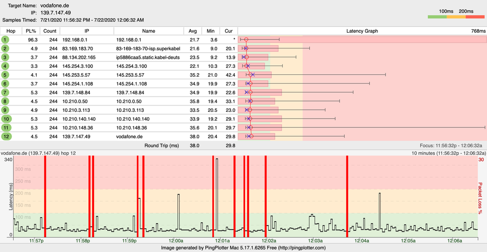

Hi again Wallace,
Sorry for the late reply here. I was not really having timeout problems in this time period until yesterday.
I did not experience "severe" timeouts as I had experienced and reported in the past. Only tiny "light" ones which have been more frequent since yesterday.
Here is the report: https://share.pingplotter.com/YJm9xEA5yaz
Here is the downloadable data: https://share.pingplotter.com/GpsSAnuRmER.pp2
What I don't really understand in the report is the packet loss ratio of 96.3% for the 192.168.0.1 hop (router). I can for sure confirm that the pings to the router where constantly successful during these 10 minutes and I have only experienced light timeouts when pinging external IPs/Hosts.
GDJn1W7gK47
I'd really appreciate your help.
Thanks.
