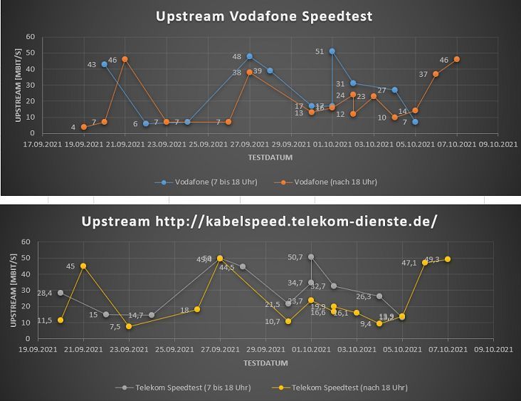

Beim Speedtest von Vodafone bekomm ich 28 MBit, beim Telekom Speedtest 23,6 MBit im Upstream.
Werde jetzt als nächstes den Speedtest der Bundesnetzagentur ausprobieren.

Vodafone Speedtest 13 MBit im Upload. Telekom Speedtest zeigt 10,2 MBit.

[  5]   1.00-2.00   sec  6.16 MBytes  51.6 Mbits/sec    1    188 KBytes
[  5]   2.00-3.00   sec  6.14 MBytes  51.5 Mbits/sec    0    211 KBytes
[  5]   3.00-4.00   sec  5.98 MBytes  50.3 Mbits/sec    0    231 KBytes
[  5]   4.00-5.00   sec  6.31 MBytes  52.9 Mbits/sec    0    251 KBytes
[  5]   5.00-6.00   sec  5.96 MBytes  50.0 Mbits/sec    1    209 KBytes
[  5]   6.00-7.01   sec  6.33 MBytes  52.8 Mbits/sec    0    234 KBytes
[  5]   7.01-8.00   sec  6.03 MBytes  50.8 Mbits/sec    1    184 KBytes
[  5]   8.00-9.00   sec  6.01 MBytes  50.4 Mbits/sec    0    208 KBytes
[  5]   9.00-10.00  sec  6.22 MBytes  52.2 Mbits/sec    0    229 KBytes
[ ID] Interval           Transfer     Bitrate         Retr
[  5]   0.00-10.00  sec  60.9 MBytes  51.1 Mbits/sec    4             sender
[  5]   0.00-10.03  sec  60.6 MBytes  50.6 Mbits/sec                  receiver
iperf Done.
[1]+  Done                       date
root@Wrt-Diagnostics:~# date & iperf3 -c speedtest.wtnet.de -p 5202
Sat Oct 16 14:54:33 CEST 2021
Connecting to host speedtest.wtnet.de, port 5202
[  5] local 2a02:8070:87e1:1900:214:d1ff:fe9c:9881 port 41202 connected to 2a02:2028:ff00::f9:2 port 5202
[ ID] Interval           Transfer     Bitrate         Retr  Cwnd
[  5]   0.00-1.00   sec  5.34 MBytes  44.8 Mbits/sec    1    198 KBytes
[  5]   1.00-2.00   sec  6.20 MBytes  51.9 Mbits/sec    0    236 KBytes
[  5]   2.00-3.00   sec  6.02 MBytes  50.7 Mbits/sec    0    259 KBytes
[  5]   3.00-4.00   sec  6.04 MBytes  50.6 Mbits/sec    1    201 KBytes
[  5]   4.00-5.00   sec  6.18 MBytes  51.9 Mbits/sec    1    153 KBytes
[  5]   5.00-6.00   sec  6.25 MBytes  52.4 Mbits/sec    0    180 KBytes
[  5]   6.00-7.00   sec  6.07 MBytes  50.9 Mbits/sec    0    205 KBytes
[  5]   7.00-8.00   sec  6.23 MBytes  52.3 Mbits/sec    0    226 KBytes
[  5]   8.00-9.00   sec  5.96 MBytes  50.0 Mbits/sec    0    245 KBytes
[  5]   9.00-10.00  sec  6.22 MBytes  52.2 Mbits/sec    1    201 KBytes
[  5]   0.00-10.00  sec  60.5 MBytes  50.8 Mbits/sec    4             sender
[  5]   0.00-10.02  sec  60.2 MBytes  50.4 Mbits/sec                  receiver
iperf Done.
[1]+  Done                       date
Sat Oct 16 14:55:06 CEST 2021
[  5] local 2a02:8070:87e1:1900:214:d1ff:fe9c:9881 port 41206 connected to 2a02:2028:ff00::f9:2 port 5202
[  5]   0.00-1.00   sec  3.08 MBytes  25.8 Mbits/sec   20   60.0 KBytes
[  5]   1.00-2.00   sec  1.65 MBytes  13.9 Mbits/sec   16   20.9 KBytes
[  5]   2.00-3.00   sec   941 KBytes  7.71 Mbits/sec    2   36.3 KBytes
[  5]   3.00-4.00   sec  1.29 MBytes  10.8 Mbits/sec    2   50.2 KBytes
[  5]   4.00-5.00   sec  1.35 MBytes  11.3 Mbits/sec    9   26.5 KBytes
[  5]   5.00-6.00   sec   941 KBytes  7.71 Mbits/sec    1   34.9 KBytes
[  5]   6.00-7.00   sec  1.10 MBytes  9.26 Mbits/sec    5   30.7 KBytes
[  5]   7.00-8.00   sec  1.10 MBytes  9.25 Mbits/sec    5   29.3 KBytes
[  5]   8.00-9.00   sec  1.10 MBytes  9.25 Mbits/sec   12   26.5 KBytes
[  5]   9.00-10.00  sec  1.10 MBytes  9.25 Mbits/sec    4   40.4 KBytes
[  5]   0.00-10.00  sec  13.6 MBytes  11.4 Mbits/sec   76             sender
[  5]   0.00-10.05  sec  13.2 MBytes  11.0 Mbits/sec                  receiver
iperf Done.
[1]+  Done                       date
Sat Oct 16 14:55:21 CEST 2021
[  5] local 2a02:8070:87e1:1900:214:d1ff:fe9c:9881 port 41210 connected to 2a02:2028:ff00::f9:2 port 5202
[  5]   0.00-1.00   sec  1.66 MBytes  14.0 Mbits/sec   29   39.0 KBytes
[  5]   1.00-2.00   sec  1.29 MBytes  10.8 Mbits/sec   11   23.7 KBytes
[  5]   2.00-3.00   sec   941 KBytes  7.71 Mbits/sec   10   22.3 KBytes
[  5]   3.00-4.00   sec   941 KBytes  7.71 Mbits/sec    4   34.9 KBytes
[  5]   4.00-5.00   sec  1.10 MBytes  9.25 Mbits/sec    5   32.1 KBytes
[  5]   5.00-6.00   sec  1.65 MBytes  13.9 Mbits/sec    0   60.0 KBytes
[  5]   6.00-7.00   sec  1.16 MBytes  9.77 Mbits/sec   29   32.1 KBytes
[  5]   7.00-8.00   sec   941 KBytes  7.71 Mbits/sec   13   19.5 KBytes
[  5]   8.00-9.00   sec   941 KBytes  7.71 Mbits/sec    7   20.9 KBytes
[  5]   9.00-10.00  sec   941 KBytes  7.71 Mbits/sec    9   15.3 KBytes
[  5]   0.00-10.00  sec  11.5 MBytes  9.62 Mbits/sec  117             sender
[  5]   0.00-10.02  sec  11.1 MBytes  9.32 Mbits/sec                  receiver
Kann es sein, dass in meinem Segement ein Störer aktiv ist?
....eher nicht. Ich teile die gleichen Erfahrung du mit dem iperf3 Test auch gewonnen hast.
Ob eine AVM Docsis 3.1 SchwitzBox oder die Pastikbomber von VF, das Upload Problem wird dadurch nicht gelöst.
Viele die mit einem CASA CMTS mit aufgeschalteten OFDMA angebunden sind haben diesen Problem. CMTS check hier.
Tante Erna und Onkel Hubert die nur ein wenig surfen bemerken keinen Unterschied.
Das Ziel der Umstellung auf den OFDMA Kanlal ist es 100MBits im Download zu erreichen. VF rudert aber wieder zurück, hier und hier (ohne Gewähr) weil es nicht geht.
Wir - die VF Kunden - können nur mutmaßen und die Mods halten sich sehr bedeckt.
Also stochere ich mal im Nebel:
Schaue dir das mal an, besonders der Abschnitt tdma. Und jetzt stelle dir vor das der SNR/MER im Up - den der Kunde nicht sieht - nicht besonders gut ist oder zuviele Modems im Segment (@200MBits im Segment???) hängen und die komplexe Fehlerkorrekur nicht zeitgerecht den vom CMTS zugewiesenenTimeslot trifft.
Dann kommt es sicherlich zu den festgestellten Effekten - tcp retries, Verkeinerung des cwnd, weniger speed das CMTS kurz vor dem overload.
Aber nix genaues weiß man nicht.
Der 3rd Level schiebt nun Überstunden, weil dieser mit "Hochdruck" das Problem der Marketingstrategen lösen muß.
Diesbezüglich sind hunderte von Störungsmeldungen zum Thema Upload sicherlich keine "fake news".
Wir als Kunde können gar nichts machen
