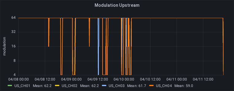

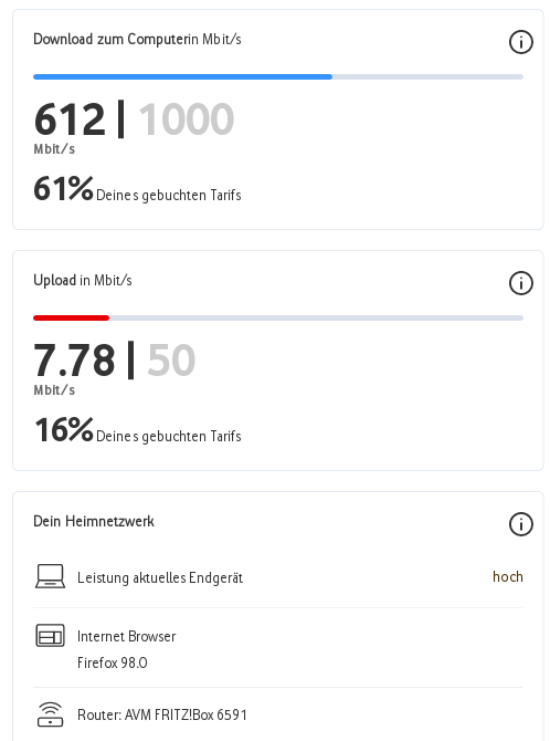

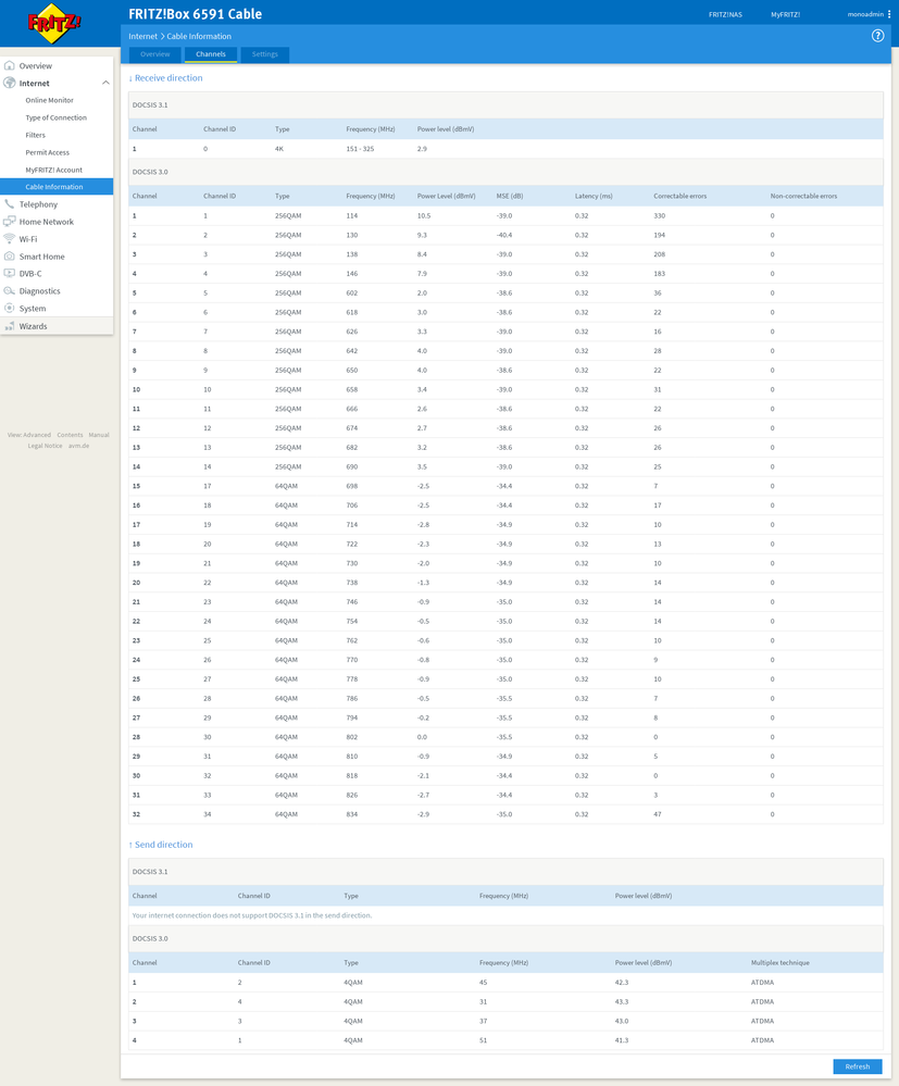

monofox
heute gab es wieder ein Disconnect, ein Neustart war aber nicht erforderlich.
     - 2022-04-08 02:27:49 85 times
   25: 2022-04-08 02:27:53 67070100 error     DBC-ACK not received
   26: 2022-04-08 02:28:49 82000400 critical  Received Response to Broadcast Maintenance Request, But no Unicast Maintenance opportunities received - T4 time out
     - 2022-04-08 02:28:49 4 times
   27: 2022-04-08 02:29:06 82000200 critical  No Ranging Response received - T3 time-out
     - 2022-04-08 02:29:26 6 times
   28: 2022-04-08 02:29:28 90000000 warning   MIMO Event MIMO: Stored MIMO=-1 post cfg file MIMO=-1
   29: 2022-04-08 02:29:30 73050400 warning   REG-RSP-MP Mismatch Between Calculated Value for P1.6hi Compared to CCAP Provided Value
   30: 2022-04-08 02:29:30 82001200 warning   RNG-RSP CCAP Commanded Power in Excess of 6 dB Below the Value Corresponding to the Top of the DRW
     - 2022-04-08 02:29:30 3 times
   31: 2022-04-08 02:29:31 82000200 critical  No Ranging Response received - T3 time-out
     - 2022-04-08 02:29:57 13 times
   32: 2022-04-08 02:29:57 82001200 warning   RNG-RSP CCAP Commanded Power in Excess of 6 dB Below the Value Corresponding to the Top of the DRW
   33: 2022-04-08 02:29:57 82000200 critical  No Ranging Response received - T3 time-out
   34: 2022-04-08 02:29:58 82001200 warning   RNG-RSP CCAP Commanded Power in Excess of 6 dB Below the Value Corresponding to the Top of the DRW
   35: 2022-04-08 02:30:29 85010300 warning   Initializing Channel Timeout Expires - Time the CM can perform initial ranging on all upstream channels in the TCS has expired
   36: 2022-04-08 02:30:29 85010200 warning   TCS Partial Service
   37: 2022-04-08 02:30:59 67050300 warning   DBC-REQ Mismatch Between Calculated Value for P1.6hi Compared to CCAP Provided Value
     - 2022-04-08 02:41:00 2 times
   38: 2022-04-08 02:41:00 82001200 warning   RNG-RSP CCAP Commanded Power in Excess of 6 dB Below the Value Corresponding to the Top of the DRW
   39: 2022-04-08 08:13:32 82000200 critical  No Ranging Response received - T3 time-out

Dafür ändert sich die Leistung stellenweise aktuell erheblich:
Screenshot 2022-04-11 at 21-24-53 Speedtest Plus für Kabel- und DSL-Verbindungen Vodafone.png
Die Upstream-Modulation ist im "Keller":
Das hat sich seit dem 08.04. verstetigt:
Am letzten WE war Ruhe.
Zum Vergleich die Gesamtkurve seit 28.03. (blaue Linie ist der Zeitpunkt des FritzBox Tauschs):
Die Paketverluste sind entsprechend (~ 14 - 20 %).
Ich nehme an, das hat aber nichts mit der FritzBox zu tun, oder? In den Zeiten der Kurve, wo alle auf 64QAM stehen, habe ich keinerlei Einschränkungen.
In den Logs taucht nur auf:
     - 2022-04-11 00:13:47 190 times
   40: 2022-04-11 09:38:51 74010100 notice    CM-STATUS message sent.  Event Type Code: 24
     - 2022-04-11 09:43:08 4 times
   41: 2022-04-11 15:58:19 82000200 critical  No Ranging Response received - T3 time-out
     - 2022-04-11 21:17:31 15 times
